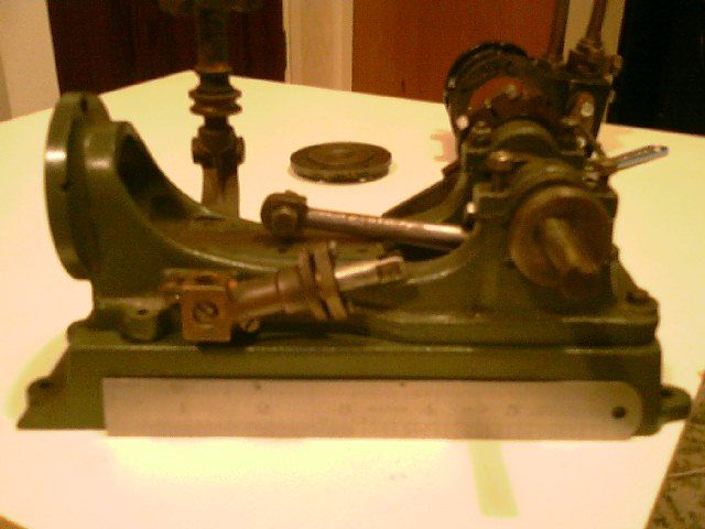

              Ian S C
                @iansc
                The one I did the rebuild on also had a feed pump. This is a view of the feed pump as I received it. Ian S C
                snapshot_20121005_4.jpg This is a view

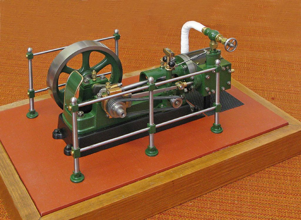

                Maurice Cox 1
                  @mauricecox1
                  Hi Ian, it looks as though you had a fair bit of work to do on that. I thought you might like to see a Stuart No.8 that I fitted a governor to. The railings do obstruct the view of the governor a bit, but it gives you an idea of it. I started with a small pair of bevel gears, and went from there.
                  MauriceStuart No8 With modifications.
