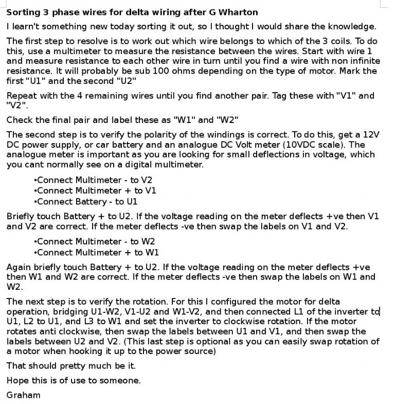

                      I have been curious about digging out the wires at times. Did you differentiate the start finish of each winding ?
                      I've seen "demo's" where some one just identifies the coils with an ohm meter and then just connects them up as desired. I would have thought that the winding sense would have to be found as well but am not too sure. Or if that is the case which way they should be connected.

                        It doesn't matter which way round you connect the phases, as long as you connect them phase-to-phase ie each winding between a pair of phase connections (g L1 and L2 etc) – and no two windings in parallel with each other! If you get the machine rotating in the wrong direction, you can simply swap any 2 of the phase (live) wires around or any one of the windings.

                            Muzzer, I thought it didn't matter, but it does! This is because the windings are mutually coupled, so you have to get them in the right sense other wise the motor won't run properly. Once the windings are connected in the right sense, you can swap round the connections to the 3 phases to reverse the motor. This is mentioned on a thread on here somewhere.

                              I have seen one idea in a foreign language video. I think he use a bell battery directly to kick some current into a winding and looked for a kick in the volts on another winding – but then comes polarity and which way they should be connected. I'd gues + to – in this sense but not sure.

                                The start and finish of the winding must be correct but the phase order does not matter as it will just run the wrong way so just swap them to get the desired rotation. If you get a winding the wrong way round the motor will not sound at all happy.

                                    I looked around on identifying wires on 3 phase motors and all seem to indicate sense doesn't matter. Odd I thought so just looking around on motor details I think this shows why it does
                                    surprise I suppose if they are just connected willy nilly 2 must be the same so only one can be wrong.
                                    crying Now I will have to look at the link again and see if delta is wired as I thought +ve to -ve as far as the excitation and kick in the volts is concerned. I could only find a video from India that indicated this way of doing it. No English other than a few tech terms and zilch on the web.
                                    #251051
                                    Ajohnw
                                      @ajohnw51620
                                      As some might want a copy of the details handy I have stuck a jpg in my woffle album
