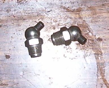

              Does anybody know what type of oil gun would be suitable for these nipples ?
              I have a quantity of these , the thread maybe 1/8 GAS but not sure . unknown.jpg

                One of the ordinary pump oil gun nozzles should jam in and work. Thread looks tapered so possibly 1/8" BSPT or NPT depending on the thread, 55 degree 28 TPI for BSP, , 60 degree 27 TPI for NPT

                    Yes the thread is likely to be BSPT
                    As for making an oil gun, I purchased a grease gun and modified it as described here , this is ideal for the common ZERK nipples
                    http://www.metalwebnews.com/howto/oilgun/gunconvert.html
