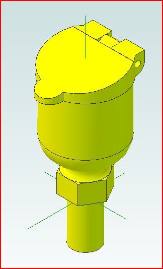

        Has anyone got a good design for making flip-top oil cups that doesn't involve folding up sheet metal. A sprung lid is desirable, but not essential.
        All the ideas I have are too clunky for a 9mm diameter cup.

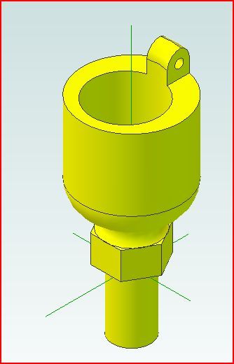

                        #172916
                          Try this Neil
                          Turn a basic cup shape 9mm OD, use a 1/4" ball nose cutter to form the recess but make it off centre, mill away some of the top to leave the centre of a hinge nuckle on the thickest edge.
                          Take a bit of brass the thickness of what you machined of the top (2.4mm in this case) drill right through 0.8mm for the hinge pin, notch to fit the cup, then shape the top as desired
                          Make a pin 0.8mm dia squash one end slightly then push it into place so that when the squashed end enters last it will hold tight in one of the outer nuckles
                          Thats your homework for tonight, will expect it ready to be marked in the morningwink 2
                          Edited By JasonB on 18/12/2014 16:07:47

                            #172921
                              You can always poke a bit of natural wool into the hole if the oil is draining too fast. I drew it with a 1/16" hole but 1.2mm or even 1.0mm would do

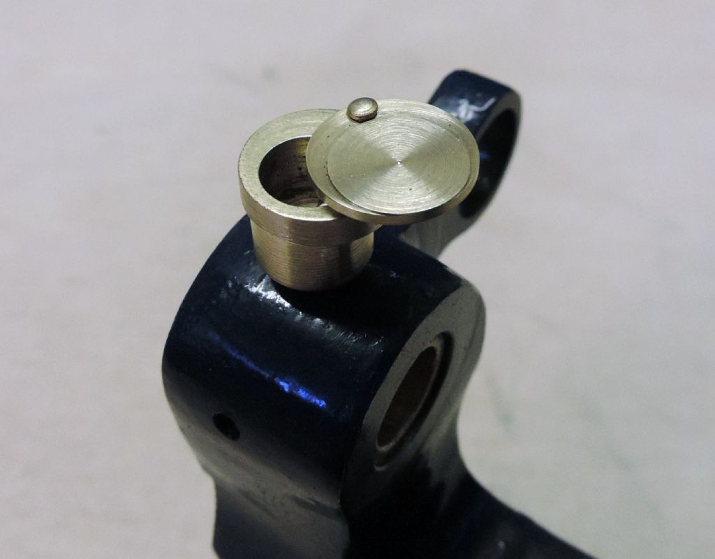

                              #172967
                                I figured my milling/filing wasn't up to making a neat enough hinge, so I made some 50-thou shank brass rivets (my 1/32" copper ones were too small!) and went for a swing top. the bottom of the lid has a round register that sits in the cup and the rivet was peened with an aluminium spacer so the lid can lift a little for opening. Just need to rivet the second one to finish.
                                The back gear spindle and pulley cluster both ave simple oil holes, sealed by 4BA grub screws, but they are made with an internal reservoir between the bushes.
