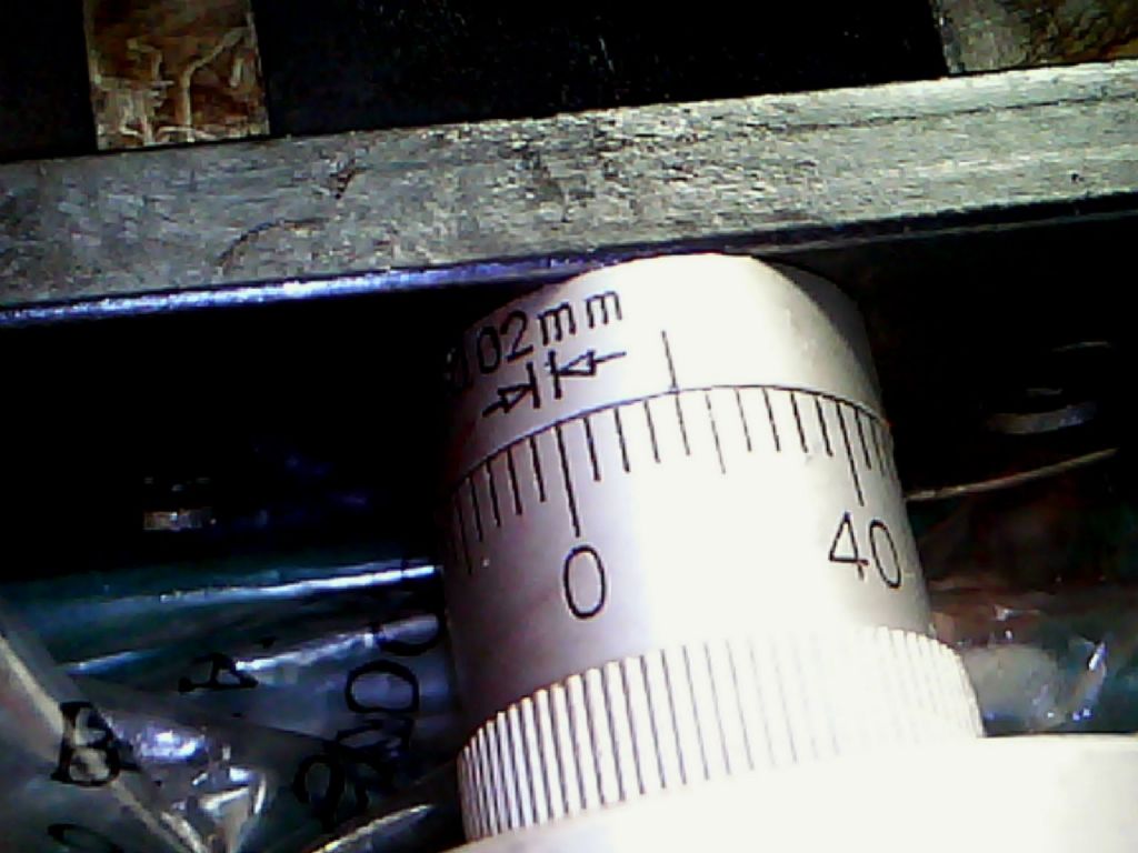

      I purchased a small X-Y co-ordinate table some years ago, but only recently decided to commission it on a micro-mill. The scales are metric with 1mm pitch lead screws. Each scale bears the legend >| |< 0.02mm and is divided into 5 sections numbered 0,10,20,30, and 40, each with 10 divisions. One complete revolution of the dial translates into a 1mm movement so, although each dial effectively says 0.50mm, it actually represents 1mm movement. In the photo, the dial is actually set at 0.92 rather than 0.46.
      How confusing is that?

          Yes it would be better if the stamped numbers were 0, 20, 40, 60 & 80.
          My X3s Z axis has similar but in imperial, each division is 0.0005" and its numbered 0-90 whereas one turn only gives 0.050"

            Probably shared components off a lathe where it would then be direct reading.
            Think yourself lucky you have something that works in whole numbers.

                I think I'm confused by your confusion Gary. Seems to me there are 50 small divisions per rev, each 0.02 mm.
                50 x 0.02 = 1mm
                The dial numbers are simply divisions …. they aren't telling you 0 to 0.50 mm but 0 to 50 divisions. I have a similar thing on my (Asian) mill except that mine has an inch-based leadscrew and I have 50 divisions each 0.002". I never found it particularly confusing. Awkward, yes.
                I guess, on your mill, they could have calibrated the large divisions as 0.2 / 0.4 / 0.6 / 0.8 / 1.0 mm instead of 0 – 50 which would have made it slightly easier to use. Ideally they could have divided the dial into 100 small divisions which would make things much easier – but be harder to see. Or they could have used a 0.5mm pitch leadscrew with the existing dial and each small division would be 0.01 mm
                Get a DRO and it all becomes academic (along with allowing for backlash).

                  My mini lather uses 40 divisions on a 1mm pitch leadscrew. Each division is therefore 0.025mm and effectively 0.001". Much easier to use, for imperial, but not so easy for metric use.
                  The engraving style is exactly as Gary's dial, so probably they are both SEIG machines. I mostly work in imperial, but if I was regularly using metric I would greatly prefer his dials, even if you need to mentally multiply by two (or even by four if using them on the lathe cross slide!)
