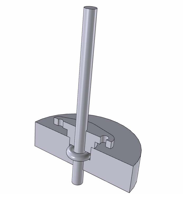

                          Historically on full size engines there were two common ways of making a gland. One has a hole tapped into the cover. The inside end of the hole is smaller to give a running fit on the rod. The gland fitting also has a hole to fit the rod.  Soft packing is pushed into the hole and the gland fitting is screwed down to compress it enough to give a seal, but not so hard as to grip the rod too tight.
                          The other way is much the same except instead of the hole being tapped, there are two or three studs arranged around the hole. The gland has a flange with matching holes, and there are nuts that pull the gland fitting down onto the packing. The down side with this type is that if you do not tighten the nuts evenly it will pull the fitting onto an angle, tending to jam the rod. They were possibly the most common in full size, partly because you really don’t want to have to put a two foot diameter cover onto a lathe and then screw cut the gland fitting.
                          Either can be adapted for  use with O rings, although it is possibly easier with the stud type since you can make it so that it actually has a shoulder and so will only go in so far leaving just the right shaped space for the O ring. In the smaller engines the studs need to be quite small, eg 7 or 8 BA, or M2 if you prefer. With teh stud type adapted for O rings, you don’t get the problem with it trying to angle, since it goes up against the shoulder and no further. This maybe calls for a sketch…

                            Ok, here is a picture of the type with the studs,although I have not actually shown the studs themselves.
                            That little space where the O ring sits should actually have a little clearance top and bottom. The bore in the cover is such as to give a little nip on the outside size…I don’t have the book to hand, but for a sliding seal it is not very much. As you will see, the little shoulder stops you clamping the gland follower down too far so you will get the right clearance.
                            regards

                              The design I have actually has the bore in the cover projecting from the cover so this version is out this time round as the gland would have nothing to screw into!
                              OK as I understand it from these posts you don’t actually squish the O ring down hard, just enough to make a seal. Which implies that the screw in version will be better as you can adjust it.

                                Well, so long as you do not adjust it too tight…there actually should be a little play up and down along the rod, which means the screw is not in particularly tight.
                                Yes, usually if the design is meant for the type with studs there will be a diamond shape cast in the cover to provide a place for them. That can be machined onto a cover made from bar stock, but it is a bit fiddly.
