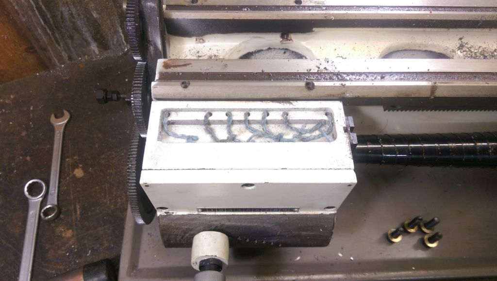

                  Take a look at this video of a guy in America who is checking the quality of his Grizzly lathe G0602 which is essentially the same 10×22 lathe sold under many names in the UK.
                  I think a lot of people have machines that are good enough to do what they want for them but in reality if you strip these Chinese machines down I think most would be suprised how far out they really are. There is no way to get the maximum out of a machine with these kind of tolerances. I think it would be a big ask to presume that if I ask Chester to replace the machine it will be much better made.
                  The test sheet which came with the machine gives correct data for runout etc.. (although I have not checked all of it) but obviously all that means nothing if mating surfaces are only contacting in a few places. Also there is no way Chester could have known about this fault as it took me a good few hours to diagnose it and then strip it down to see what was going on. I bought my milling machine from SPG Tools a couple of years ago and have been very happy with it, I seem to remember when ordering that they set them up themselves before sending them out which is good to know. I dont know with other dealers if they check the function of the machine before sending it out? An inspection record of a machine is handy to have but like I just said it doesnt cover quality of surfaces and build, only things like runout and parallelism.
                  China makes a ridiculous amount of stuff nowadays, we make nothing. We wont pay people to build quality things anymore it is easier for the big money men to farm it all out to China, India etc.. If you have a problem with your phone or bank and ring for help you get put through to India. What else is there to say? What I have learned in life is if you want something right then you have to do it yourself because the fact of the matter is when you buy something the company that made it got the job because they could do it cheaper than anyone else.That speaks volumes. I just find it ironic that a place like the UK which was at the forefront of the industrial revolution cant even produce equipment like it used to and it has instead opted to let others build what we would class as sub standard products for us to buy.
                  I am going to let Chester know about the machine but am not going to build it back up because I really believe if they send me another the surface tolerances are not going to be what I want them to be (everywhere). If they want to send me a new Head stock casting to replace the rubbish one that would be appreciated. Whats interesting is my old lathe which I bought new a few years ago, a clarke CL500m has been a solid reliable machine but lacked a lot of features. That machine is also sold under many names across the globe. I wondered why they had never changed the model for something newer and I guess it must be because for what they are they are half decent machines. Obviously they are made in china too but their manufacturer must be someone they can trust to supply a reliable quality of product. I mean some of these factories over there must not even have a quality control department. If you or I worked in a factory and were given that head stock I am sure we would take it back to parts or wherever we had got it from and asked them for another. But I think over there it is a production line system where a bunch of zombies are paid simply to tighten nuts.
                  On a lighter note you do get a free knitting machine with this model lathe, it has nine patterns to choose from. When I get it fixed I will sort a beanie hat for the long hours of lapping and scraping ahead of me.

                          Here`s a video I made just to give another visual on the problem. I can get a 0.05mm feeler gauge and in places a 0.08mm between the bed and head stock in too many places.
                          https://youtu.be/uPgcLETS4C0

                              I have just emailed Chester with pictures of Head stock and video link of chatter and fact feeler gauge can be put in between mating surfaces. Just wait and see what they say? I would be happy if the sent me another Head Stock, but would that fit?

                                Going by the contact shown by the bluing ,i get the feeling the scraper marks on the saddle that are already present are simply for decoration.

                                                  I got a reply saying
                                                  "Although there may be an issue as you have stripped down a brand new machine whilst still under warranty and without consent, in this case it has quite clearly highlighted the issue that you have with the machine."
                                                  They will send someone to pick it up when I have it back together and on pallet (which i still have). They have also offered me another replacement machine or a full refund. I said I will think things over and let them know. So I can only say that they have been very fair and am happy and relieved at the outcome. They also said that when they get to look at the machine they will get on to the factory about it. So all good news.
