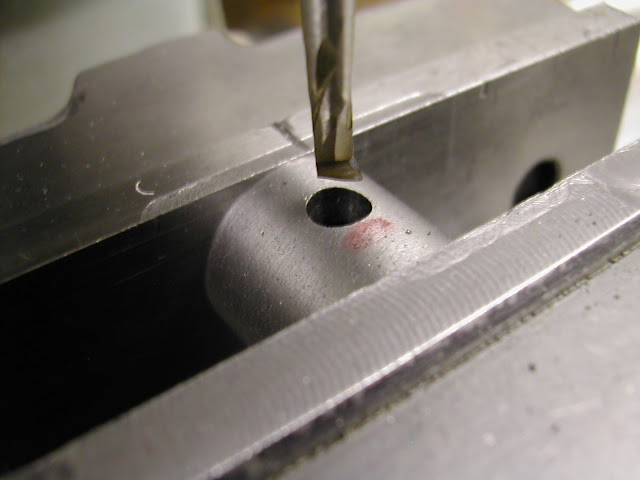

Ramon, The engine is a David Anderson Satilite 1cc. After much thought and dilema I did not do as you suggested,and that was to bore out the cylinder first, then do the transfer ports after, cause as the transfer ports are on the inside wall of the cylinder, and the 2.5mm carbide end mill is too short to mill down to 10.28mm, So I brought 2 carbide drills, then drilled down to 10.5mm, followed with the other drill which I had sharpened on the T&C grinder as an end mill. there are two port opposite each other, 2.5mm diameter spaced 1.7mm apart, Then drilled out the cylinder 10.5mm, tried to bore out the hole, but as the only boring tool that would fit was a carbide tipped 3/8″ tool, It seemed to hit hard spots, and was waisting the bore, THINKS???,. found some concrete reinforcing bar, (reo bar) 1/2″ diameter, now reo is tough, and comes in various sizes (the ones with formed spirals and straights) its also cheap ie, free of building sites. DONT!!!! put it straight in the lathe and try to cut off the lumps with an indexable or carbide tipped tool, they shatter, which is not good for unprotected eyes, just use a heavy duty bench grinder or large hand grinder, to get it reasonably smooth, I did that and reduced it to 10mm, plus a further reduction to 9mm for about 50mm long, drill and tapped the end 5mm cap head screw and cross drilled to take a piece of 1/8″ round, formed a knife edge tool shape, with the T&C grinder, Did it work YES!!! I started to bore it out, but only just taking out the waisted section, to start with, followed by finer cuts to get it all smooth, Just to see if it would work, I milled off a section off the other end, down to just above center hight, marked that out to take a very small diamond/trapesium shaped indexable bit, and screwed it down with a 3mm round head bolt.( the hole is 2.95 diameter) so be careful when drilling, The negative angle on my other indexable boring bars varies 5-10 degrees, But the tool bit bit is parrellel to the long axis next time I will leave the end 12mm so that there is a bigger landing for the bit, then take off the rear to give clearance.

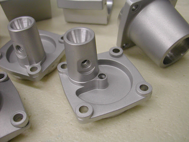

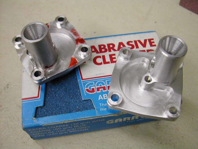

This is how they looked after. As said before I do have acess to a good friends blasting cabinet but this is proving such a good way to finish I’m intent on setting something up myself in coming months.
Though it won’t be until final assembly I can be absolutely certain, the piston/liner fits at this stage appear to be much better than the Racers but I’m not counting chickens yet.

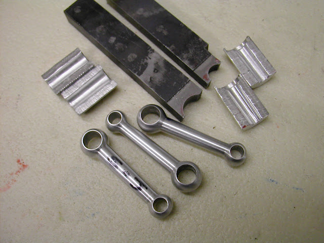

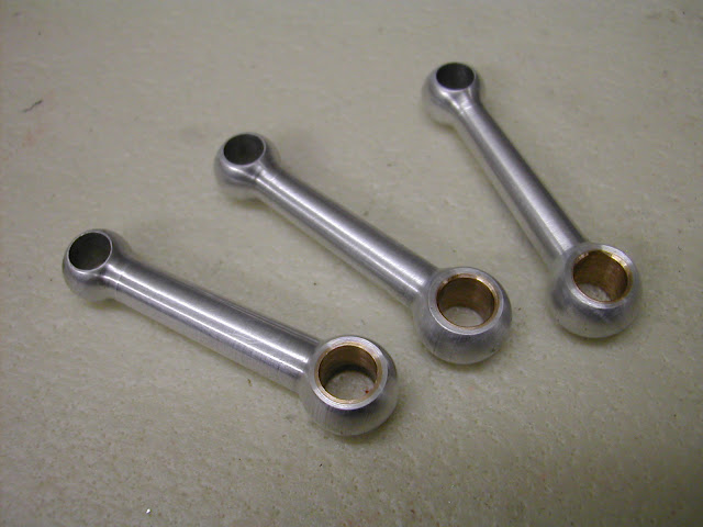

An idea I saw for making conrods was to go down to your local bicycle repair shop and get some worn out/broken pedals, the good ones are forged aluminium alloy, I have no idea what they are made of ????, but they are tough, being forged, apparently the metal molecules are aligned length wise, which is good for conrods, and make a good bearing surfaces, the best thing is, they are generally free, you find lots of goodies in the scrap bin.

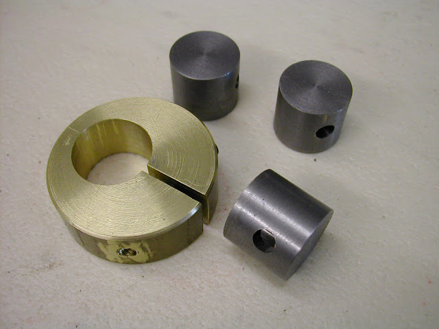

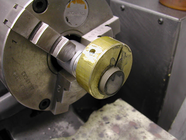

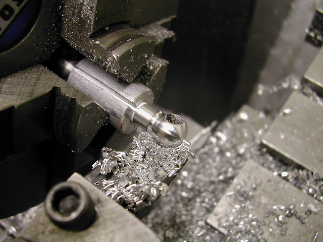

The head is silver soldered to the shaft, drilled and tapped on the centreline of where the copper will fit and one half removed.
Edited By Ramon Wilson on 07/06/2011 22:45:15

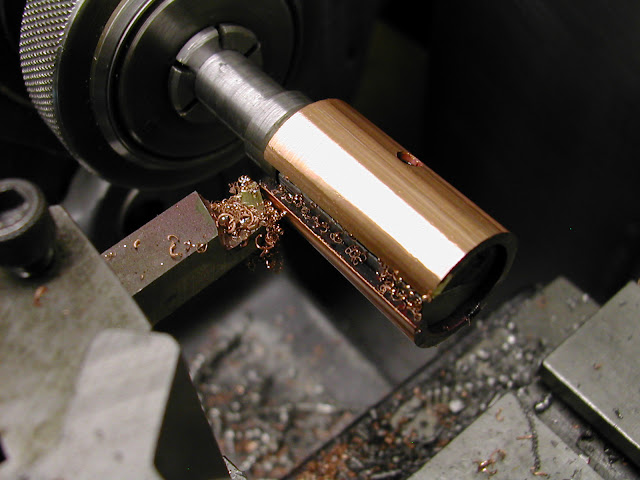

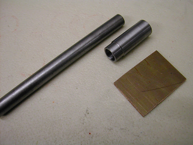

With your lap you say ‘turn to fit the bore’ – how closely? Also, presumably, you don’t expand the lap as you work down the grit sizes.
Finally, how ever did you turn a flat piece of 10 swg copper into such a beautiful cylinder?

Ramon Hi. Thats a great idea for an internal hone/lap, I sometimes start to lap with valve grinding paste, just to get the lathe tool marks out, (over exuberance and no patience) I have got 12 tubes of diamond paste, they cost about A$9, so they are much cheaper now than years ago, then finish with Brasso. The internal hone that I tried with SS rod and a fine stone, I should have said that the length of the actual stone is about 35mm long, that way there is less chance of distortion, as it wears more evenly, I have got two slate oil stones which are at least a 100 years old, so I aint cutting those up, so I might get a slate tile and see how that goes. over in the UK just wait for a wind storm you should have plenty???? I think in a previous post. that I do what Dave Owens does and use a thread die holder, to hold a slotted and grooved piece of round Aluminium, that makes it adjustable. Anyway a Gindall or a Delapina is a better option, especialy the one by Tom Blough..
