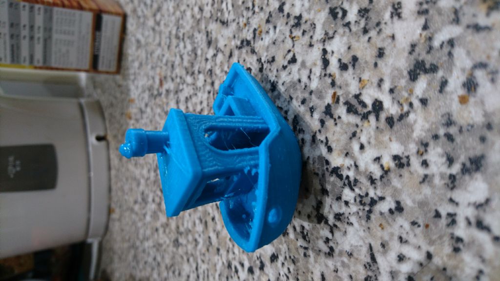

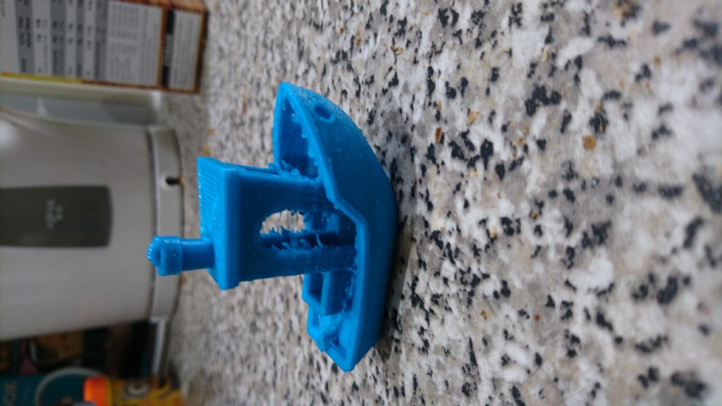

      My new (to me) Wanhao 5S arrived a few days ago, just got the chance to use it last night.
      Didn't think it was too bad for right out the box on the coarse setting.
      There are quite a few stringy bits poking horizontally where the extruder has had to go between different parts of the print over a gap. Is this a thing I just have to deal with or is there a way to tune it out? It won't be much effort to debur with a scalpel I think but was wanted to check if its an issue in the printer.
      Edited By Neil Wyatt on 17/10/2017 17:39:32
      #31546
      Rainbows
        @rainbows
        #321984
          You need to increase retraction.
          What slicing program does it come with?
          Edited By Neil Wyatt on 17/10/2017 17:39:53
          #321999
          Rainbows
            @rainbows
            Using Wanhao Maker, the documentation is uhh pretty scarce. Will have to have a click about to find retraction.
