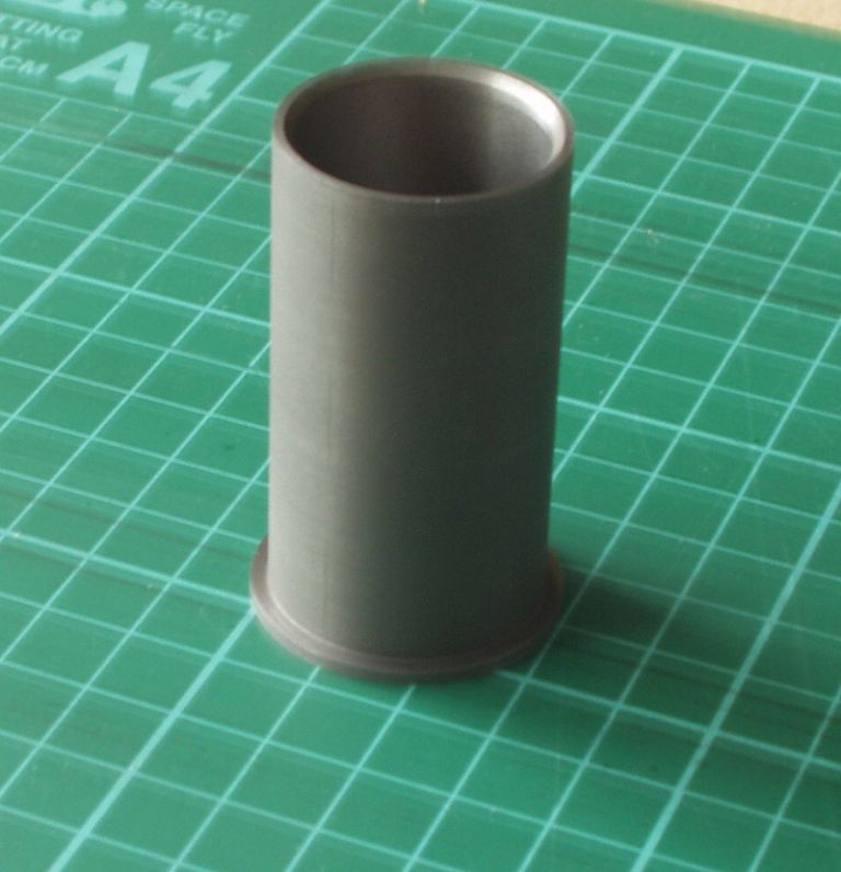

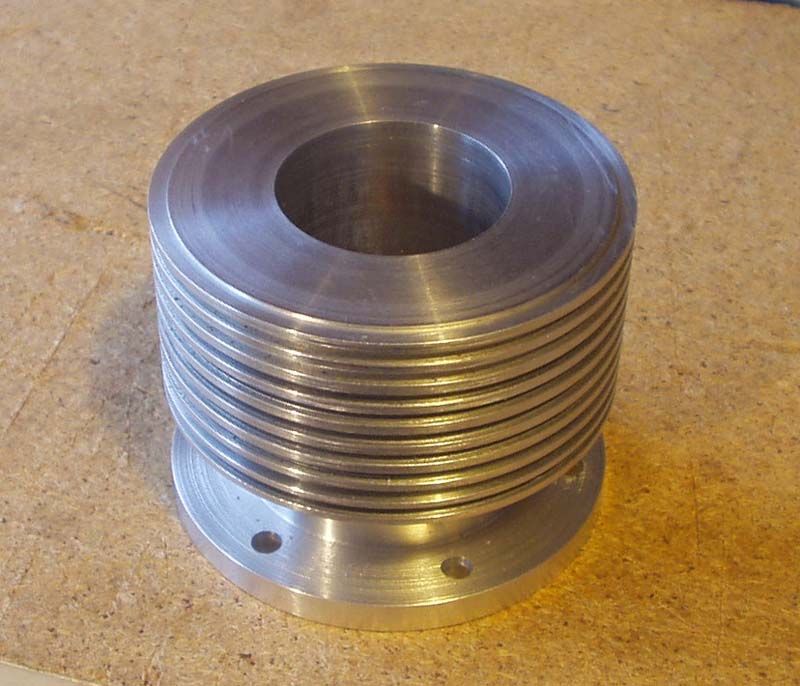

        HI

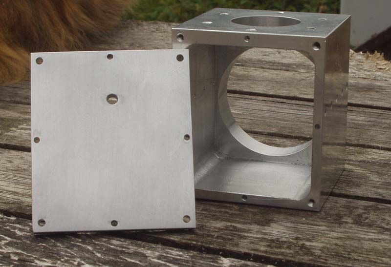

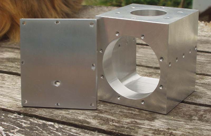

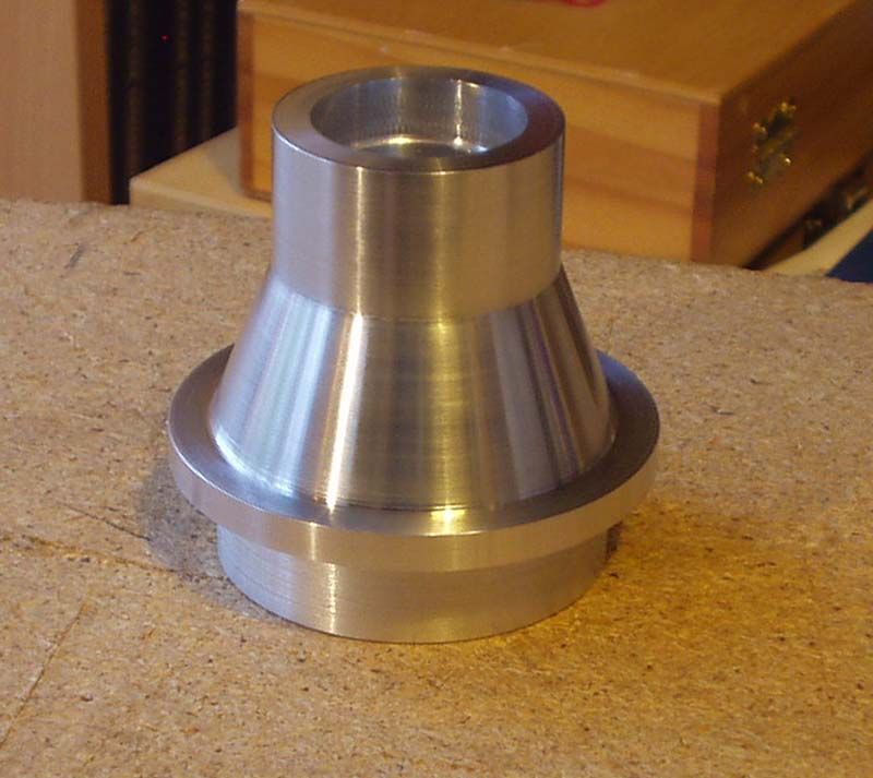

        I decided a while ago to try and build this engine.
        heres a few pics of where I’m up to so far.
        crankcase nose
        cylinder jacket
        a start on the head
        liner
        crankshaft
        crankcase
        part assembled
        thats made a start with most of the big plain machining bits, now for the small fiddley bits.
        thanks for looking.
        Roy

          Looking great so far Roy, nice job!

            Very nice Roy – are you “going for glo or all the way to electronic ignition?

              It’s going to be glowplug, I cant be having with all these electronical thingies.
              Lets face it, It’ll only run the once ( if it runs at all that is ) then it’ll go on a nice stand .
              I’m only making it to see if I can.
              Roy

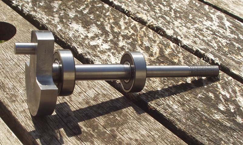

                Hi. nice work, Is the crank shaft one piece, or fabricated in sections. Show us a photo when its running. Im’e making a DA 1cc engine, only have to make the carby, also just have to finish making the furnace to cast the crankcases, then its finished.

                    the crankshaft is three parts, the web is pressed onto the shaft with the help of some shaftlock and 3 screws tapped into the end on the join line.
                    then the pin is pressed in, also with shaftlock, although the amount of force it needed to get it in I doubt it’ll ever move.
                    Roy

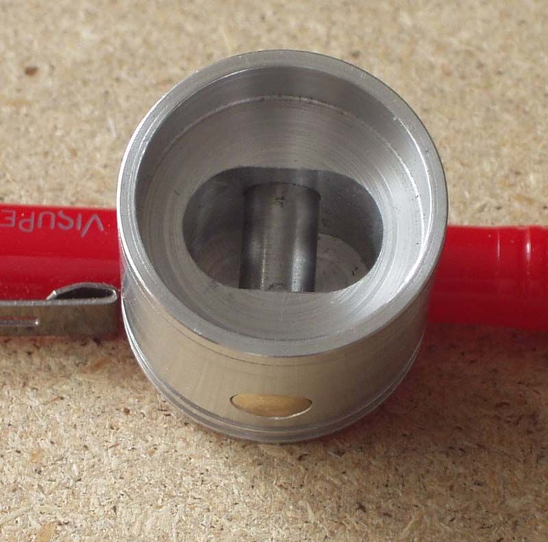

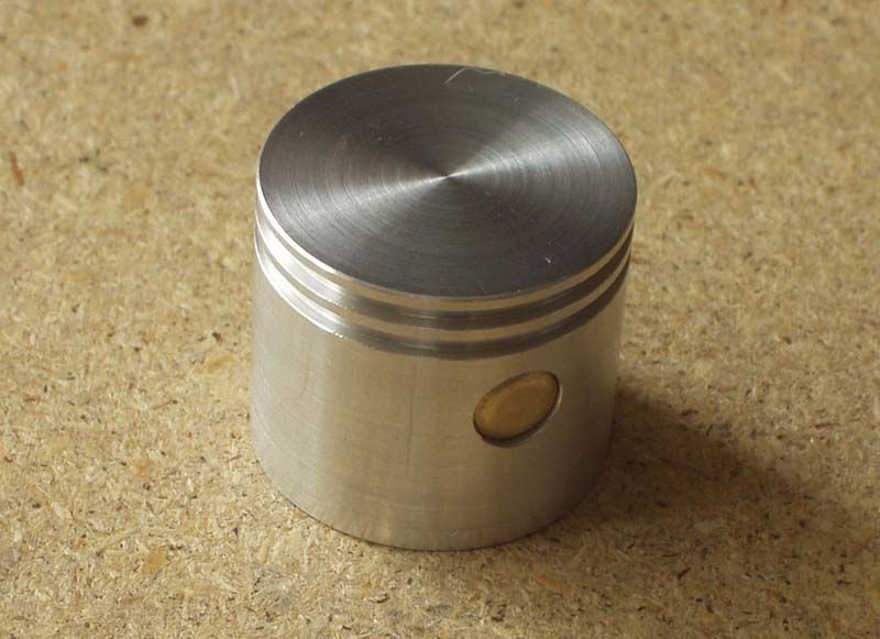

                              #73912
                              wheeltapper
                                @wheeltapper

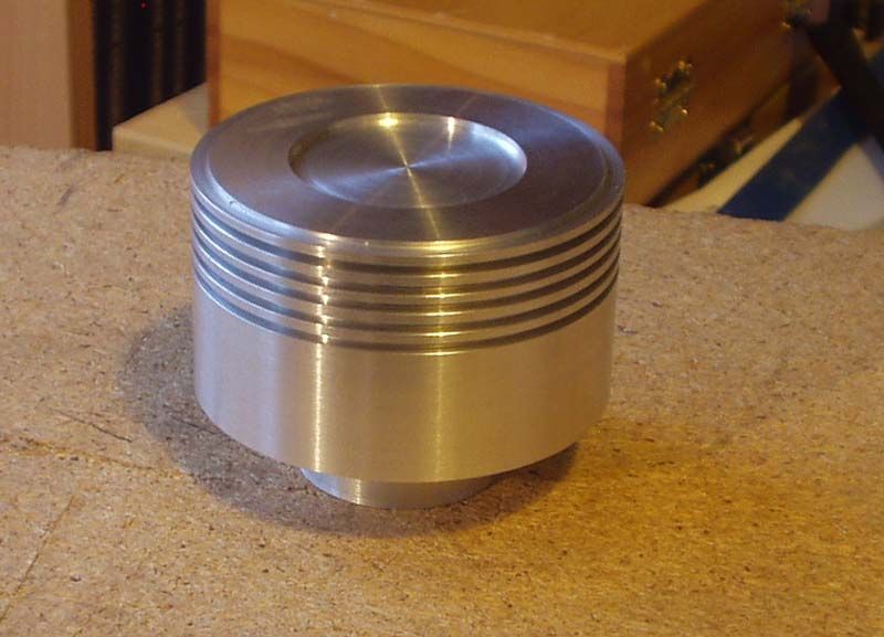

                                HI
                                If I could have my post back for a moment
                                I’ve finished the piston.
                                piston rings next, cast iron, yucky job .
                                Roy

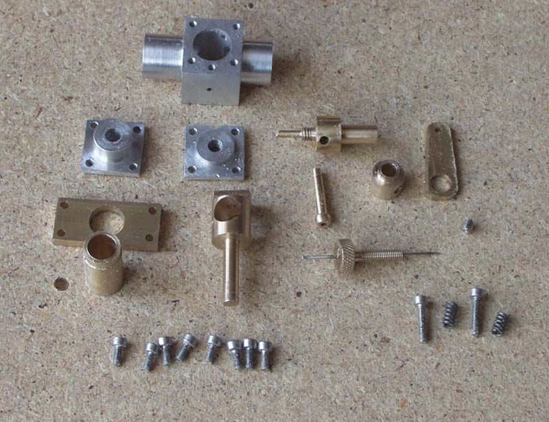

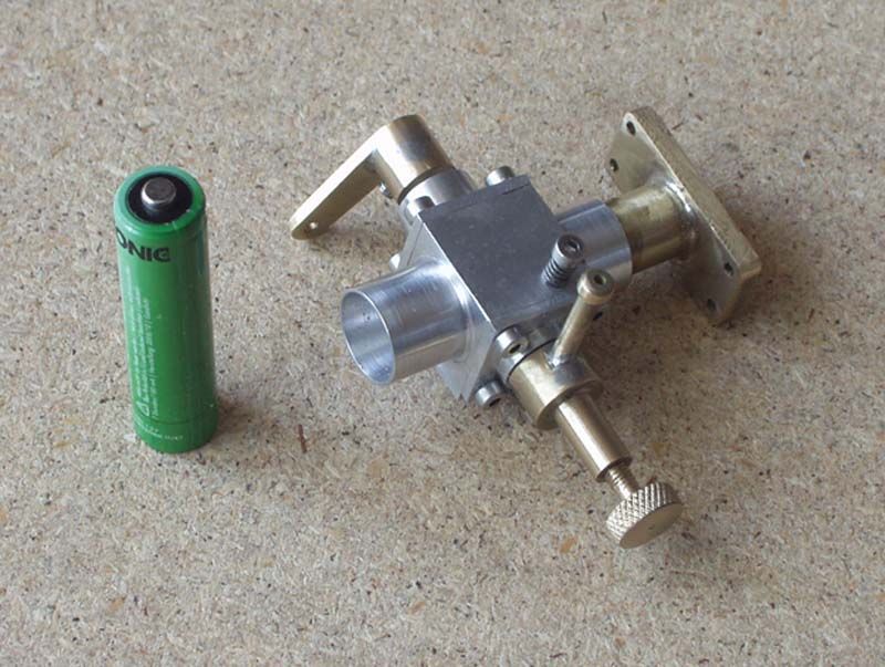

                                        #74210
                                        wheeltapper
                                          @wheeltapper

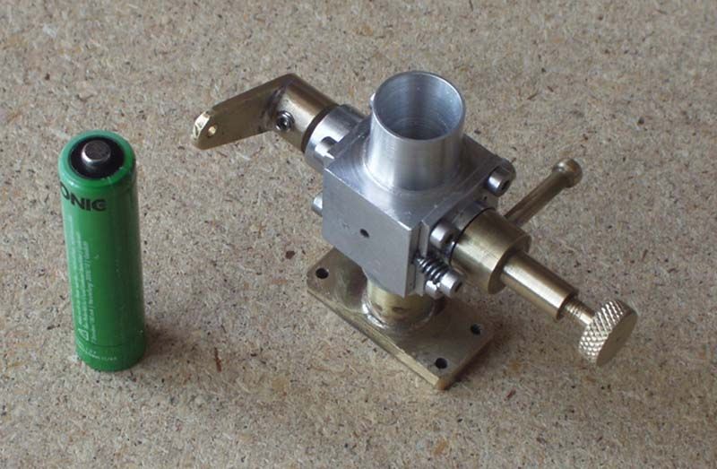

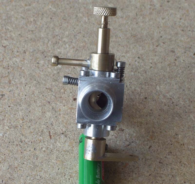

                                          HI
                                          more progress.
                                          from these,
                                          to this,
                                          the cell is AA for comparison.
                                          cheers
                                          Roy

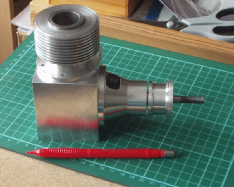

                                                I’m impressed at the rate you are getting on with the build! Took me about 18 months to build the Nemett!
                                                You’ve also got a nice smooth taper on the front crankcase half – mine has a sartorial corduroy finish, as I didn’t have the gibs adjusted quite right! It’s very uniform, so I could claim it was deliberate!
                                                Do post the video of it running, it’s a great noise –

                                                  the job that worries me is the head, so many things to go wrong. and the cams, and the………………well you get the picture.
                                                  I had trouble turning tapers on my lathe because no matter what I did as I turned the topslide handwheel (only one handle) the top wobbled as the handle went round and the cutter went in, out, in, out and I got a scalloped effect.
                                                  now what I do is turn the handwheel by the centre nut with a box spanner,no more wobble.
                                                  Roy

                                                    I was alway tought that you shoul use both hands on the wheel and not the handle, this allows a constant feed and stops that tendancy to lift the slide as the handle comes up.
                                                    If its a long taper one of the electric screwdrivers works well on the nut, not a cordless, they are too fast.

                                                      I must admit the head was the one component that had me worried. In the end the only thing I screwed up was milling the locating square on the top, everything else was just a load of patience and keep re-reading Nemett’s article on the build. One thing to watch is avoiding clamping marks on the head, I’m a bugger for not taking care in that department!
                                                      The Cams didn’t turn out too difficult, but I did have a DRO on the mill Z-feed by then, it would have been impossible on my Warco mill as the mechanical readout is hopeless for close tolerance stuff. In the article Nemett uses loctite to fix the cams, I was a bit doubtful but they have held tight no problem.
                                                      The scalloped effect you described sounds just like the issue I had, but adjusting the top slide gibs fixed it for me.
