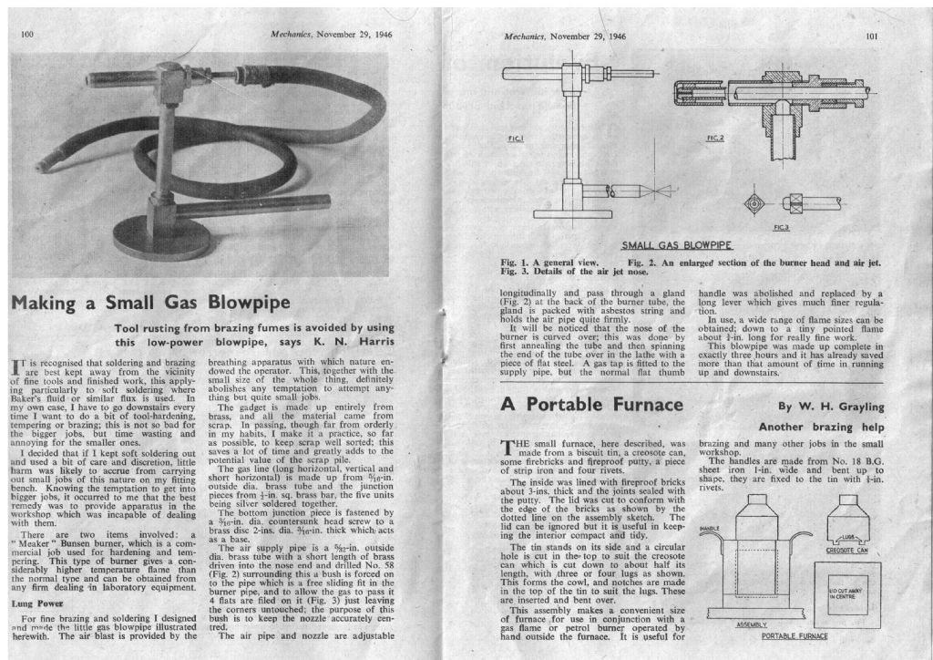

                                I found an ancient (1946) copy of 'Mechanics' today. There's a design for a town gas blowtorch in it. This may work on propane/butane but you would need to experiment with the jet size. and it may just blow out when you blow.
                                The old way was a spirit lamp and you blew into the flame througha blowpipe to get a hot jet out of it. The cook's blowtorch type have a mixture ring to go from soft yello flame to intense blue flame about 2" long but pencil sharp.
                                Right click the picture and choose 'view image' to see it full size.

                                  very much appreciate the info you posted. Looks quite simple to make and it would be easy to experiment with different nozzle sizes and gas pressure.
                                  Some commercial units use an aquarium air pump to provide air supply, maybe one could also be used here and experimentation with varying air flow.
                                  maybe i will give this a try, it will be an interesting exercise.
                                  Cheers
                                  Nigel

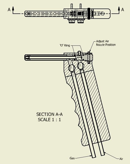

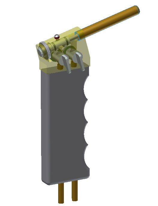

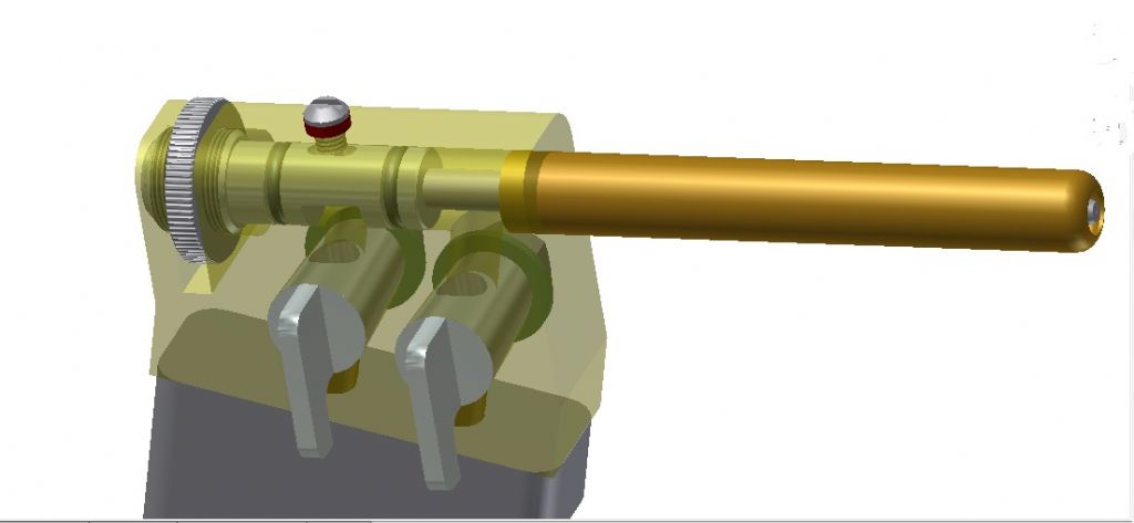

                                      For fine precision silver soldering I will try the suggestions above but I though I would play around a little with a propane / air design based on the info provided by Neil. This is what I came up with, any comment good or otherwise appreciated. Not all details worked out yet, just playing around with ideas.
                                      Provisional Drg
                                      3D view 1
                                      3D veiw 2
                                      Nigel
                                      #100249
                                        Nigel,
                                        That looks very tidy
                                        When you get the various dimensions and pressures sorted; please share [either via the forum, or it would make a good article for MEW].

                                                    tractionengine42, seeing your 3D CAD images for the propane/air torch reminded me of a similar torch my grandfather had. He was a dentist (actually a dental technician).
                                                    The torch was used on coal gas and air fed from a foot operated leather bellows. it was basicaly two tubes joining together where the top tube bent at 45degrees and then a single tube for about 2" before terminating with a jet screwed in the end. At this point another tube screwed on (about 2" long x 1/2" dia.) This, like in your CAD, also had an inward flare.
                                                    The big difference between the two torches is that your jet is flush with the end, whereas My g'dad's was inset 2".
                                                    I've just started playing with an Einhell Oxy Compact 600/15 with a view making it use compressed air / butane (or MAPPS). In standard form, the slightest amount of air introduced immediately extinguishes the flame. I've read that butane does not mix as readily with air as coal gas. But even my g'dad's torch has a couple of inches of tube for extra mixing.
                                                    The tip on the Oxy Compact is a "double" type with a small bleed hole on the side of the central tip tube. I'm guessing that the central tip at the end is using venturi effect to pull the overall flame shape in.
                                                    I did try taking off the outer tip and taping on a 6mm dia. tube instead. Extending just past the inner tip was better, but it still extinguished. Extended 2", I couldn’t blow it out! (too late to run the air compressor). So I get the impression that an inner tip flush with the end may be difficult to achieve, but I’d be glad to be proved wrong.
                                                    Also, I've read of a design which uses electricity to pre-heat air/butane to get a better mixture. So I'm thinking of perhaps a coil of tube through which the flame travels to pre-heat the mixture before arriving at the jet(s). And making the inner jet (venturi) adjustable in position (for testing purposes) to get the sharpest flame shape.
                                                    I think pre-heating will be a real asset because I have one butane burner nozzle which simply will not work until it is hot enough. I have to wrap my hand over the rear air holes, get a yellow flame going, then slowly open the holes as it warms up.
