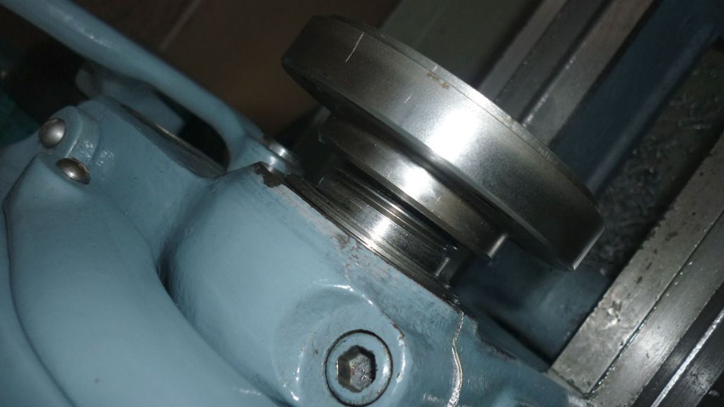

                    #265394
                    Richard Harris 5
                      @richardharris5
                      So the taps arrived with him, set off 3.
                      I explained how to use his lathe to make alignment easier and start the threading. But then after the weekend he says he felt it was too risky and didn't feel like doing it himself. So he has a friend at work who is very familiar using a engineering lathe to do it.
                      Their idea is now to buy a 1 x 8 BSW LH die and make an adapter for it.
                      Can someone else comment? To me, this makes no sense. Both the chuck and the lathe are 1" diameter – a thread adapter will not fit unless:
                      a) the bore out the chuck (for which, we don't know how much material is actually in there)
                      b) the take the spindle off and turn it smaller (for which, they'd need a 1 x 8 metric die to fit the current chuck thread).
                      Am I confused?

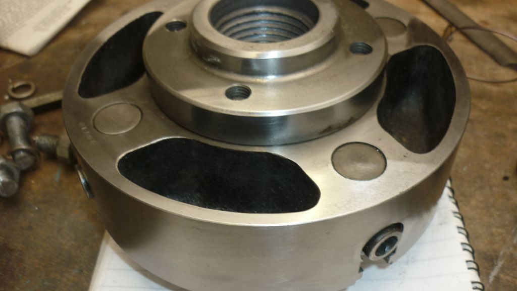

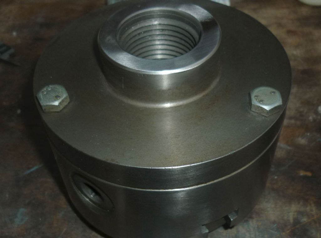

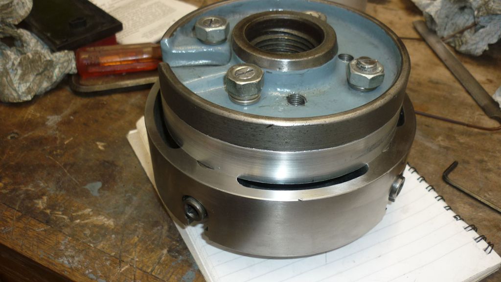

                                  #265804
                                  mark smith 20
                                    @marksmith20
                                    I have a similar problem but the opposite ,i have two good chucks that need back plates for a south bend 1 1/2 x 8 UNC spindle , problem is the chucks that came with my lathe had nice backplates but they were threaded for a boxford at 1/1/2 x 8 BSW and dont thread on properly.
                                    Ive done some external threading on the lathe but how does one redo the same threads only with a unc single point cutter (ie the treads already in the back plates which will be internal) .??
                                    The lathe has a gearbox and thread dial indicator.
                                    The first photo is of the four jaw chuck back plate showing how little the chuck will thread on.
                                    The second two photos are the 5" 3 jaw chuck  showing the internal threads.
                                    At the moment im using the 6" 4 jaw temporarily fixed to a south bend dog drive plate which does have the correct thread but is less than ideal.
                                    By the way the taps for these are like gold dust and cost upwards of £100 second hand on ebay due the amount of south bend owners in the US and elsewhere.
                                    Edited By mark smith 20 on 10/11/2016 15:19:52
                                    Edited By mark smith 20 on 10/11/2016 15:22:04
                                    Edited By mark smith 20 on 10/11/2016 15:24:10

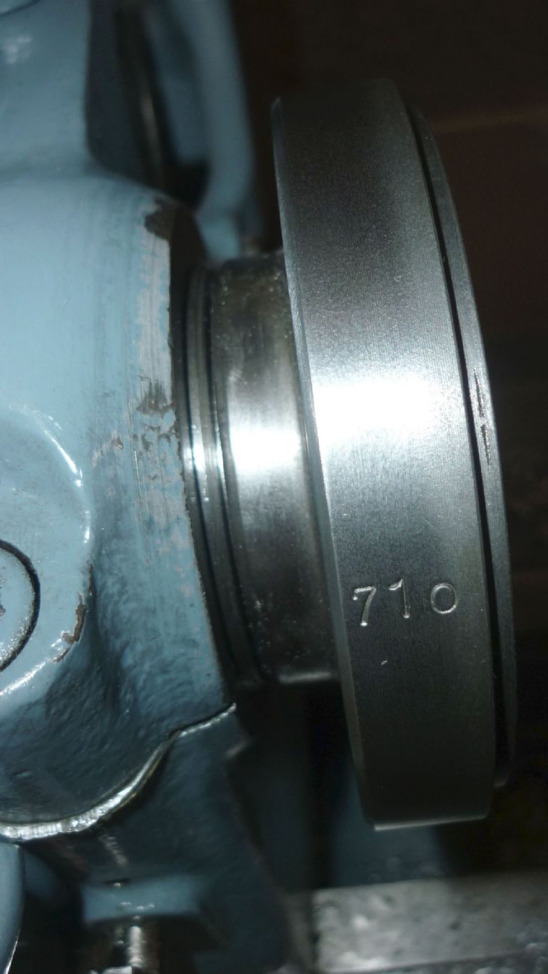

                                    #265826
                                    NJH
                                      @njh
                                      Richard
                                      Not an answer to your question I'm afraid but a " thank you" for posting that image of the lathe. When I was a lad ( back in the days when Adam was too) my Dad had a woodworking business. He purchased a lathe just like the one you have posted ( although his was grey) and, when he worked weekends, I would often go with him and "play" on the lathe. I still have a fruit bowl and table lamp somewhere around the house!
                                      Happy memories
                                      Norman
                                      Edited By NJH on 10/11/2016 16:45:26

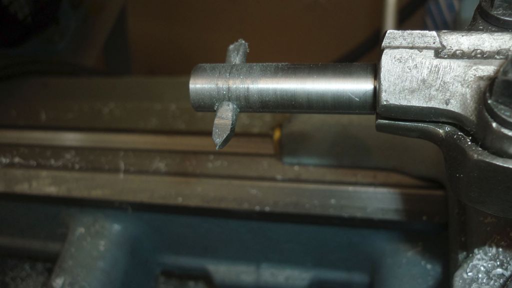

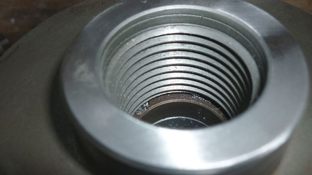

                                      #266164
                                      mark smith 20
                                        @marksmith20
                                        Hi Richard ,did your dad get it sorted out???
                                        I posted above about my problem with BSW 55 degrees back plates and needing them to be UNC 60 degrees.
                                        Well i just done one by picking up the threads using a homemade cutter from a broken centre drill ground to 60 degrees . It was fiddly to set up being an internal thread and clearance etc… but i took a very little off and the result is my back plate goes on perfectly.smiley
                                        I watched a you tube video on how to pick up the threads ,as i had never tried it before and it was very easy.
                                        Edited By mark smith 20 on 12/11/2016 13:16:10
                                        Looks a lot better as well.
                                        Edited By mark smith 20 on 12/11/2016 13:31:51
                                        Edited By mark smith 20 on 12/11/2016 13:33:47

                                            Posted by NJH on 10/11/2016 16:44:48:
                                            Richard
                                            Happy memories
                                            Norman
                                            You're very welcome Norman! I may try and get some more photos of it if we make something over the Christmas period.

                                              UPDATE:
                                              So I actually saw the lathe over christmas and noticed it isn't actually setup right. Ugh.
                                              The chuck on the outbound side – that has caused this massive faff – isn't on all the way. It's threaded on fine, feels nice and snug, but it's just sitting on the threads. It doesn't go all the way onto the "cuff" part of the spindle… if that makes sense? Do you know what I am trying to describe?
                                              I've had a look and the chuck isn't very deep, so I am not sure boring out the inside of the chuck would work very well., or at least, it may not take it all the way in deep enough. We need around 12mm to get it all the way onto the cuff.
                                              Is it acceptable to cut off the end off the threaded part of the spindle? So that there is less threaded part, and it will slide onto the unthreaded / flat part of the spindle?
                                              Or should we start by boring the chuck first?
                                              He noticed it because he had bought some large donut type jaws with small rubber buttons, so you can hold a bowl and finish the bottom of it more easily. With the larger diameter, there seems to be a pronounced wobble on it. But, it is quite minimal to my eye, for wood turning.

                                                I also just looked at his chuck on the inbound side, and the fit is absolutely atrocious. I do not know how he is still alive, or how he didn't think this was unusual. The amount of play on it as you screw it in, there must be at least a 2-3mm difference. Luckily, that chuck has a simple backplate, so it would be easy to swap for a thicker backplate, and then thread it properly.

                                                  Richard
                                                  Do not attempt to modify the spindle in any way – it is probably hardened in any case. The "cuff" that you refer to is the register and, whilst the threads on the spindle and chuck draw the two items together it is the close fit between the registers of chuck and spindle that ensure alignment. The end of the chuck backplate should be bored such that it is a close fit on this register.
