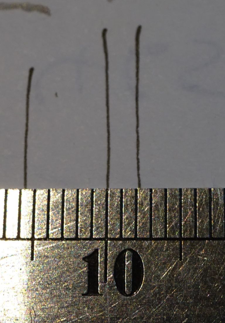

But I'm extremely confused about "0.05" Uni Pin Fine Line pen that I have.
The official website has the "pen nib size" as "0.05mm"
(see **LINK**)

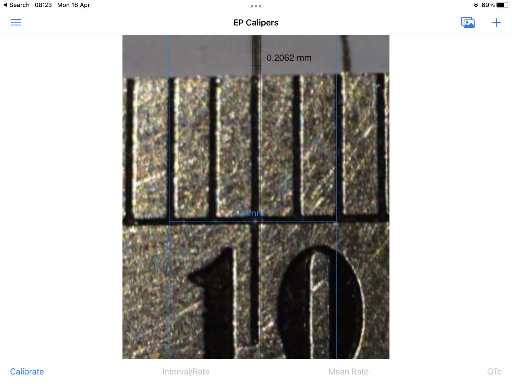

However I just measured mine, and metal jacket/pointy bit seems to be 0.78mm and the actual felt measures 0.5mm and not "0.05mm"!
Maybe they mean the line thickness…(??)
However IME, if you are pressing hard enough to get a reasonably consistent black line, I still seriously doubt it is "0.05mm" thick. I mean 0.05mm is thinner than the nominal thickness of human hair which is 0.075mm (75 microns).
