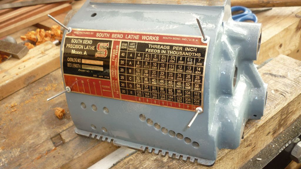

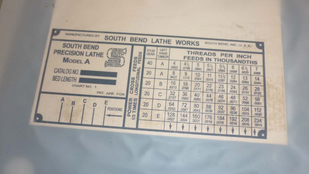

                                      mark smith 20
                                        @marksmith20
                                        Posted by Roger Head on 28/12/2016 01:07:28:
                                        My only experience with chemical etching is making pcbs for electronics (I've made hundreds over the years), so it's all shallow etching. To obtain 1/16" deep etching of acceptable quality (clean steep edges on your lettering, lack of undercut, etc) might not exactly be a doddle in a 'kitchen-table' type of setup.
                                        I'd suggest a reasonable bit of googling first, and enough material for lots of testing. I'll be happy to be proved wrong.
                                        Just my two cents…
                                        Roger
                                        I did this which was my first attempt and turned out good enough to use,using a cheap samsung b/w laser printer , some mylar drafting film ,an iron and some ferric chloride. It is impossible to get very deep but was good enough for the south bend gearbox plate.p1250952.jpg

                                          #274123
                                          Roger Head
                                            @rogerhead16992
                                            Hi Mark, that plate looks really good yes. As you say, getting any real depth of etching consistently is very difficult, but if a shallow etch is acceptable, then getting sharp, high-resolution linework is quite straightforward.
                                            I am particularly interested in the red and black infill that you have achieved – could you please give us some details on your method and materials for achieving that, and also some close-ups of the finished plate.
                                            My 13 x 40 has no plate for the threading dial, only a table (in a poorly photo-copied manual) that looks like it was scratched out by a one-legged chicken clutching a blunt pencil! That page in the manual is now deteriorating through constant reference, so I've been 'thinking about doing something' (i.e. procrastinating) for a while.
                                            Roger
