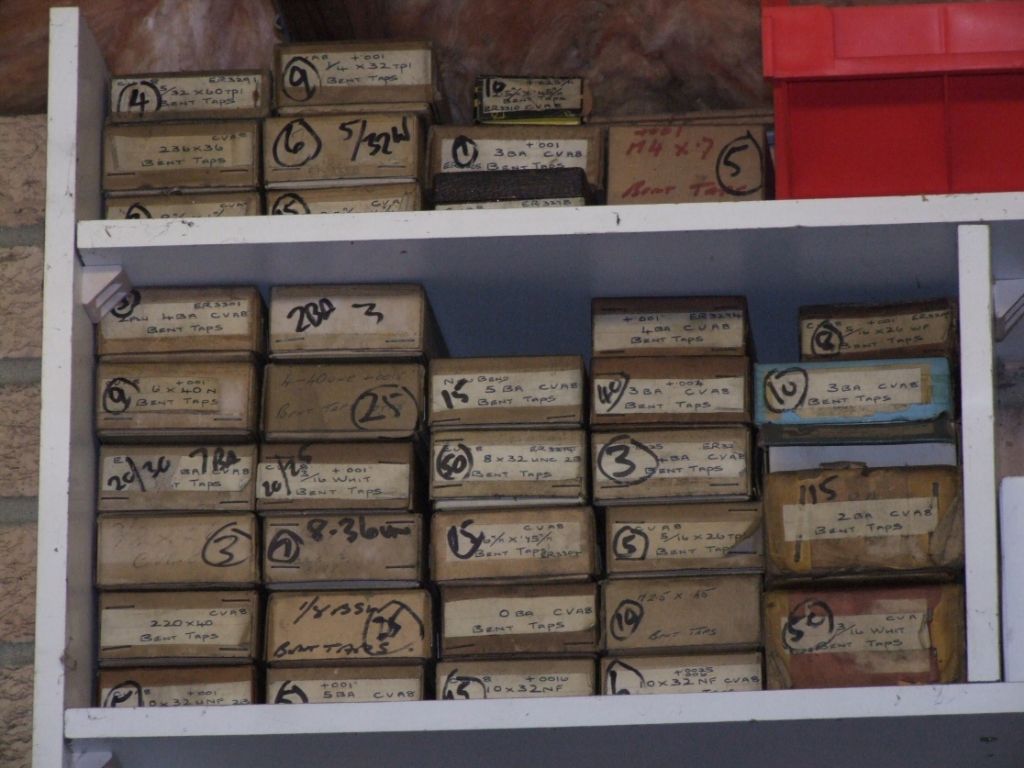

        Here’s a picture of some ‘mystery’ tooling:
        I’m pretty sure I know what they are, and on what type of production machinery (that’s a hint) they are used. What I don’t know is exactly how they are used in the production environment. I’ve got boxes of the things:
        Possibly not one of my better buys on Ebay. Then again the whole lot only cost 99p, and they were delivered FOC to my mother, ready for me to collect later.
        So, can anynbody confirm what they are, and even better has anybody used them in anger?

                Martin & John: Spot on; that’s what I think they are, bent shank taps for use on automatic nut tapping machines. The shanks are smaller than the thread core diameter, so the nuts can slide down the shank. What I don’t understand is how the nuts fall off the other end, as the tap must be held somehow. I did think of something like the two clamp method, as suggested by John, but it seemed a bit hit ‘n’ miss. I guess if the fingers were timed correctly you’d avoid clamping one’s nuts by mistake? God only knows why I bought them; idle curiosity is all I can think of, but at least it didn’t break the bank.
                Neil: I’ll be happy to send you an assortment FOC. Be aware though that they’re rather odd sizes. There’s a lot of BA, some UNC/NF, Whitworth and metric and some other oddities. If you can’t read the sizes from the picture let me know and I’ll PM you a definitive list. Some of the taps are loose in the boxes, but others are in sealed plastic bags with wax over the tap proper, and so are presumably unused.
