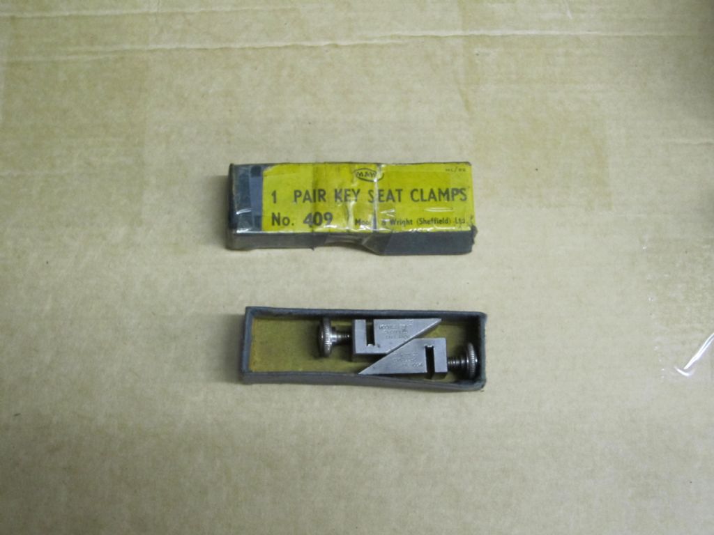

Hi all, Any ideas on this pair of tools? I know what they are but I'm surprised by how many experienced engineers were foxed at my club. Mick
They attach to a rule and are for marking out key seats on a shaft.
Mike
Well done Mike. Key seat gauges is what they.
They are fantastic as they allow the rule to sit along the centre of a shaft and make the ruler easier to pick up from the bench to boot.
