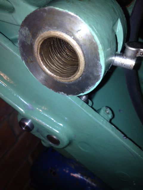

The original bushes are Oilite, as Martin says, and are not drilled for oil as they are oil soaked and permeable
However, people being people they often drill holes in them to coincide with the oiler – this results in all the oil running straight out of the oiler and through the bearing instead of soaking gradually through.
They should be smooth inside.
This looks to me as though someone has removed the shaft, which has a burr or other sharp protrusion on it, and these score marks are where they have wiggled it to and fro, no doubt grasped firmly in a Mole wrench.
