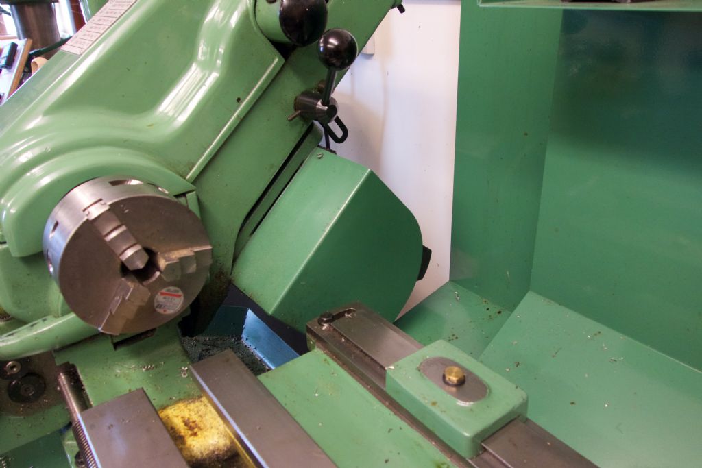

                                    Here is a picture of the motor swarf guard. The lathe came on the stand but later I "indulged myself" with the splash back and motor guard. Both were purchased from Myford – I don't know if they are still available though.
                                    As you will see the guard is a pretty simple ( but effective!) affair .
                                    Norman
