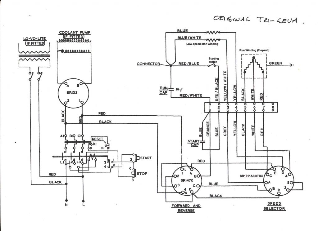

      Hello all, I have a problem with my Myford 2 speed ML7 Trileva which only runs at slow speed. I've had no success with trying to find a wiring diagram for the 2 speed Crompton Motor and the Myford switch in order to check for incorrect wiring etc. I. Just missed discussing it with Myfords before they closed and the standard Myford diagram doen't refer bto the 2 speed un it…. Does anyone have any diagrams of the 2 speed motor and switch please?
      Thanks
      Robin

            Thanks for replying. I was advised when I bought it that it is a two speed motor and on the drum type switch (fitted into the cabinet) it has forward and reverse with low and high speeds available on both via the selector switch which is clearly original. The motor has 5 leads (including the green, presumably the earth). This should according to the Myford brochure and the trileva plate give 6 speeds and another 6 when the back gear is selected .
            The difficulty is that the Myford ML7 and Trileva manual doesn't give any wiring diagrams appropriate for a two speed motor and local sparks I've spoken two say it isn't possible on a 1ph motor! However, I have found other data on the net which says it is though and I do have the physical proof of the machine!
            The trileva works fine on the lower speed though but I simply cannot remember if it worked on all 6 speeds when I bought it. I've now decided to replace the conector box with one which permits easier connections visibility (the original was small and difficult to see if they were made correctly) and will wire it up the same as it was just to check the connections were made correctly.
            For anyone more knowledgable than me with motor electrics, the motor leads are red, black, brown, yellow and green. The motor has a single capacitor and might be a Crompton although it has no nameplate. . It has 4 terminals Z, A, ZA, T and earth. which appears to be the Crompton designation and the manual for the standard states these are start, running, running and start windings respectively.
            All I can think is that the complicated switch somehow links different windings together to get the 2nd motor speed…. Arghh my brain hurts!

                      My ML7 Tri lever is fitted with a two speed single phase motor, it was supplied to the original owner in that configuration by Myford.
                      The motor has something like 10 wires brought directly out to the terminal box on the rear of the cabinet.
                      There are two capacitors one mounted on the motor, the other one is inside the cabinet near the rotary switch.
                      I did try to get a wiring diagram for this a couple of years ago at a Myford open day, but none seemed to be available, even via their Electrician.

                          I have found what little info I gleaned for my machine, (most unusually I had actually put all the stuff in one place), but sorry to say it bears no relationship to what you describe for your motor.
                          I agree with Phil about getting it sorted by a suitably qualified person.

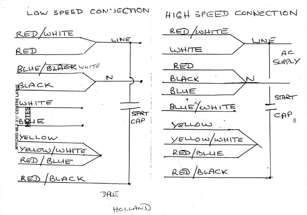

                              Hi Robin, I have all your answers. I purchased a Tri-Leva with a 2-speed motor and no switch. But I have a circuit diagram, you have never seen anything so complicated in your life. The bad news is that you have a standard single speed motor fitted. A 2-speed motor is now rarer than Gold Hens Teeth. It is enormous with at least 10 leads coming from it. As i said before I had no switches, but on the circuit at each of the switches was a number. I rang Santon who made the switches for this originally and the numbers were the part numbers for them. I asked the 64, thousand dollar question, have you got any. Don't be silly, I have worked here for 30 years and have never seen one. But if you want some our Parent company in, ( I think it was) Norway will make you up a pair, but they will cost you an arm and a leg. New switches fitted, she runs like a Swiss Watch. So I have circuit, switch connections, motor wiring diagram. If you want copies e-mail me @ terence.yates44@virginmedia.com
                              You will have to bear with me, my scanner has thrown a wobbly.
                              Regards Terry

                                      Ian SC This motor has a start winding and a run winding for low speed, and a start winding and a run winding for high speed. Two motors in one case, simplfied. From memory one of them is 1/4 hp the other is 1/2 hp. Go to http://www.lathes.co.uk/myfordtrileva/ Here you will find a good description and pictures. Also a super site to explore.
                                      Terry

                                        Scanner back on line, so I will sort details for scanning ang find out to put them on this site.
                                        Terry.

                                            Hi Robin, my lathe had no switches or anywhere on it where they fitted. The new Santon speed change switch has three positions high, off, and low. The reverse has two positions forwards and reverse. I have had to fabricate my own housing, as I could not find a picture of an original. Next time I would go with an inverter and 3-phase motor on single phase. When i first got this lathe the two speed motor was not fitted, (I think someone had bought it to do a conversion, but found it too difficult and gave up) but brand new. Where the wires came out of the motor was a cover, which I took off. Under there were two motor circuits, high and low, so to prove it I twisted the colour coded wires together as in the circuits and banged them into the mains via my rotary transformer and advanced the voltage knob. The start wind started, switch pulled in to go to run winding. Hey-Presto sorted. It all runs happilly now. I now have a standard motor and switch to get rid off.
                                            Terry
