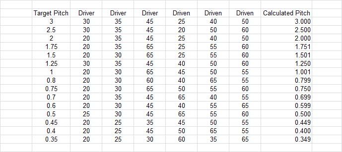

                                      Roderick Jenkins
                                        @roderickjenkins93242
                                        I have enormous admiration for the people who calculated metric approximations by analytical means using translation gears but since it's it's a cold, damp, indoor afternoon here in Hampshire, I thought I'd have a go with the scattergun approach using my Excel/visual Basic calculator. Many older British lathes had a fairly basic changewheel set of 20-65 in steps of 5 and an 8tpi leadscrew (such as my old Zyto). Using only these I get the following table for all the usual metric coarse and fine threads that you might want to screwcut::
                                        I'm not saying that you can get every combination to mesh on the banjo but I think it is quite interesting that no thread is more than a micron out! This is better than I got with a PET2000 some decades ago but I think that's because the calculations take a second, not overnight, and I'm letting them carry on to a smaller error.
                                        Rod
                                        #221474
                                          Nicely done, Rod
                                          Some very good results from a small collection of change-wheels.

                                          Roderick Jenkins
                                            I think it's just an example that somewhere within all the combinations of changewheels is the required set for most threads to a practical accuracy. Even on the fairly small set mentioned above there are (I think) 4,200* unique combinations.
                                            * 10C3 x 7C3 – is that correct?
                                            Rod
