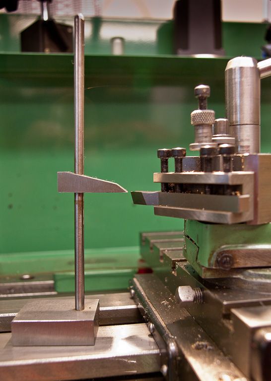

      If you have a little time to spare making up one of these and keeping it on the lathe is useful. ( I can never find my 6" rule when I need it! )
      Norman
      Tool Height
      Edited By NJH on 06/08/2017 13:31:23
      I stuck a label on the headstock giving the centre height from both the lathe bed and the cross slide. So I can just use the digital height gauge to set tool height.
      #310922
      NJH
        @njh
        That's true Nicholas but my height gauge is pretty big and rather unwieldy to use on the lathe – my little gauge sits happily on the lathe shelf. I guess I could add a second arm to use it on the cross slide but, in truth, I've never needed to do that.
