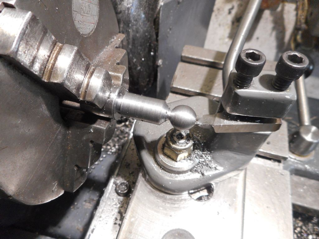

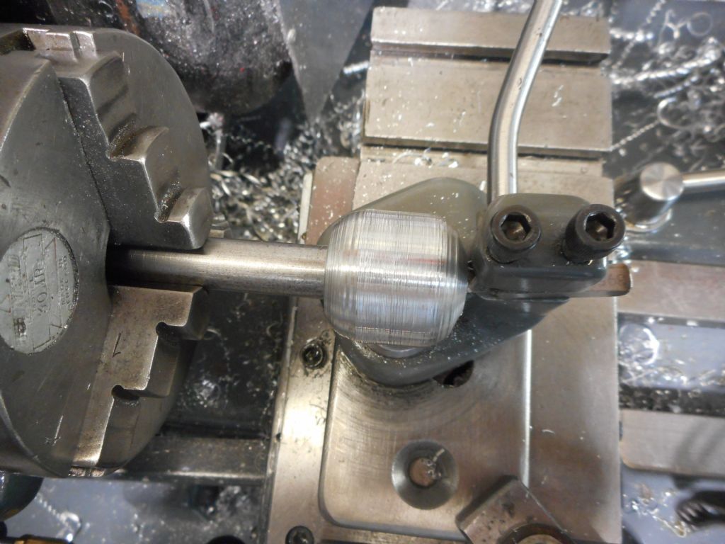

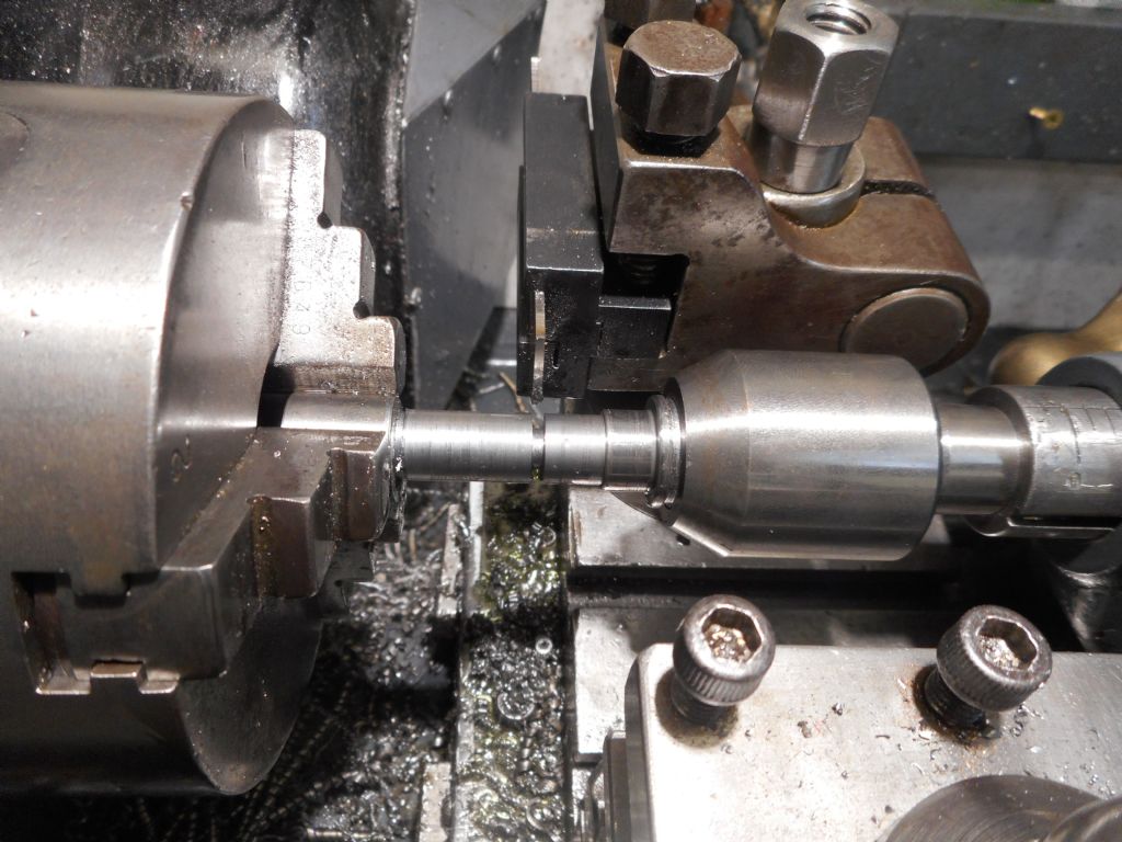

BALL TURNING

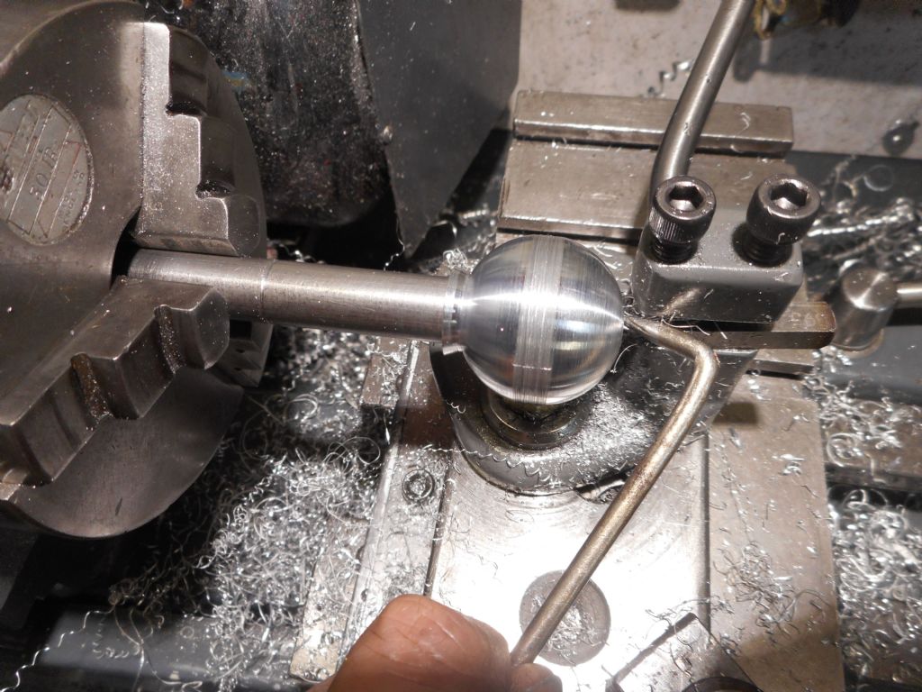

Is always an adventure. More of an art than a science in my case. My ball turning tool is very primitive, simply a flat plate that attaches to the cross slide with another smaller square flat plate attached to it with a pivot bolt. A piece of upright square bar is welded to this to hold the toolbit and the handle to make the toolbit sweep in an arc, the size of which is dependent on how far out of the holder the toolbit sticks. It works but it's a bit fiddly. I made it in a hurry years back to make the ball handles for my fabricated GHT dividing head and it worked well for that. But making the 1-1/2" diameter aluminium ball to go on the end of the tailstock lever handle was a challenge.
First up, the tool would only move out far enough to make a 1-1/4" ball so had to go with that. So I cut a piece of 1-1/2" round ally bar 1-1/4" long and drilled and tapped it to take the 1/2 BSW thread on the end of the handle. Then turned the OD down to 1-1/4".

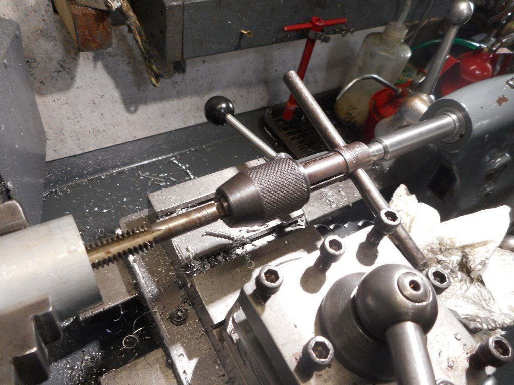

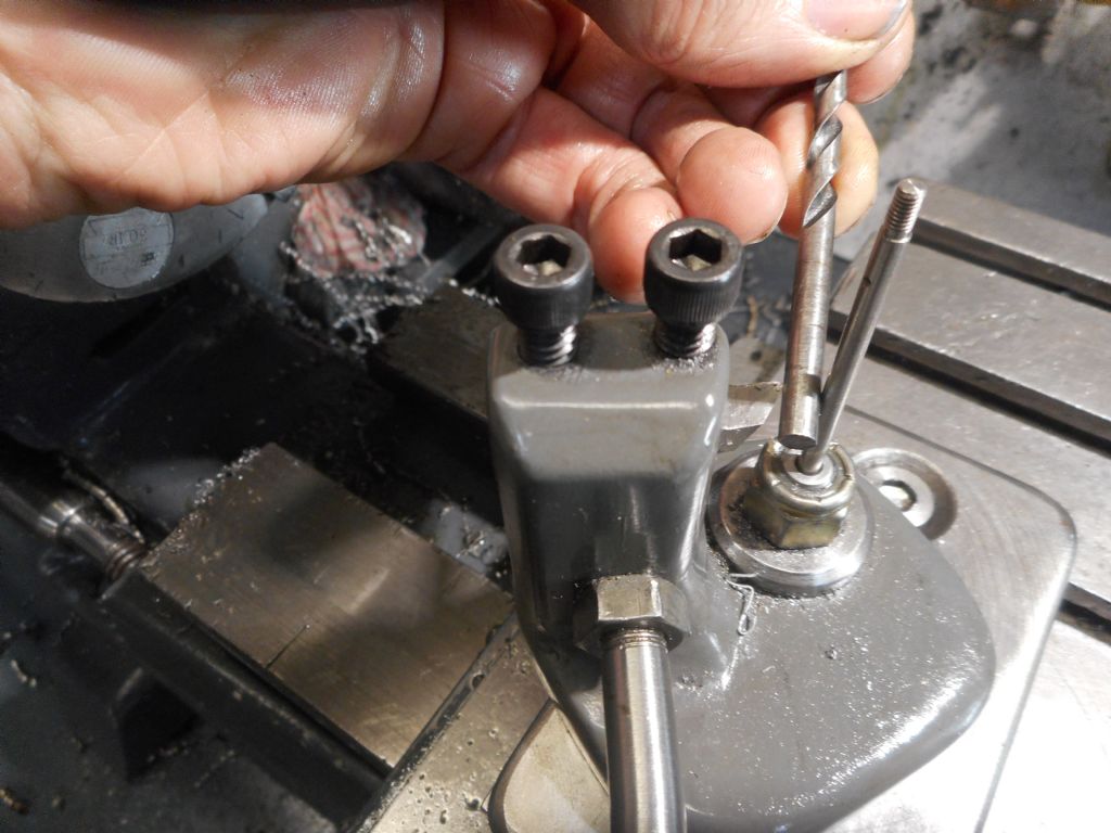

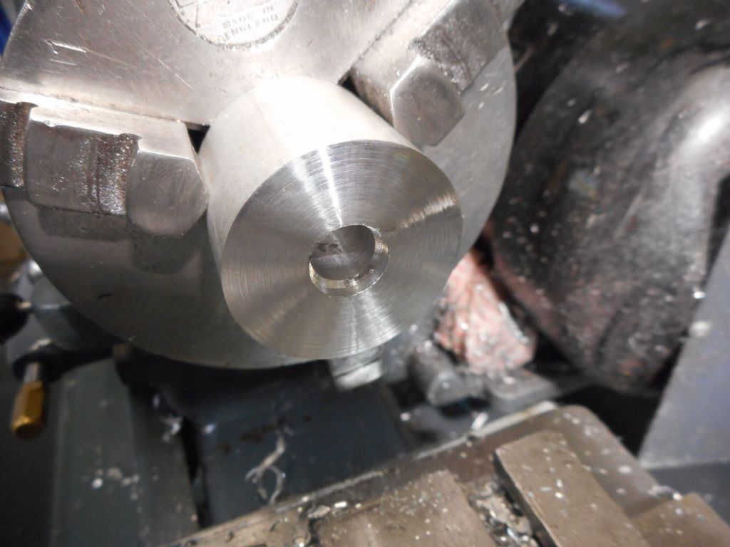

One little trick was I drilled it 27/64 or whatever for tapping, then poked a 1/2" drill bit up the hole for about 1/8" or so. This will cover the last turn or two of thread on the handle, so I don't end up with a half to quarter turn of half-formed thread sticking out on view. Much tidier I think.
Used my homemade spring centre in the tailstock to guide the tap wrench while using my spindle crank handle same as for the thread on the handle itself. As always: brilliant. Nice and easy and nice and straight.
Then before I mounted the ally block onto the 1/2" round handle as a mandrel for the final ball turning escapade, I decided to rough it out a bit freehand to quickly remove most of the metal. Simply done by co-ordinating turning the carriage and cross slide handwheels together. Simply but not that easily. Some people can do this really well. I can't. A bit more CAM – Corn-flakes packet Assisted Machining — with a cardboard template kept me sort of on line. Anyhow, got rid of a lot of metal on both sides of the ball-to-be without hashing it up.

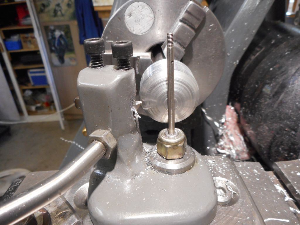

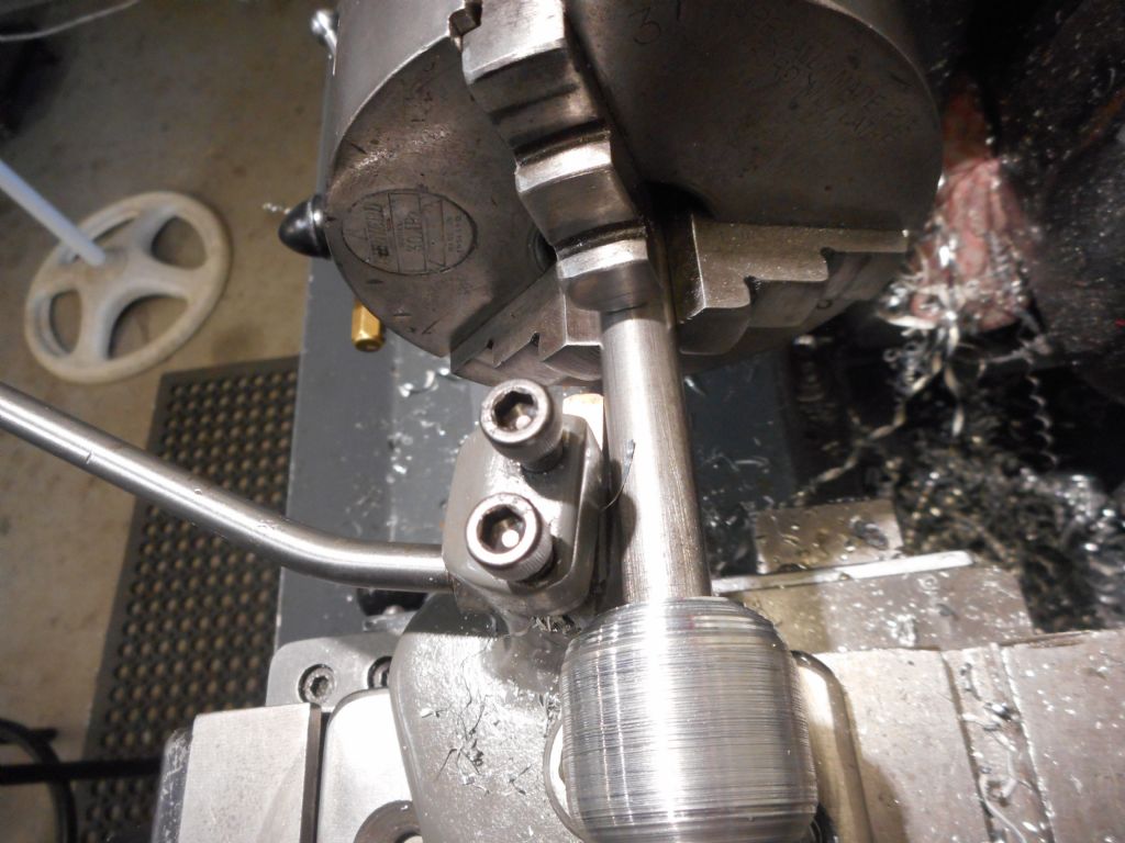

THE BALL TURNING TOOL
So the lump was mounted on the round bar handle and held in the chuck. A lot more stick-out than you would normally use, but necessary so the primitive ball turning tool can get around to the back side of the ball without banging into the wildly rotating chuck — that never goes well.

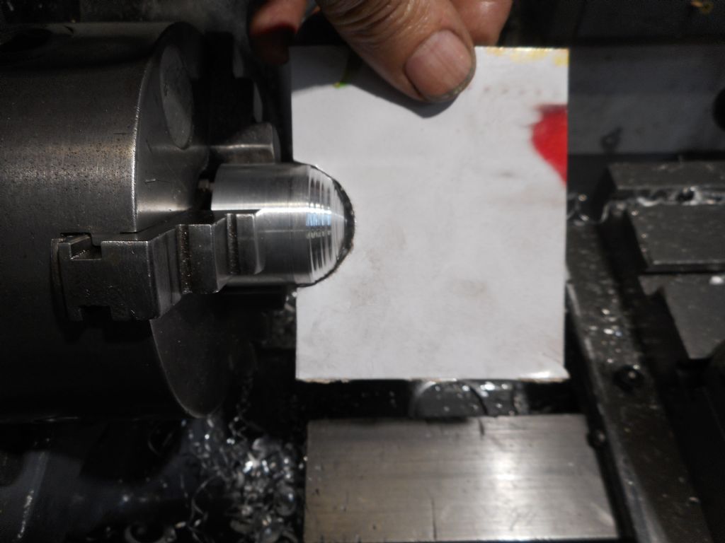

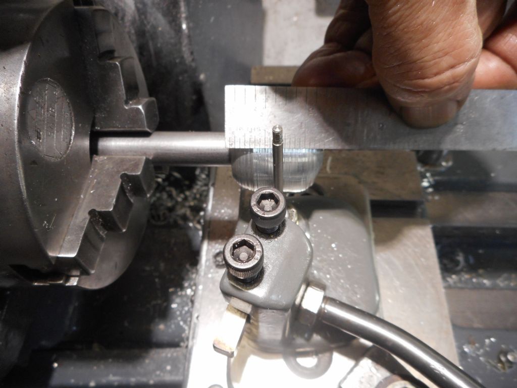

First step is to set the depth of cut. Done by eyeballing a pin dropped into a hole in the middle of the pivot bolt. If the centre of the pivot bolt is in line with the centre of the job, the finished result will be a proper sphere. Otherwise it can come out sort of oval shaped. Once this is set, I marked the cross slide with a felt pen line and zeroed the cross slide dial for future reference.
Then it was a matter of wind the cross slide back out and set the ball turning tool up central to the lump longitudinally:
If you have got it right, the tool will just kiss the end of the lump when swung around 90 degrees
Then its just a matter of bringing the tool back out and starting to wind the cross slide in while sweeping the handle back and forth taking cuts off both sides of the lump. You just wind the cross slide in by the desired depth of cut each sweep.
The band in the middle gets smaller and smaller as you go. When it's gone, you have your ball. Here I am removing some of the stringy allly swarf balls that kept getting between the tool and the job and impeding cutting. Poor chip control as the CNC guys would say. But caused by the toolbit having almost nil stick-out from the post in order to make the ball as big as possible. The collar on the left is caused because I had to make the ball slightly smaller than expected to clear the pivot bolt below the lump. Nothing is every easy! So had to reduce the diameter, which meant the lump was a tad too long. No worries. Will make it blend in at the end.
The finished ball gleaming in the lamp light. I did not mirror polish it as I am going to paint it black to look "right" and want a surface for the paint to key to. But of a polish with 400 grit emery gave this result. The off-tool finish can be seen in the above pic. Very shiny. It's a nice bit of ally. Probably 6061 T6 or similar from memory.

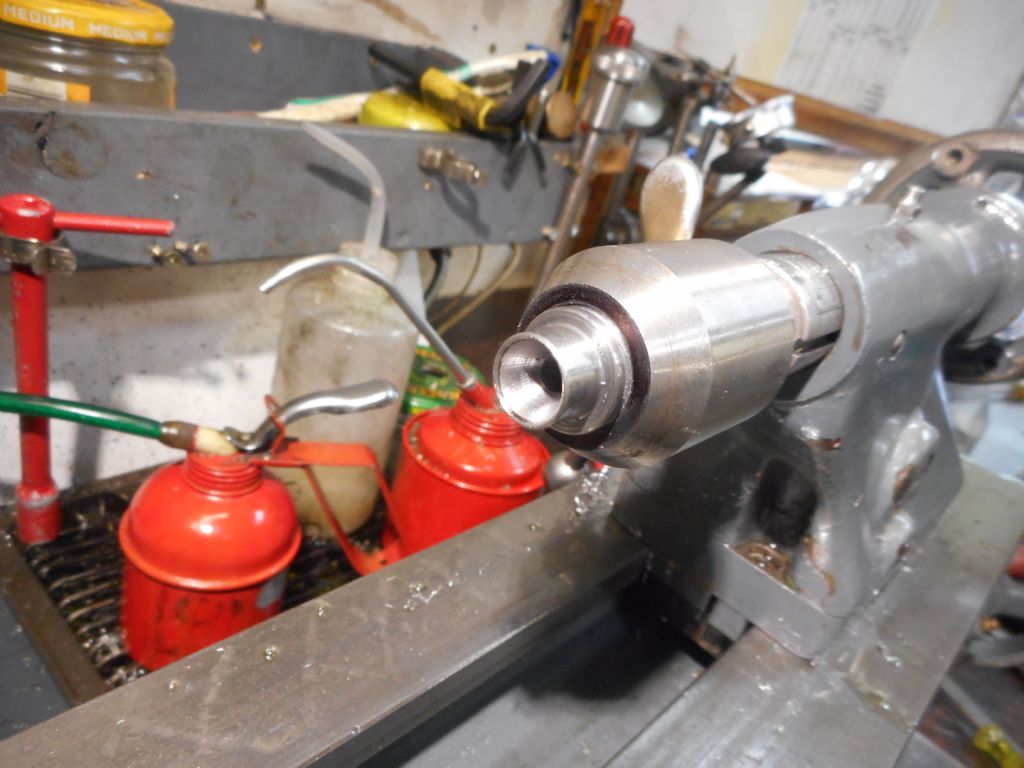

And here is the finished ball, badly out of focus but showing the Mighty M-Type Drummond in the background, just for Ady1!
You can see I turned that collar down parallel and blended it in so it all looks like part of the plan. Did that by just holding the ball turning tool in place by hand and operating the carriage handwheel so it turned parallel. Then pivoted the ball turner handle to create the radius on the edge of the collar. I told you ball turning was more of an art than a science! Just be glad I am making decorative ball handles and not artificial hip joints.
And notice that no thread on the shaft is visible due to that counterbore I put in the hole. Gives a nice clean look and no sharp edge of the thread there to catch on hands in operation.
A quick lick of satin black paint and it now looks like another item that fell off the back of Myford's truck. I won't include a pic of the paint drying. Not that exciting to watch really.

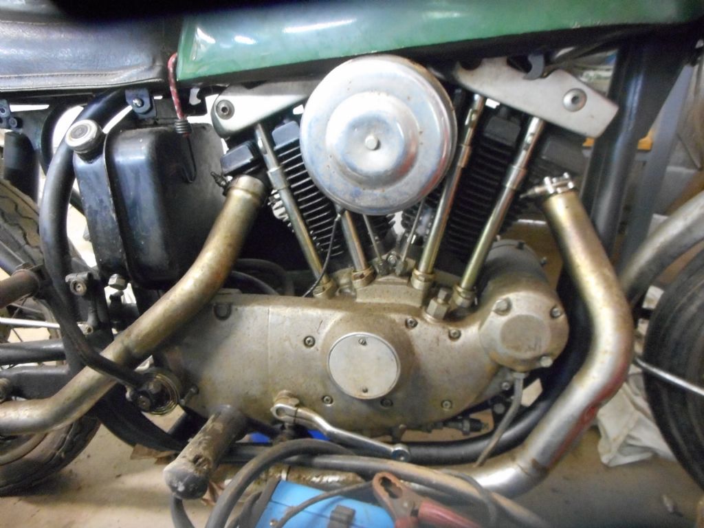

Here you go. Sadly, sadly neglected these days I am afraid. It had a Trident T150 disc brake front end on it when I had it on the road in America. But getting a hybrid registered when I moved back to Australia was more red tape and engineer's certificates etc than I had time/motivation to deal with. Australia has got to be the most over-regulated country in the "free" world. Don't get me started… Anyhow, the Trident got put back together and sold off to my brother so now back to Norton forks and wheel. I do have a John Tickle 2LS brake to go in there one day.
It's a 1974 Harley Sportster engine and that's the Sporty oil tank shoehorned in behind it. Norton Atlas Slimline Featherbed frame. The engine only just fits. The rocker boxes poke up through the top frame tubes and the tank has to be mounted slightly high on extra rubbers to clear. I could drop it by an inch if I cut a section out of the bottom frame rail to clear the oil pump. But I just cant bring myself to stick a hacksaw into a genuine Featherbed frame! Getting the engine in was a trick. Laid the engine on it's left side on the shed floor and then put the frame over it. Worked the top tubes down over the rocker boxes until the bottom frame tube was hung up on the oil pump by about 1/8". So I jumped on the frame and sprung it out over the oil pump and "POP" it all went into position. Stood it all upright together and made the engine plates using cardboard templates (Early CAD — Cornflakes packet Assisted Drafting) . I made the whole thing in a log cabin behind our house in Montana with no gear other than a box of spanners, a hacksaw and pistol drill. I was young and energetic then.
It is a hoot to ride. Lighter and nimbler than the old Sporties and way more raucous than a Norton. Those straight pipes are LOUD! You can feel the extra weight of that tall cast iron engine in the front end though. Confused the heck out of the Yanks who could not understand why anyone would want a Norton frame on their Harley, and how do you ride with those handlebars (BMW R100RS bars) way down there like that. Nobody there had heard of cafe racers in the 1980s.
These days, the combination has become so popular that Dresda are making the frames with the extra inch of height to fit Harley engines. I was only 30 years ahead of the curve!

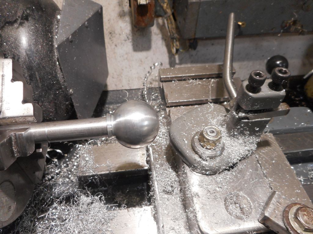

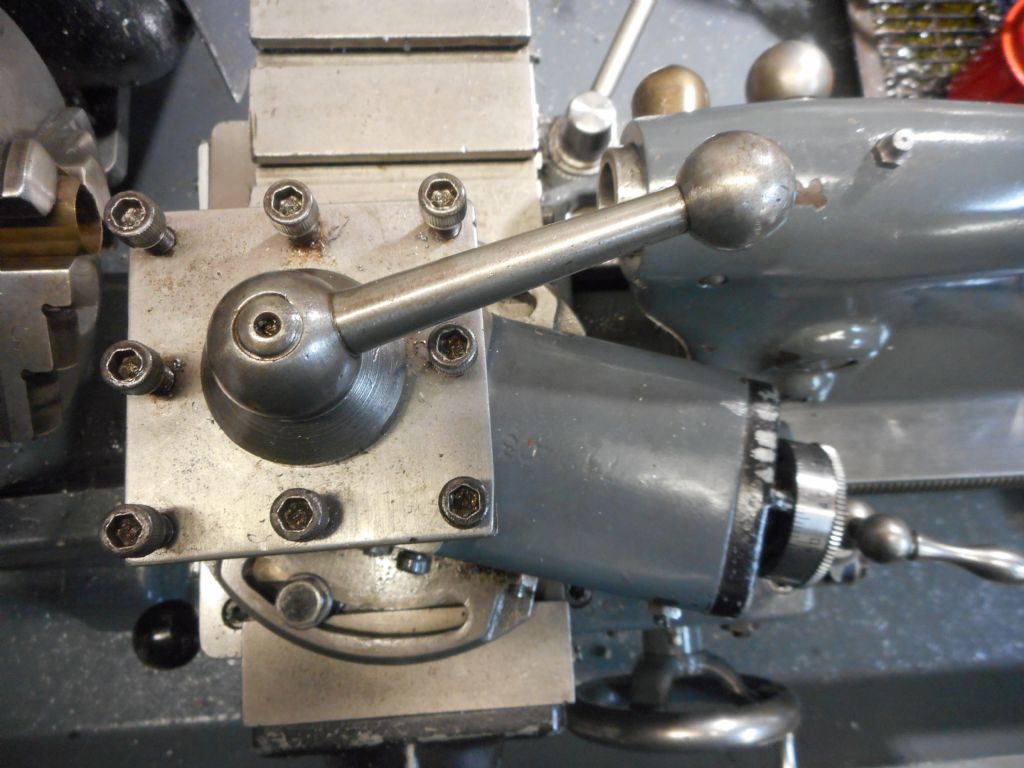

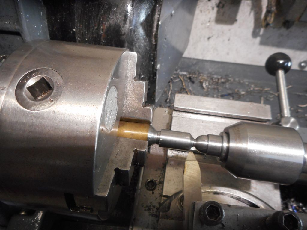

MAKING A BALL LEVER
So I decided after seeing Ega's pic to make a ball lever for the handle pinch bolt instead of just using a naff looking and readily available Allen head screw. Noooo that would be too easy! This is it:
Innocuous looking thing isn't it? But gee whiz those thing are a faff to make. GH Thomas got me started on these with his Versatile Dividing Head. But GHT makes his in two pieces with the small ball screwing on to the main tapered shank. But I'm way too lazy for all that. So I make mine in one piece. I have done them ranging in size from 4"long on the top of the four-way toolpost I made for my Drummond M-Type, down to tiny little 1" long jobs on the tailstock arm for the versatile dividing head. Trouble is I can never remember exactly how I did it last time so every time I do one it turns into a major faff to get it down with that ball turner of mine with not much access in behind the ball towards the chuck. So thought I would make a record of how I did it this time, in case I ever want to do another one in the future. It would of course be easier to do a modern brutalist style handle, just a cylinder with a straight bit of bar sticking out of it. But that would be no fun would it?

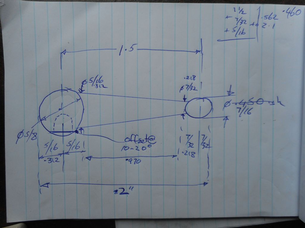

First step is to know in advance what size you want to make it. So based on GHT's rules of proportion but blowing them all up one size to suit my heavy handed proclivities, I came up with the below masterplan. In the absence of a fag packet to sketch it out on, a piece of jotter pad did the job.
First step was to turn up a blank the correct length, with a lump on one end the length and diameter of the large ball, with the rest of the shaft turned down to the diameter of the small ball. Then go in and put two grooves in it where the end of each ball is going to fall. Each groove is made to the depth the tapered shank's diameter will be, according to the above masterplan.
Had to go old school to measure the diameter down in the bottom of that narrow groove. Calipers can then be measured with "normal" digital caliper to ascertain size. Or with a steel rule if you want to really go old school.
IN the end, you have the still cylindrical blank held by the large end in the chuck by the large end, small end sticking out and the two grooves in place demarcating both the edge of each ball and the diameter and location of the each end of the eventual taper. More of which anon.

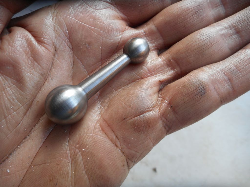

BALL LEVER cont.

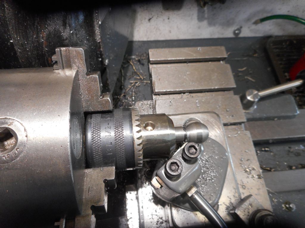

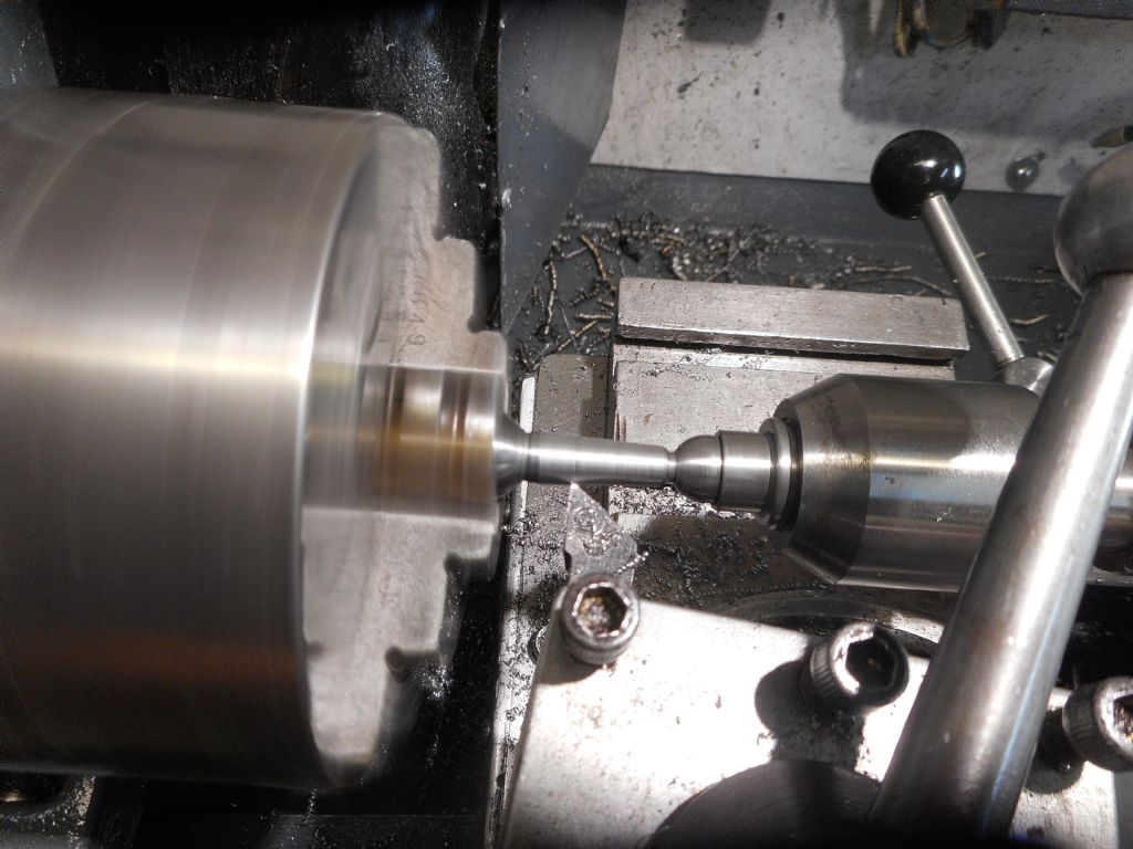

Then it was out with the diabolically primitive ball turning tool. I use a drill bit to set the tip of the toolbit the correct distance from the pivot centre. I know the pin sticking up the middle of the pivot bolt is 1/8" diameter, so drill bit must be 1/16" smaller than the radius I want to cut. Crude but effective. Again, good enough for decorative ball handles but probably not if we were making tiny artificial hip joints for bandicoots.
The small ball is the first to get turned, after setting up the ball turner the same way as described above for the main handle ball. Balls is balls. Same principles apply regardless of size. We can see the lever handle starting to emerge from its hiding place inside that bit of 3/4" bar now.
Well, that was the easy bit. The small ball, sticking way out there away from the chuck. But then larger end proved more problematic. With the small bore and part of the shank gripped in the chuck, the ball tool did not have enough clearance before hitting the chuck. And for the life of me I could not remember how I got around this problem when I did the tiny little ball handles for the Versatile Dividing Head. But a bit of "thinking outside the box" (which is a dreadful cliche indicative of thinking way inside the box in itself. But don't tell the management types that.) and a very special high-clearance chuck was pressed into service.
Yes I could have just stuck it straight in the MT2 taper in the spindle, but a previous owner messed that all up and although I have stuck a reamer down there, it is still not quite right and I don't have a drawbar chuck. So to avoid chuck coming loose it was firmly clamped in the three-jaw, firmly to hold but not tight enough to crush it and stop it working properly.
So, now we have two balls (quiet in the back row there) and an oversized parallel shank. Getting close but no ceegar. That is the next challenge: how to hold this thing while turning the taper on to the shank.
Which requires the use of… The Secret Weapon.
Edited By Hopper on 10/04/2022 10:07:22
Edited By Hopper on 10/04/2022 10:12:06
The secret weapon, I finally remembered, was the reverse centre. Used to hold the small ball at the tailstock end while the large ball was held in the chuck with a bit of brass shim to protect it from scarring, having been already nicely polished up with a bit of emery paper while still easily "holdable".
The reverse centre was easily made by pulling the usual pointed centre out of a cheapo revolving centre that uses two ordinary ball bearings inside. I made the reverse centres with a shank turned to fit in the ball bearings. The larger one made to fit up to about 3/4" ball bearings had a hole drilled in the business end then the angle cut with a boring bar with the topslide set around to 30 degrees. The smaller one I just poked a large centre drill in there, one with a 7/16" shank. These centres are also handy for holding things like vintage motorbike generator armature spindles that are made with no centre hole. Also modern starter motor armatures when recutting the commutator.
BALL LEVER cont
After calculating the required topslide angle from the difference in the known diameters at each end of the taper and the length between the two, topslide was set around at 2.8 degrees, by eyeball on the graduations. The shank was then turned down parallel to the major diameter using the carriage, and then the topslide was brought into action to put on the taper. Took a bit of faffing about so the topslide handle did not foul the tailstock, requiring a bit more tool overhang than normal, but light cuts and all was good.
As I reduced the diameter, I could see the taper was approaching one of the pre-existing grooves faster than the other, so a slight adjustment of the topslide, just a little bump around, and it was spot on. Sometimes you have a win! So eventually the taper joined up the two grooves that were machined in the first stage of roughing out the blank.
Then a small round Swiss file about 1/*" diameter was used to blend the radius between the balls and the taper so it all looked nice and smooth. Bit of emery cloth work and it looks just like a bought 'un.
Very satisfying to see. I am very pleased with that. I don't know why but these ball handles just intrigue me. Well worth all the mucking about, for sure.

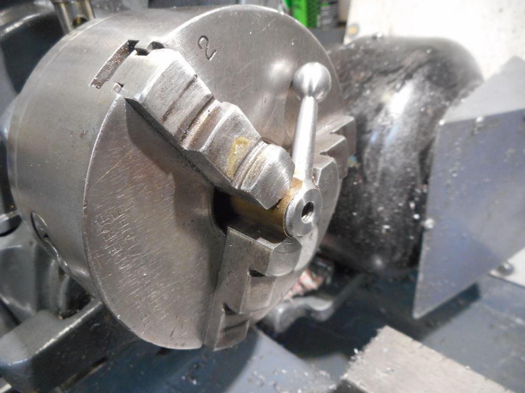

So next it was set up in the chuck ready to face a flat across the major ball, then drill and tap for 1/4" UNF so it can be attached to the locking stud. Old GH Thomas made special split stepped collars with cutouts for the handle to stick through for each sized handle he made. I am way too lazy for that so have always just held them in the chuck with a bit of brass shim for protection. Haven't had one come loose yet. And the biggest one I have done had a 7/16" BSF thread up the middle of it. Had to use the larger Drummond chuck for that one in order to get enough of an angle on the handle, but for these tiddlers, the Myford smaller chuck works just fine. A 15 degree offset seems to be ideal for most cases, but usually I just do it by eye as in the pic. Whatever works.
Edited By Hopper on 11/04/2022 09:58:58
Hole was drilled and tapped using the same method as for earlier parts, with crank handle and spring centre.

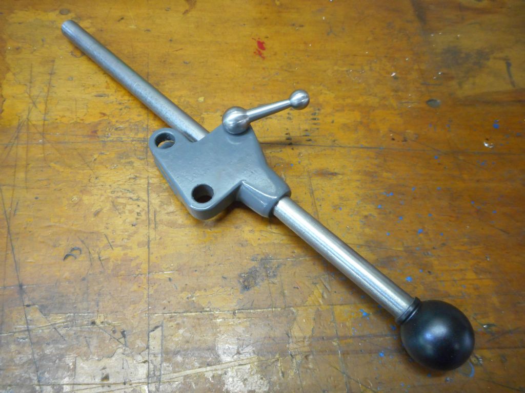

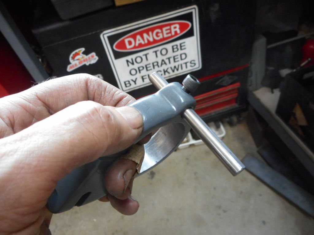

Now it really looks like something.
The head was cut off a socket head cap screw and the shank Loctited into the threaded hole. And that is that job done. Handle was fitted to the bracket ready for assembly when the pivot bolts are made.
Looks soooo much better than a modern Allen head cap screw doesn't it?
I'm quite chuffed with that.
Which brought me to the laast fiddly little bit before I make the three special pivot bolts and assemble the whole thing: the depth stop. I went with Noel's suggestion and upgraded my design from the early Myford style threaded rod stop to the later/Super 7 type, which is a piece of 5/16 rod with a clamping bolt. I used a piece of stainless rod out of an old printer to make. it.

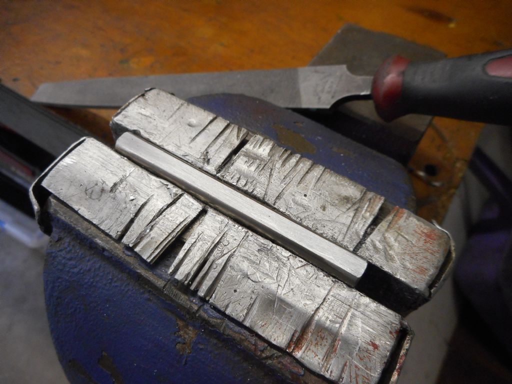

In the absence of a milling machine to put the flat along the bar for the lock screw, I did it the old fashioned way with a file. All those months I spent in the apprentice training centre filing blocks of steel flat and square within one thou to make G clamps and things finally paid off. I got the thickness along the rod well within one thou so haven't lost the touch. There was a slight half thou hump in the middle so I must have rocked the file somewhat. Need more practice!
So that was it. All put together and waiting now only on making those pivot bolts.

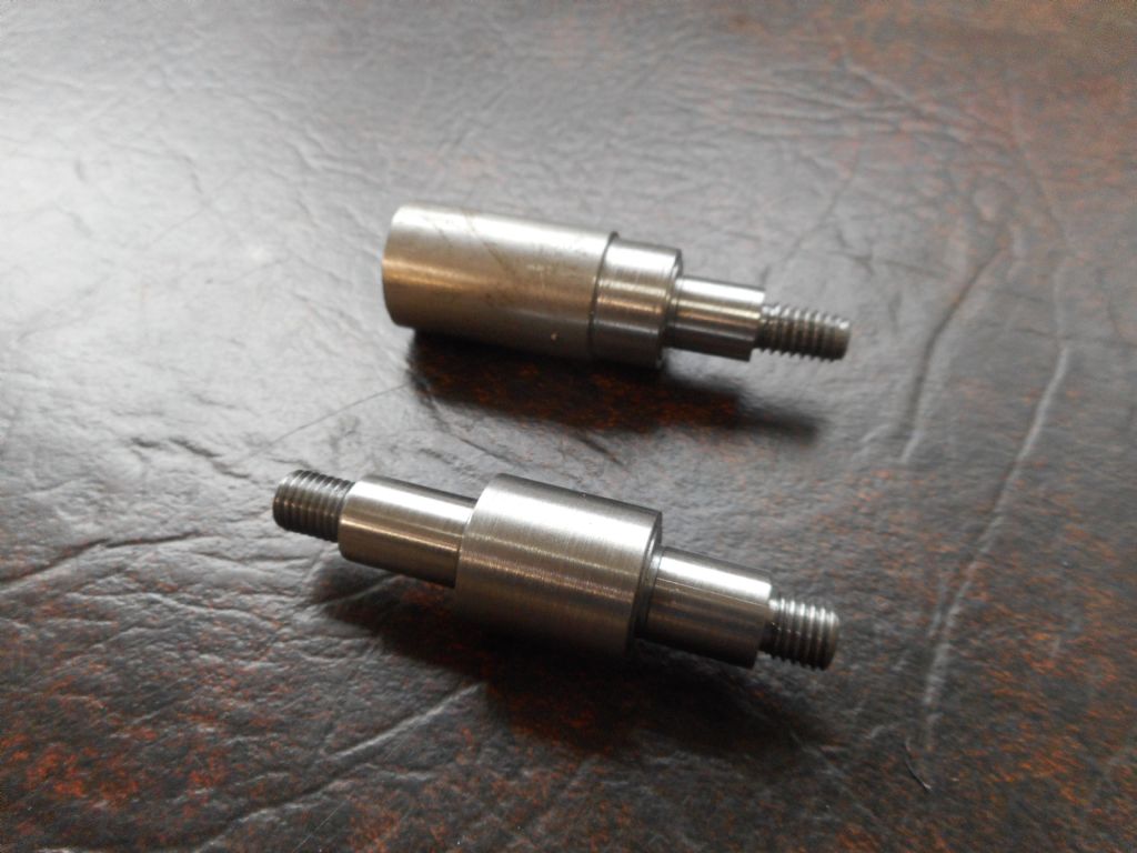

Little bit of progress today. Got the three blanks for the pivot bolts turned up, ready to add the hexagons when I set up the vertical slide on the ML7. I wouldn't make much of a production engineer. Three pivot bolts, all the same basic design, but three different shank lengths, three different thread lengths and two different thread pitches!
The bottom blank will make two pivot bolts after milling the hex in one go then parting off.
A couple of small details you can see on the bottom one there: I turned a step 1/64" thick under where the hex hed will be made. This is 10 thou smaller than the AF dimension of the hex. So when you do the bolt up, with no washer under the head, the points of the hex do not scar up the paint. So it is sort of a built-in washer. Plus to make sure the bolts seat on the shoulders, I turned a small groove to just below thread depth at the end of the thread before threading it. You can never get a die to cut a thread fully up to a shoulder, and I want the shoulder to come firm up against its mating surface so the groove solves the problem. Chamfering the hole would also solve the problem. But that would be too easy wouldn't it? I also cut a small groove under the head of the bolt so it mates up flat with its surface. Overkill maybe but nice to know it's all sitting just so after all this work.
So, next trick will be milling the BS hexagons on these UNF bolts with 11mm metric shanks without using a dividing head or indexer, a trick I based on something I learned from an Indonesian YouTube machinist called Mekanik Mesin, an absolute genius of "git 'er done" when you have much nothing to do 'er with.

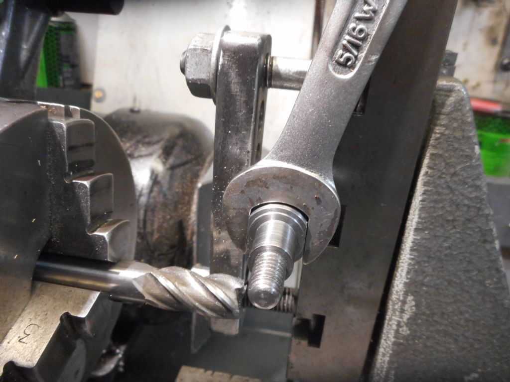

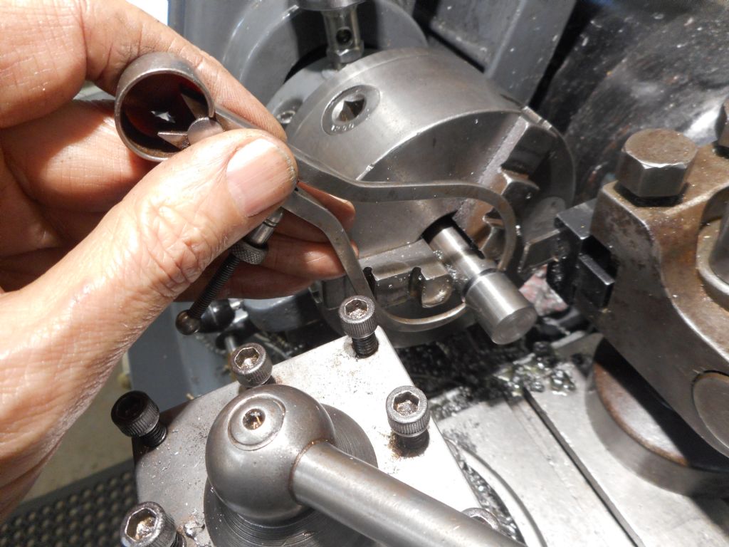

Milling BS Hexagons in the Lathe
This little exercise is a good example of how if you have more time than money, or sense, you can do almost anything with almost nothing.

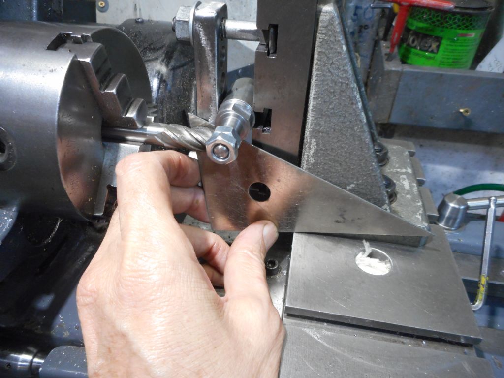

The problem: To mill 5/16 BS sized hexagons on to the three pivot bolts.
The gear: I am still saving up for that Sieg SX3 milling machine, so no mill. I do have a GH Thomas Versatile Dividing Head, but it really is too big to fit in the Myford or on the vertical slide and with a chuck mounted on it, overhang is riduculously unstable, and the vertical slide makes it worse. Plus you can't get it below centre height on the lathe which makes things even more awkward. So scratch the VDH. Until I can get around to making the badly needed collet set that fits up inside the spindle to give no overhang at least.
The Method
So, the "temporary" method I have used before and pressed into service yet once again is to clamp the job to the vertical slide using a T slot to hold and locate the round job, a sort of jury rigged V block effect. Then start off by milling one flat to full depth, ie job OD minus the hexagon AF divided by 2. Then once the first flat is milled, I turn the job around 180 deg and use a try square to set that flat dead vertical again on the other side.
Note that the try square stock is held firmly against the small flat on the job and the long blade used to see when things are sqaure to the cross slide surface. Any error at the flat is very small this way. If you just plonk the square down on the cross slide in the obvious way, then try to align that tiny flat on the job to the square, error will be much greater.
Any how, second cut was successfully made and checked with a spanner for fit all good. The standard dimension for a BSW 5/16 hexagon across the flats is a nice round, logical, easy to remember .601". Apparently Mr Whitworth based his hexagon dimensions on whatever size across the POINTS fitted into the limited range of round bar black bar available, after the OD had been machined down to clean off the mill scale and inconsistencies. So there perhaps was once some method in the madness. But I can't find a reference for that story…
So that was the easy first two parallel flats done. As usual set up time was ten times actual machining time, and it got worse after this.

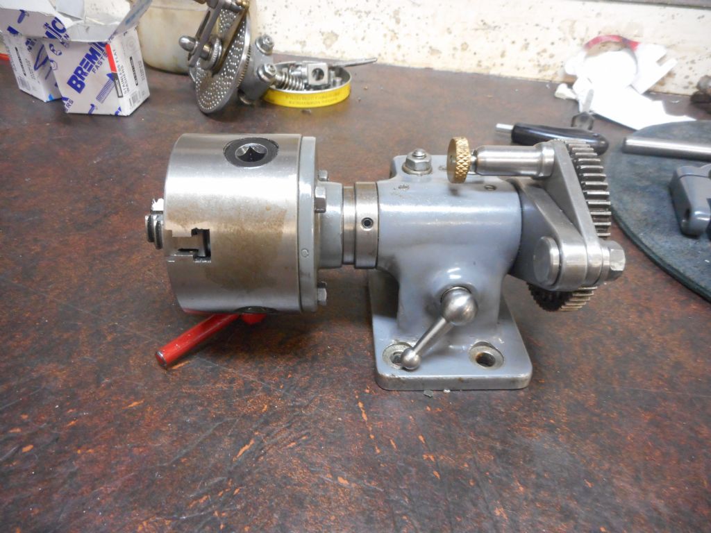

Milling Hexagons in the Lathe, cont.
Indexing

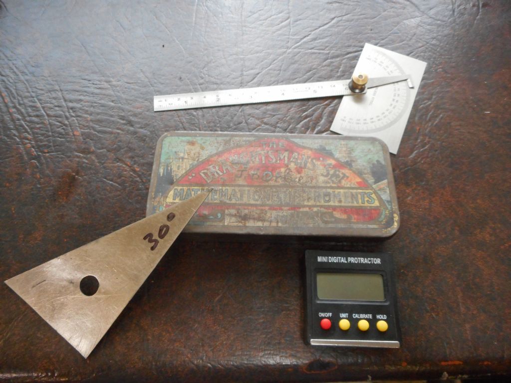

To set the angles for the rest of the hex, I had a choice of equipment:
A protractor and my uncle's old 1940s apprenticeship draughting kit, including metal set square with the needed 30 degree angle. I have used this a number of times before with success but it can be fiddly to fit in around the job and the cutter and the chuck and so on. Or, dragged kicking and screaming into the 21st century I lashed out $20 on a magnetic digital protractor that can be set to zero to match the cross slide surface. It's just like having CNC! Almost
The more recent stainless protractor at the top was scratched as too easily moved out of position during the wrangling it in and out of the job space.
And the easy-to-use set square just would not fit in this job situation. Trying to line up the tiny flat on the job with the set square just could not happen. Interference issues in every direction I tried to move. It's a doddle with large 1" AF hexes etc but not this one. I put the two nuts locked onto the end of the job so I could use a spanner to finely rotate the blank to the desired position. That part worked really well.

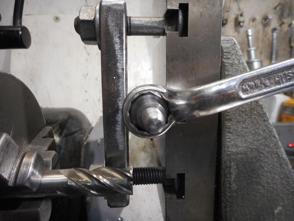

So it was out with the digital protractor.
A tiny movement of the spanner at the end gave movement of the job in the region of one tenth of a degree. So I did finally get it set to 30.00 degrees. Not that it is very critical in this case. While the flats are specced at .601" AF, the spanner I have range from .610 to .619 across the jaws so plenty of slack to take up any errors. And measuring a few mass produced 5/16 BS nuts and bolts revealed they vary from .585 to .605 AF. Production tolerances, not toolmaker's tolerances. So that allowed me to mill the next flat. And then on with the same to do the next. The magnet in the digital protractor was not strong enough to grip the small flat, so a bit of careful finger pressure was required to hold it steady. Don't think I will be asking for my $20 back though. It still worked a treat.
And repeat until all six flats were finished.
And result! A ring spanner slips on like a glove, despite my dodgy methodology. ( I actually cheated and made the hex .608" AF so my spanner is a very nice neat fit without too much slop. This is not a mass produced fastener!) I am very please with that.

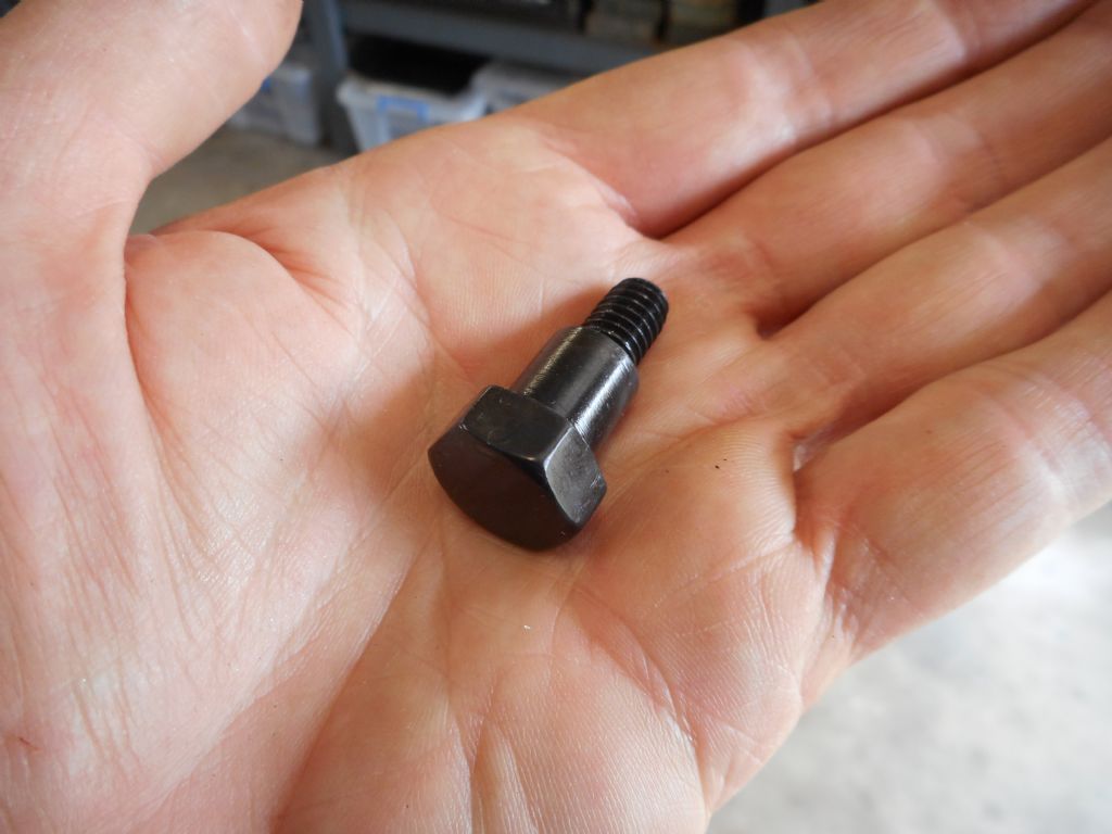

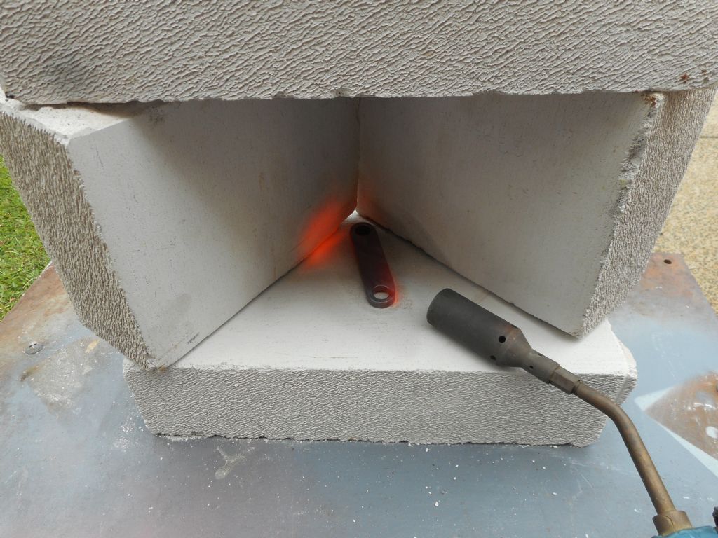

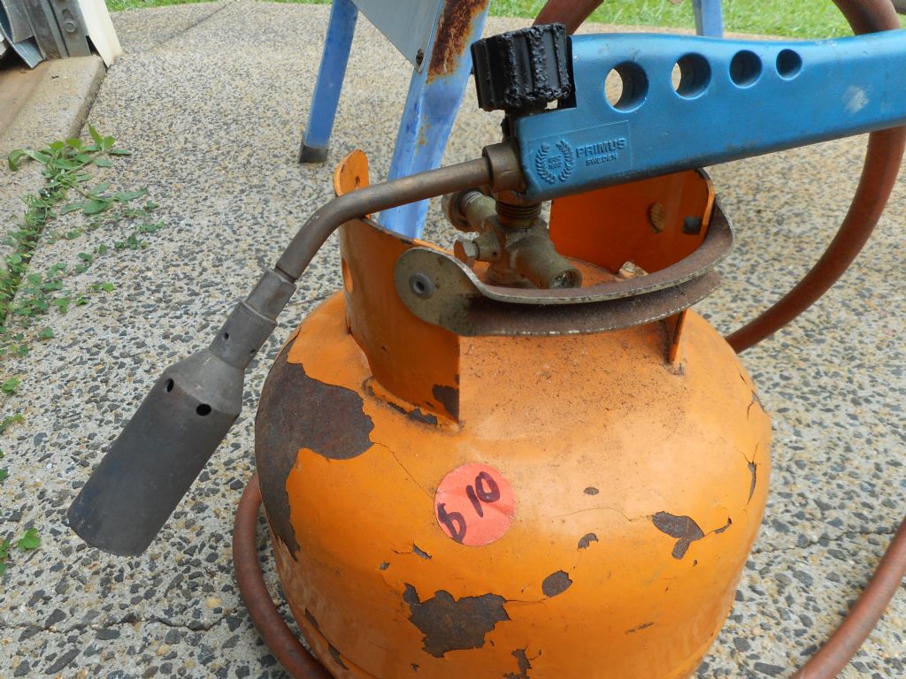

Got the three pivot bolts done and dusted. To finish them off nicely, I oil-blackened them. Quite pleased with the way they came up.
OIl blackening was done by heating them up until they turned black or a very dull red, then dropped into a tin of unused motor oil. I made a little hearth for the heating process. Tin of oil was kept well away on another bench, with fire extinguisher to hand.
The hearth was made from AAC blocks, which I have not used before. They are Autoclaved Aerated Concrete and cost about $5 each from our local hardware store. Living in the tropics where nobody has fireplaces or furnaces, proper firebricks or refractory blocks simply are not available. These seem to work really well though.
I was worried they might snap crackle and pop under the heat of the torch, so wore my best safety glasses and kept my face out of there as much as i could. But as you can see, the block can glow red hot without any dramas. And you can hold your hand on the other side of the block, so not much heat being wasted heating up the block as happens with solid firebricks. It only took a minute or two to get each bolt and the link glowing dull red. Another minute or two and they would have been cherry. But no need for that hot for simple blacking.
Cutting the blocks in half to make the hearth was dead simple. Scored a line around the circumference with the point of a chisel, just held by hand and dragged. Then whacked on the line with hammer and chisel once and the block split perectly along the line. Very handy. The blocks are very light, sort of like styrofoam or meringue made from concrete.Must be 90 per cent air or so. They are used in buildings for fire safety insulation between sections, thermal insulation in general, and sold locally for building barbecues from.
That little propane torch is the best $10 I ever spent at a garage sale. And it came with a full bottle of gas, which so far has lasted about 10 years. Obviously I don't use it much but when I do, it is worth its weight in gold. Handy for heating motorbike alloy casings to get bearings in and out, or for hardening and tempering silver steel components such as the axles on the knurling tool I made some time ago. A little bit of gas seems to go a very long way.
