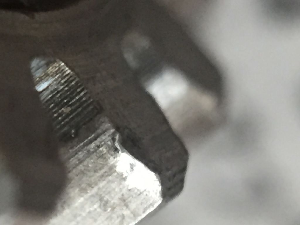

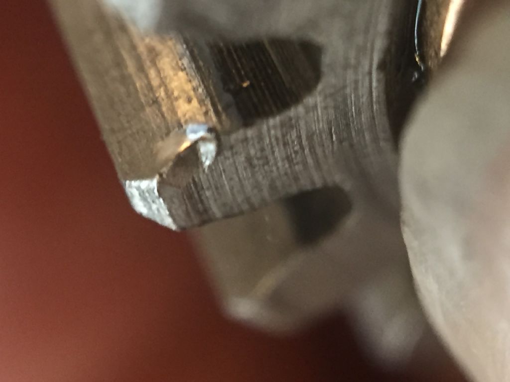

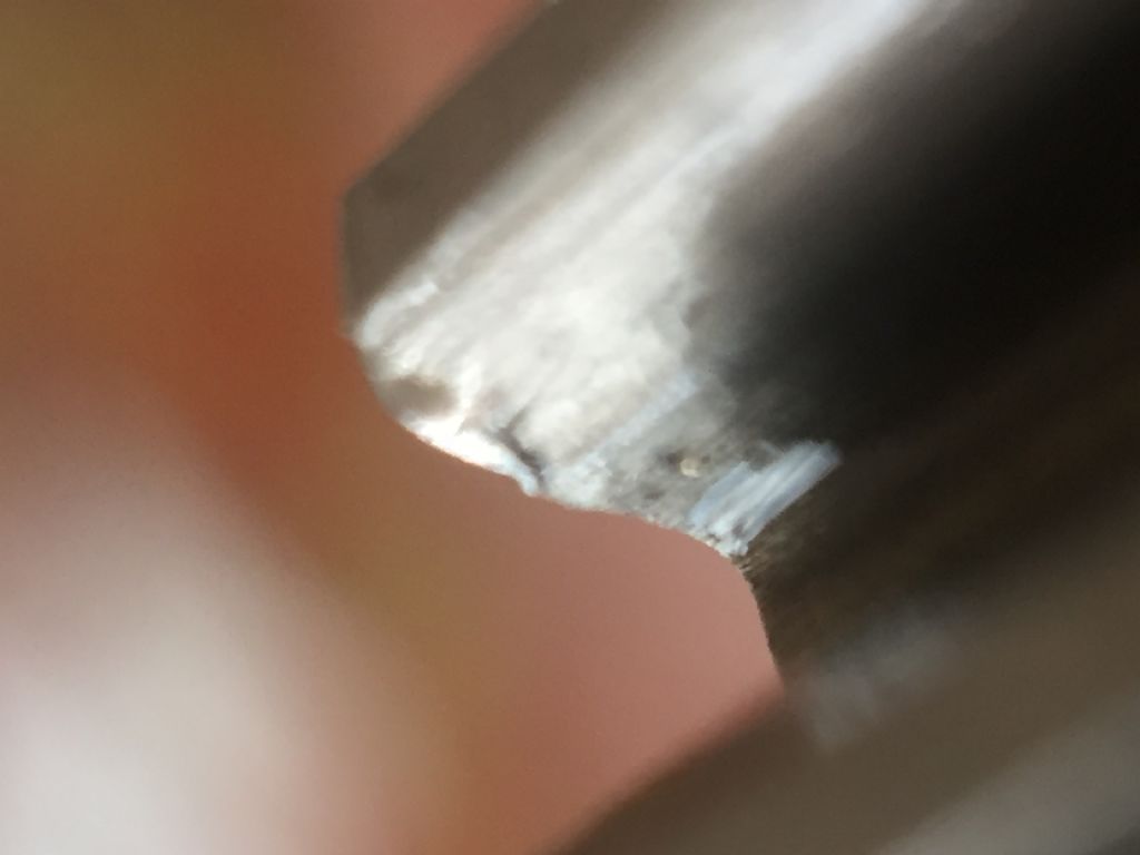

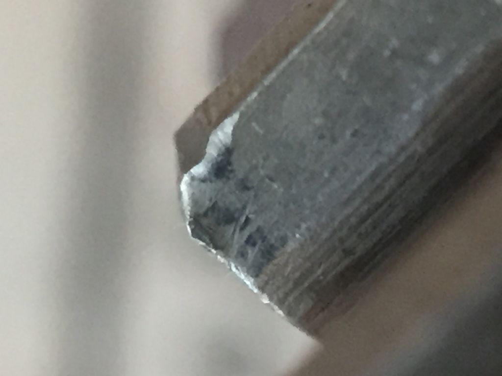

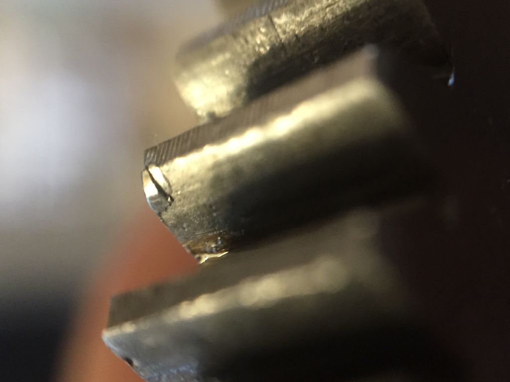

        When turning my Super 7 lead screw by hand I noticed the quick change gearbox was making lots of chatter and cyclic ticking noises, and on inspection found a number of dings on the gear teeth both inside and outside of the box which I filed off with a fine grain diamond needle file, washed them in WD40, and bingo! quiet box.
        Happy at this I then set the meshing of the quadrant gears, and was turning the chuck by hand to listen to the outer drive train, when a tooth came off one of the Tufnal gears! which I either put down to fatigue or a historic event.
        But my Tufnal gears don't have any grain in them and I don't know if this means they are old or third party gears? and thought Tufnal was like it's name tough?

          Looks like someone in the past has been changing gears with the motor/spindle running and gear train moving. Tsk Tsk. Tufnol may be tough but it's still the weak point in a train of iron/steel gears, which is not a bad thing if it saves the other gears from major damage.

              I think Hopper's analysis of gear-changing whilst moving could be correct; it doesn't look like foreign object ingress to me.
              Tufnol gears are original and are there to reduce the noise of the gear train as well as provide an easily-changed (but expensive) weak link in the gearing. RDG Myford still sell the gears, but I think third parties also sell them in Nylon and other similar materials.
