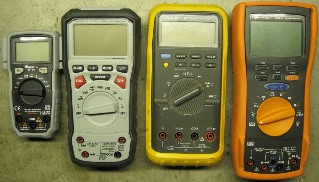

The two left meters are MusTool left was $9.00, 2nd from left was $18.00
Both work very well, I use them in the workshop, on 4×4 trips, etc. third from left is the venerable FLuke 87, this one now 26 years old and working as new. Next was my gift to me to replace the Fluke 87, a Keysight 5-1/2 digit meter – Very good at measuring, can record to a PC, etc – was $604.00 (!).
However, this was a bad buy -the Keysight display is crappy, not clear, hard to read in day without the backlight on(!!), the knob has a very uncomfortable rotational backlash which results in one not being sure if the required selection in made or not.. I use it for the more exacting tasks – measuring and computing ampere-hours for very low power wildlife tracking collars and so on. The Fluke and the Keysight unit are in the electronics lab all the time, and nine out of ten times I'll go for the Fluke. I could not physically view the Keysight unit when I purchased, went on reviews and made a mistake in purchasing it. I should have gone for the later Flukes (s). So price is not all – The only downside I found to the two cheapies shown here is the display update time is long – maybe 1 to 2 sec, and autorange time is irritatingly long – up to 4 seconds…The Fluke is less than 1 sec, the Keysight not noticeable.
Measuring +12V on each unit showed ( left to right) 11.88v , 11.9v, 12.01v, 12,002v
Current measurements showed:
0.5amps: left to right – 0.25A , 0.48A, 0.511A, 0.505, 0.5007A
1Amps : 0.98A , 0.97A, 0.99A, 1.0008A
10Amps : 9.77A, 9.89A, 9.98A, 9.9997A
So I think The Cheapies are just fine, except for the sub 0.5A anomaly of the left meter..

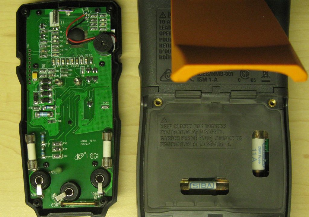

Fuse setup of the cheapest versus the costly meter..
Given the lesson, and what Fluke has done for me over the last 1/3 of a lifetime, I would try find a FLuke…

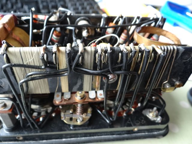

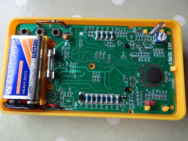

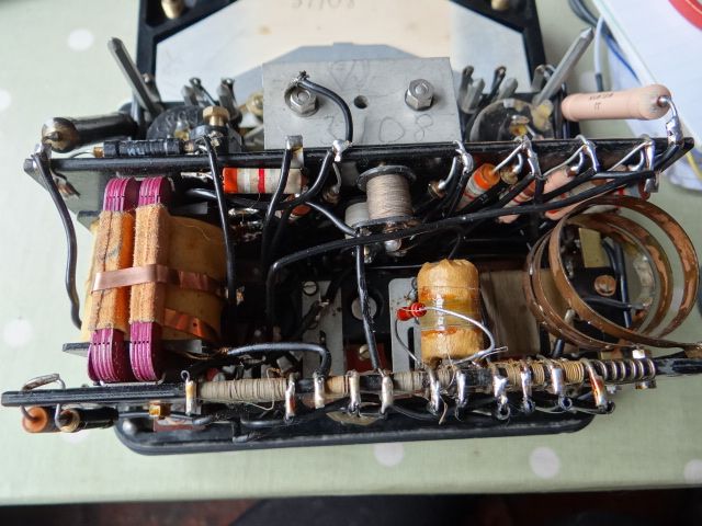

Rather than theorise about 'quality' here's photos of the insides of an AVO8 (Model B) and an inexpensive Maplin Digital.
The AVO movement and electronics are mounted on a thick plastic front panel backed by a heavy steel box, not waterproof. The electronics are hand assembled from separate components of basic type: wire-round resistors, bent springs, open switches, the whole being much exposed. The construction style is a century plus old, and was pretty sensible because the unreliable components of the day often needed repair. (My meter has a few old repairs.) This type of construction is semi-skilled, labour intensive, and extremely expensive: much of the customers money went on wages, not 'quality'. In 1953, an AVO 8 plus leather carry case cost the equivalent of about £700: only an exceptionally wealthy amateur could afford a new one.
The Maplin meter was built using modern mass-production techniques. Few humans involved: most likely the SMD components were automatically placed on the board by a machine and wave-soldered in the blink of an eye.
The meter's brains are in the Integrated Circuit far right in the photo. The electronics are far more complex than those in the AVO, and also far cheaper. Once designed and debugged the IC can be sold in volume for less than a pound. The other components are also mass produced far more cheaply that their 1950's equivalents. The AVO has a seriously pricey high-end D'Arsonval movement; the modern meter has a Liquid Crystal Display costing a few pence.
Not much difference between brands or models when inexpensive meters are mass produced in this way; the old-fashioned notion of quality that applied to my 1950's AVO don't apply to this class of consumer electronics. It's quite hard to make duds provided the meter isn't too cheap. But beware buying manufacturer rejects, customer returns, and damaged goods from unknown purveyors on the web.

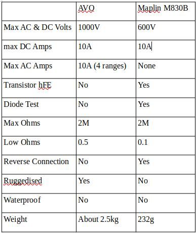

Otherwise think about Requirements! Comparing my similar examples:
If carrying the meter in a pocket is important, don't buy an AVO! If AC current is wanted, don't buy the Maplin. If safety is important, don't buy either!!!
