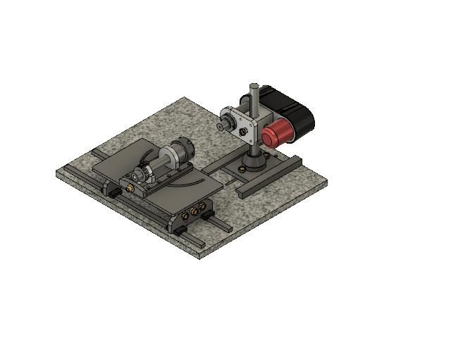

                        I use Fusion 360, and do the opposite; top down, where each part is modelled in place which leads to one complete thing per file
                        That does require careful use of components, but you should do that anyway, and I find it much easier than trying to join up lots of separate parts. You also have to consider the 10 editable parts restriction on free Fusion use.

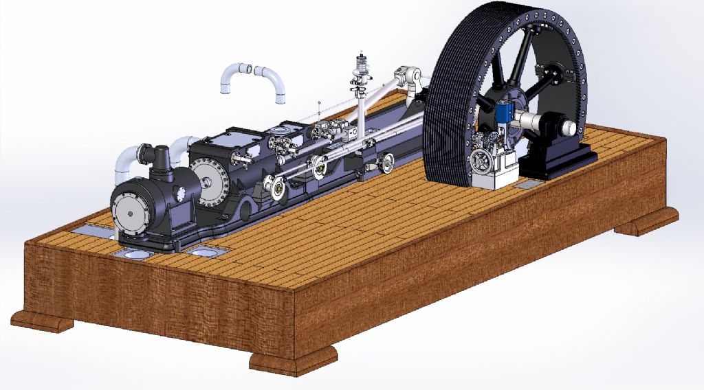

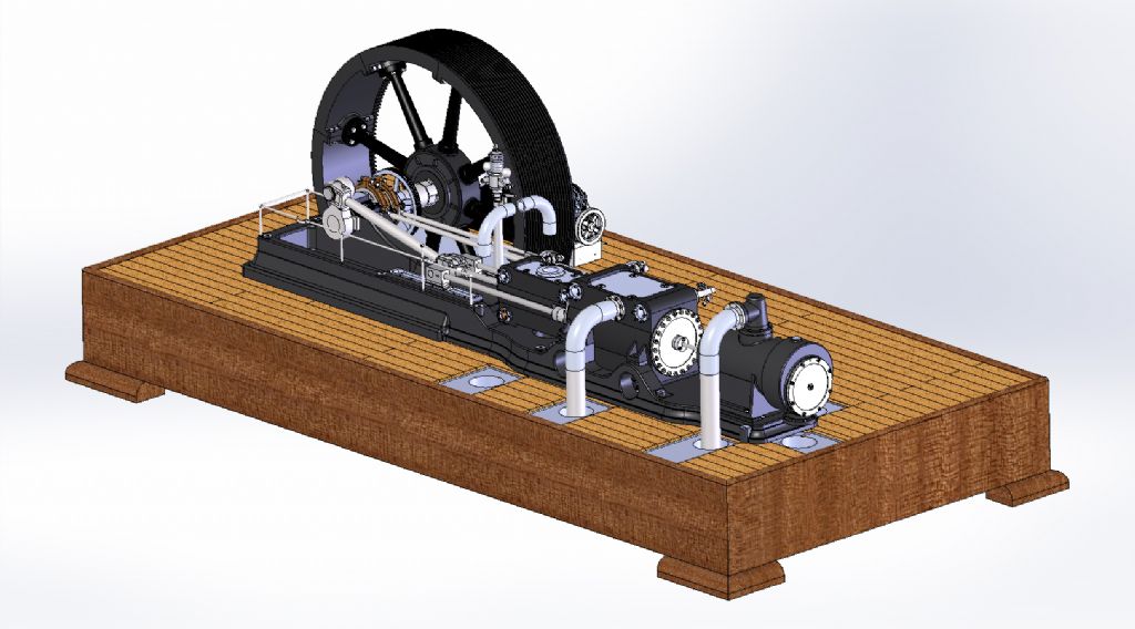

                          In Solidworks everything gets an individual identity right down to the last nuts and bolts, then these items can be brought together into assemblies and sub assemblies again each assembly has its own identity.
                          This is very important when you need to make design changes and record them with drawing revisions etc.
                          I am talking about industrial use with the above comments, but I use it at home as well for my model engineering, and keep to the same principles, the only difference being that at home I dont use a dedicated document manager software like we do at work, but I keep everything organised in windows explorer folders.

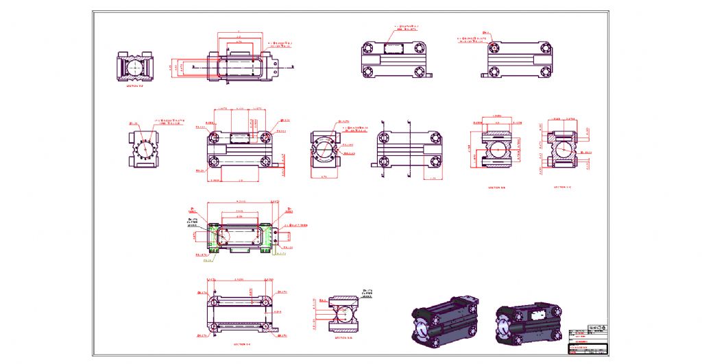

                          I print one drawing per part for manufacturing purposes, I only have A4 at home so that works best for me.
                          Here is a couple of images of my mill engine in designed Solidworks, as it currently looks.
                          Phil

                          This is a work in progress drawing of the high pressure cylinder, but this is on a much larger sheet and I need to print it at work using our plotter.

                                    This all dramatically reduces the skills that a designer needs to create complex and/or multi-part objects from scratch. Creating a 2D drawing is then a simple operation if it's even needed at all; many parts can be made on manual machines from the information directly available from the 3D model.
                                    I had an hour a week of Technical Drawing when I was 13, 37 years ago. That leaves me able to read a drawing, but designing parts in 2D would take me months of instruction, practice and frustration before I ended up with something usable. This model is completely dimensioned, animated with all the clearances worked out over a couple of evenings:
                                    It means that the flat parts can be laser cut from the model, thus saving even more time.

                                                  The grinder I showed is intended to be compact and made out of simple sections with as little work as I could get away with. The spindle is mostly from published drawings. None of the things I've shown have had any visual finishing applied to them as it requires lots of faffing about with lighting, shadows and other artistic judgements that are of no use or interest me.
                                                  I don't care about parts; finished assemblies are what matter. Drawings, 3D models, sectional views, combinations of all of those or even scratchings on a dirt floor are just as much steps on the way to that as rooting through a pile of stock then milling the curved slots for a tilt 'mechanism.' It's all just work that should be done in as an efficient way as possible.
