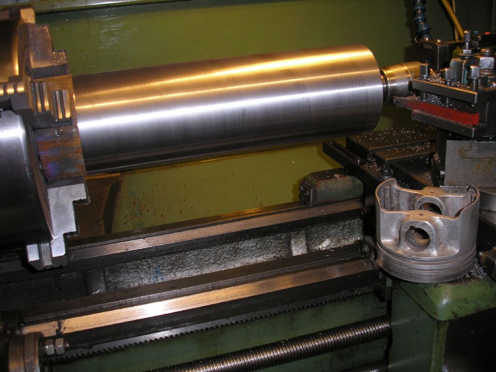

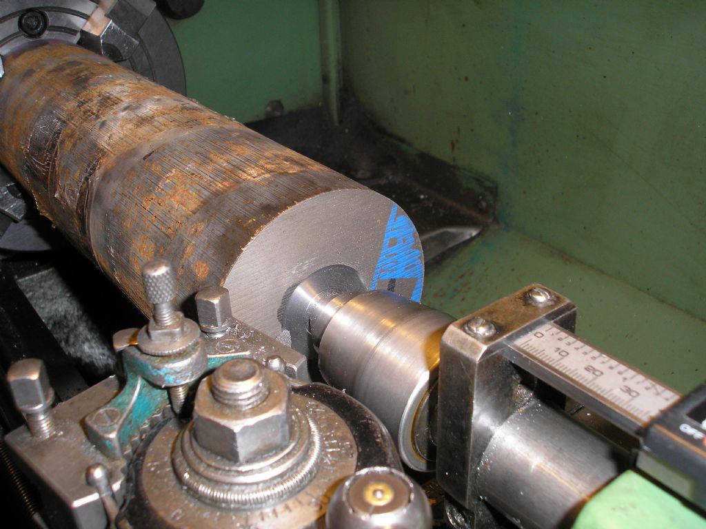

A PEEMS club member kindly picked up a 90mmØ piece of ductile iron for my pistons from M-Machine and another member brought it to my workshop.
I got a price for an 84mm Dykes piston ring today £40.63 I will be making my own now.
I have many articles on making model rings by various model engineers I wonder making an 84mØ Dykes if there is anything I should be careful about when heat treating a large ring using model ring methods?
Will order a blank from Westwood Liners they have centrifugal grey and ductile iron castings.
This will be used for rings and cylinder I saw Allen Millard using a Westwood blank for his replica 347cc 6 cylinder Honda.
