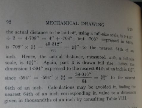

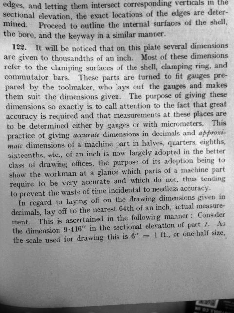

          #265104
            My old book (ICS Geometrical Drawing Mechanical Drawing Sketching Projections Development of Surfaces, London 1907) gives the following advice, which is consistent with earlier posts.
            This drawing (part of a commutator) is an example of mixed fractional and decimal dimensioning:
            Of interest is that decimal dimensions omit zeros before the decimal point, i.e. .063" rather than 0.063"
            Here's the text (from 122 onwards) :
            Fans of imperial fractions may note the very last sentence. It addresses a disadvantage of that system. Extra calculations are needed to convert thousandths into 64ths and use of a table is recommended to avoid doing them.
            I have a 1947 book that pretty much repeats the same advice about dimensioning. Does anyone know when fractions in drawings were phased out in favour of decimal inches?

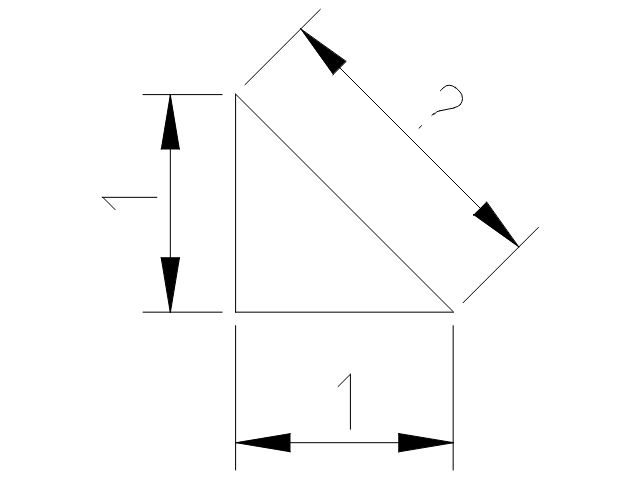

                              Clive, I'm afraid you're going to have to explain the absurdity of your 5 miles example again, as I can't see how 11.45km is even remotely complicated? Whereas converting the mixed imperial units into one number to get that 11.45km was a pain.
                              #265169
                                Posted by Clive Foster on 06/11/2016 19:17:36:
                                Fractions are exact by design.
                                Clive.
                                To their amazement the ancient Greeks came unstuck with that notion when they tried to solve this simple example. Given a right-angled triangle with two sides of length 1, what is the length of the diagonal expressed as a fraction?
                                Fractions are an excellent tool but they also have serious limitations. I'm not suggesting decimals are perfect but they are considerably more general.
