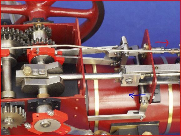

        I bought a part made Minnie traction engine from a local dealer and they also supplied the boiler (which looks professionally stamped) I came to try the shafts and other parts including the hornplates. I was unpleasantly surprised to find that the boiler is too long, hence one drive shaft is fouling the backhead. After pondering what could be done I hit upon moving the mounting holes on the hornplates. This means that that parts such as the eccentrics and the main drive need to be made longer to compensate. Just wondered if anyone else has come across such a problem? At first I was going to make a new set of hornplates with the drive shaft holes moved, but realised that this was not as easy. Any helpful comments accepted

          Moving the hornplates is probably teh easiesty option, just need new conrod, eccentric rods and pump rod unless the thickening pads have also been placed too far back in which case you may get away with it.

              Assuming we're talking Stephenson's gear, if you change the length of the eccentric rods without changing the expansion link to suit you will get strange valve events. You could try altering the suspension of the expansion link to move that back, so not shortening the eccentric rods

                  Thanks for the input Duncan. I take your point and I think I will assemble the motion with the original eccentrics. We are only talking of a 1/8th of an inch (at maximum) alteration ( The amount the hornplates, or rather the mounting holes) have been moved backwards to stop a gearshaft touching the rear of the boiler. Would your suggestion altering the suspension just mean increasing the length of the valve rod?
                  #244060
                    You would need to make the two blocks that support the weighshat longer as that would move the all teh links etc backwards and then extend teh valve rod though its possible there may be a bit of adjustment by screwing teh valve rod out of teh valve slide and also moving teh valve nut on the rod.

                      Without seeing the actual drawings, I'd go with Jason's answer

                          Duncan, a picture may be better. Extend the two blocks shown by the blue arrow which will move the whole assembly back to suit the length of the rods. Then extend the valve rod shown by the blue arrow either by screwing it out or if needed make a longer one.
                          Less work than new eccentricssmiley

                              Jason, that works. Might need slide bars lengthening as well, looks like crosshead already part way off at back centre.
