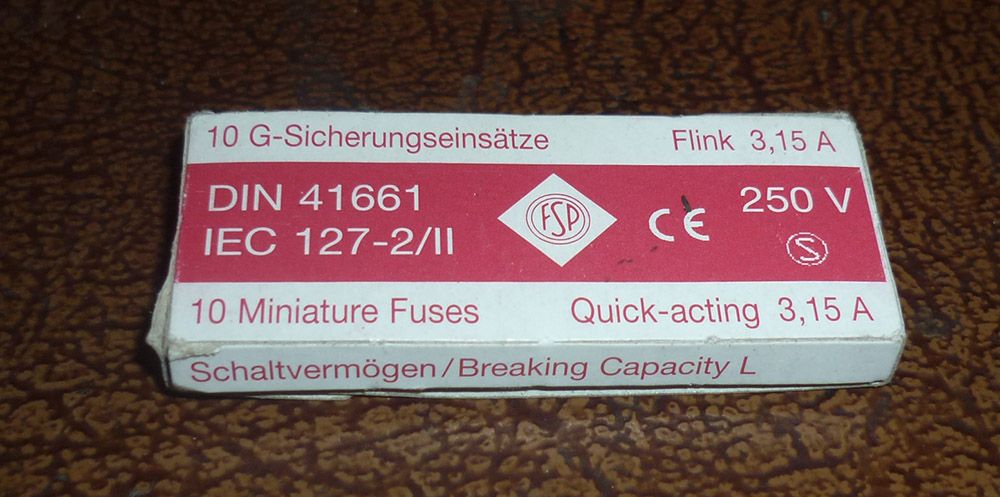

                mark smith 20
                  @marksmith20
                  I used to have a Chester Conquest it used these fuses. I thought most of these mini lathes were the same but theres obviously a big difference in the electronics. these were 3.15A  quick acting and only 5×20 size.p1280973.jpg
                  Edited By mark smith 20 on 01/07/2016 18:33:12
