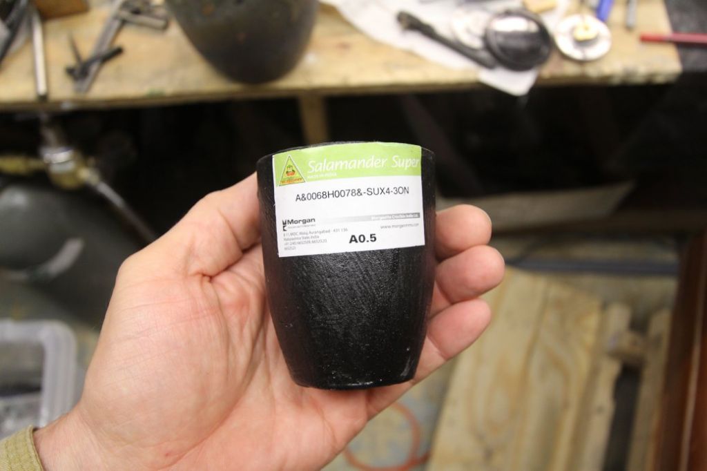

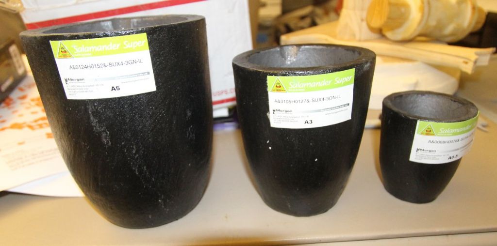

      I built an iron furnace a few years ago, and it will melt up to perhaps an A30 crucible full of gray iron, which is about 60-70 lbs of iron.
      I generally operate it with an A10, pouring maybe 25 lbs of iron at a time.
      I have been looking at making some lead-free bearing bronze, and I don't really want to fire up the big furnace to do that.
      I have always wanted a mini iron furnace that would be easier to use for small pours of bronze and iron, and after pondering over exactly what size I should build for years, I have finally started building a mini furnace.
      The crucible range of sizes that would work with this furnace would be between an A0.5 at the smallest, and a somewhat tight fitting A5.
      I use Morgan Salamander-Super clay graphite crucibles, and they come in all sizes.
      I think an A4 will be an ideal size for this furnace.
      Edited By PatJ on 30/06/2022 07:03:21

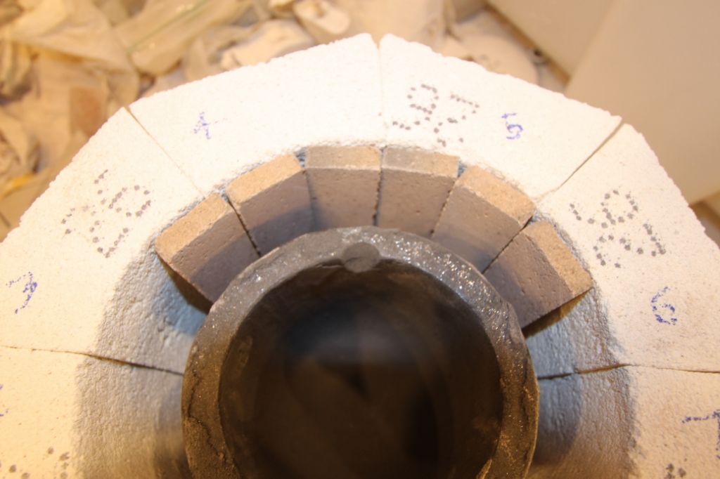

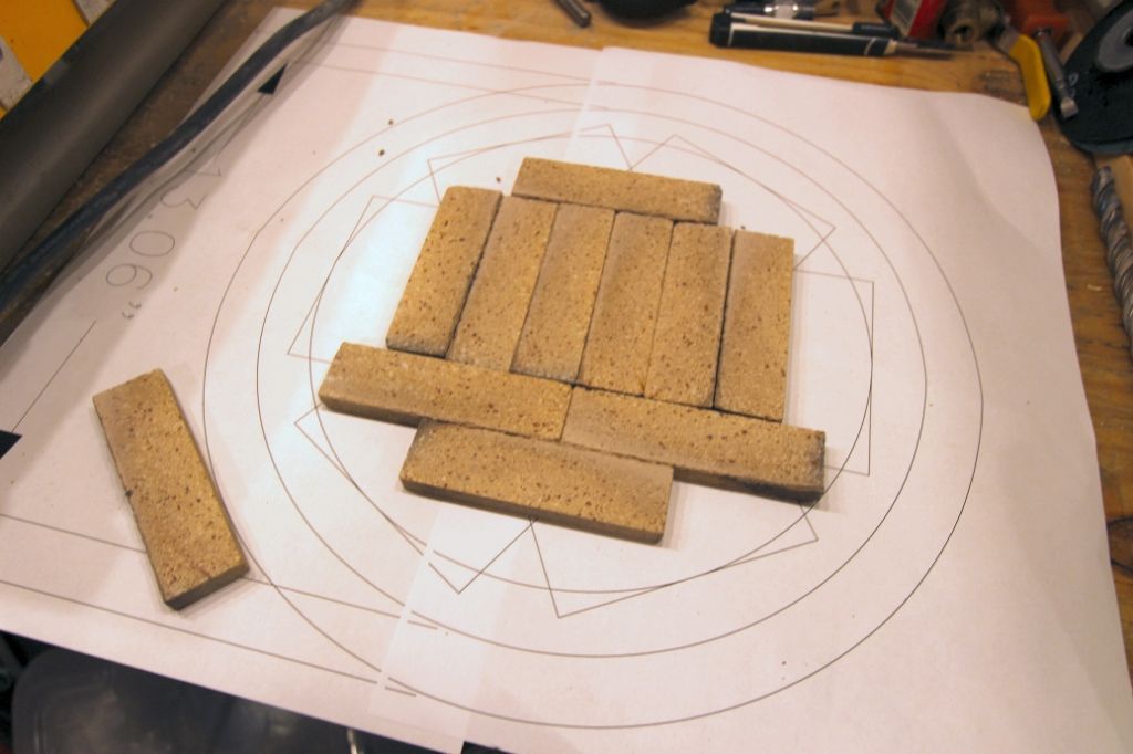

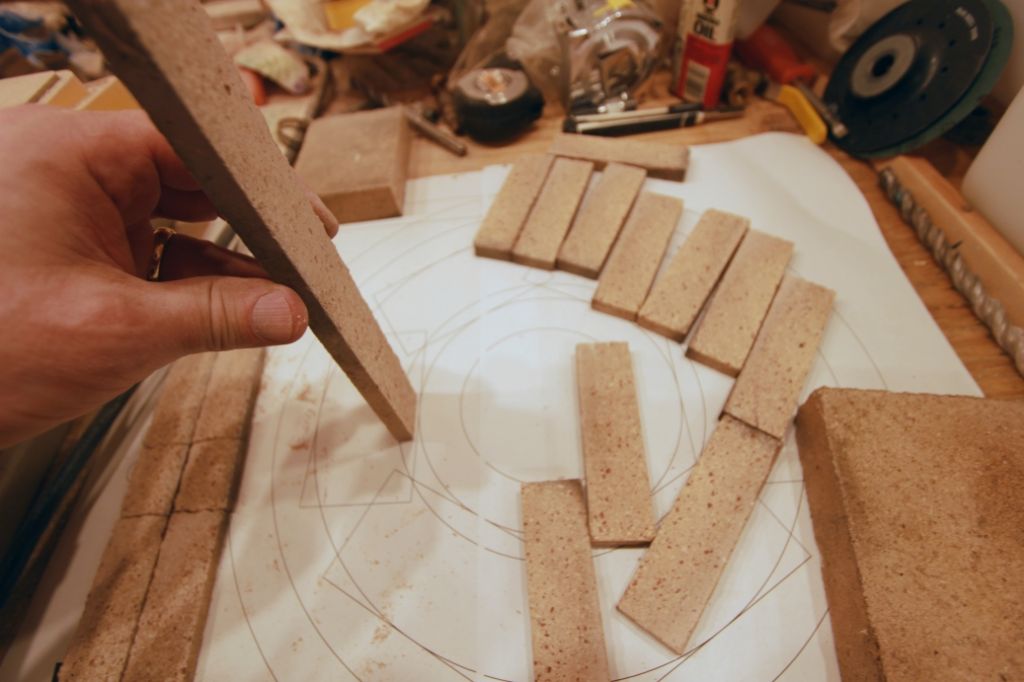

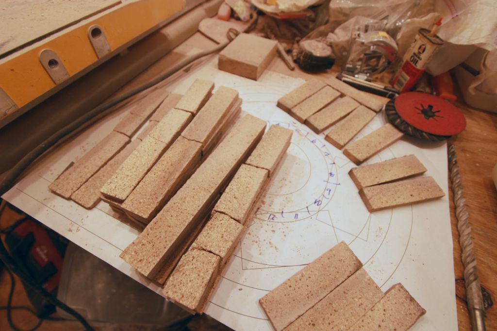

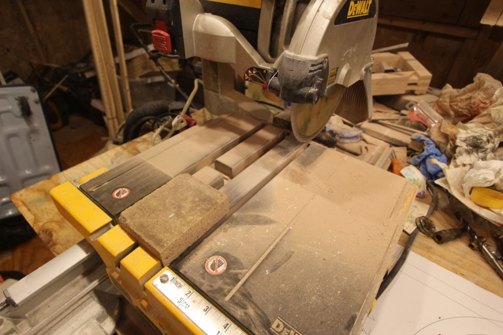

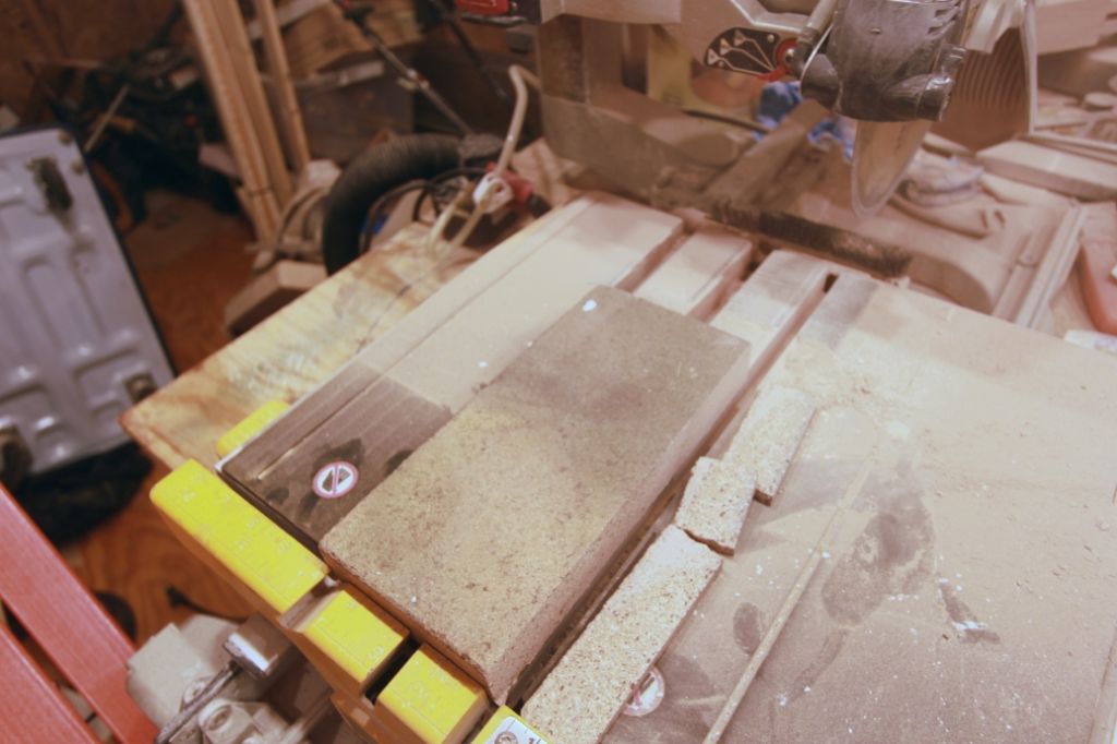

          In order to keep material costs as low as possible, I am trying to build this entire furnace using the materials I have on hand in the shop.

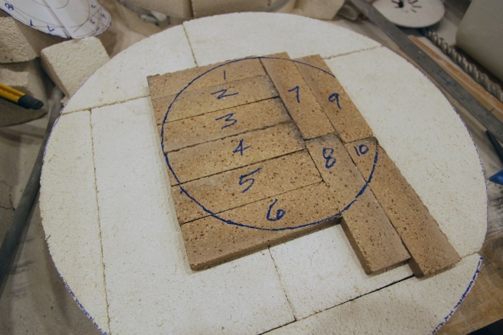

          I am having to get creative with the hot face, which needs to withstand iron temperatures which will be continuous 2,900 F rated.
          I have some hard fire bricks, which stand up to iron temperatures quite well, and so I am cutting up strips for a hot face veneer.
          I have a wet saw, and the cutting went pretty well (using a commercial-grade respirator).
          A few of the strips broke into two or three pieces, but I have some plastic refractory that is rated 3,800 F, that is good about gluing hot faces together.
          If I had enough plastic refractory (which I don't), I would make the entire 3/8" thick hot face using that material.
          I added tile flooring to several rooms in a relative's house a few years ago, and so I have gotten good with a tile saw.

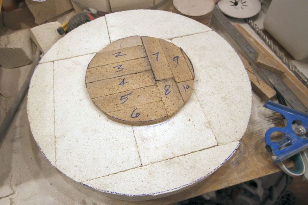

          The lighter color bricks are insulating fire bricks rated at 2,600 F.
          The insulating bricks will not stand up to iron temperatures, at least not the 2,600 F rated ones, but the hot face will protect them.
          The insulating fire bricks are soft and easy to cut with a hand saw.
          The hard fire bricks have to be cut with a wet masonry saw.

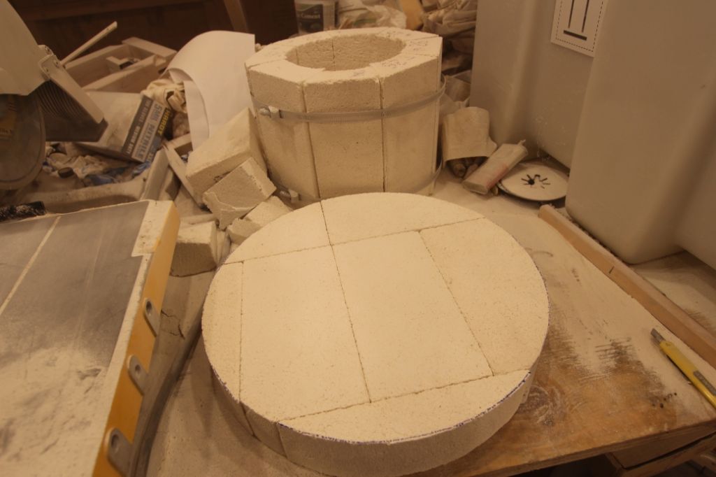

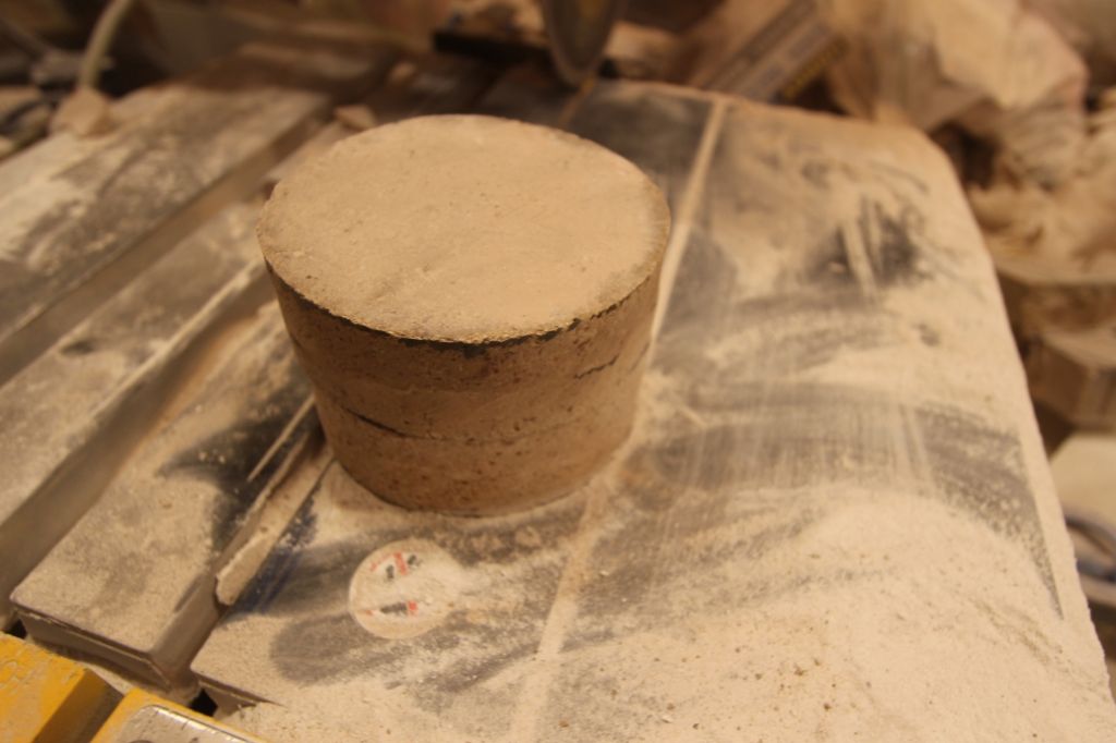

          The plinth (the platform that the crucible sits on) is made from two pieces of 1" thick hard fire brick.
          Edited By PatJ on 30/06/2022 07:07:28

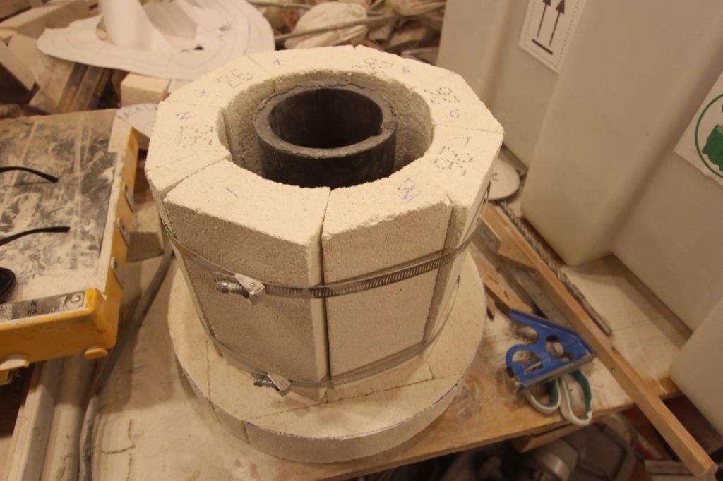

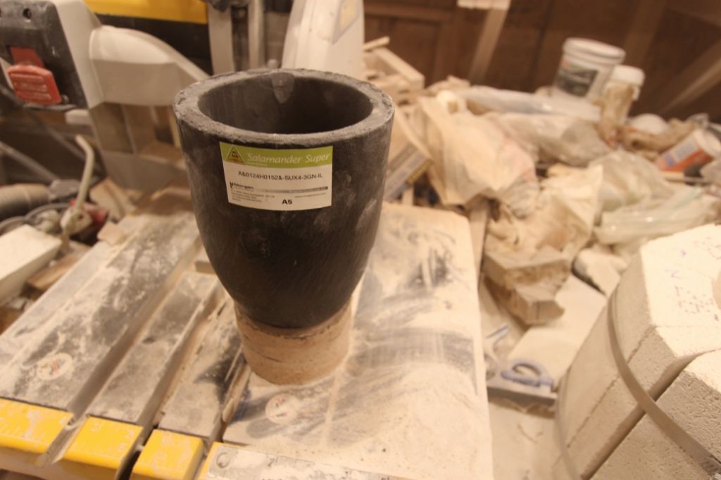

            The hot face veneer is 3/8" thick, and it is not shown in this photo.
            I think an A4 will be the ideal crucible size for this furnace, which will hold perhaps 8-10 lbs of bronze.
            I will wrap two layers of 1" ceramic blanket around this furnace, so that the exterior will operate cool to the touch.
            The outer shell will be an old hot water heater steel tank that I will cut up and salvage.
            The intent of the insulating fire bricks is to provide a rigid support behind the 3/8" thick hot face veneer.
            Some folks use coated ceramic blanket, but I wanted a more robust furnace that cannot be damaged easily.
            This is not my finest brick bevel cutting job, but when you see an iron furnace after a few years, you realize there is not much to be gained by making a perfect furnace.
            The main goals of this furnace build is to keep the mass relatively low, have a very durable iron-temperature-rated hot face, and have a very long lasting furnace when operated at iron temperatures.

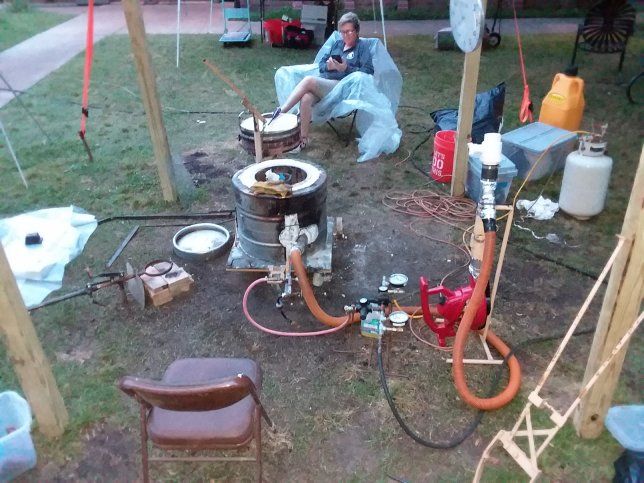

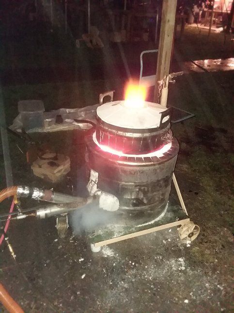

                  A photo of "the Beast" is shown below.
                  I am hoping that the radiant heat from the mini-furnace will be proportionally smaller than my larger iron furnace.
                  Edited By PatJ on 30/06/2022 07:31:35

                        Very Good,! with such a small gap between furnace wall and crucible lifting out may be difficult. A4 and A5 will be big enough for most small jobs.Be cautious of using lift out tongs for multi sizes, and the pouring shank needs to be exactly right for the crucible in use. I made a double ended ring shank, the end not in usr being the handle.  For non ferrous I would favour propane – but with fuel cost rising I may have to reconsider that. Many people seem to judge temperature by eye, iron not so critical but for non ferrous I would counsel it is vital. To that end an inconel sheathed 3mmdia, K type thermocouple is good, without a protective covering it will read fast – OK it will eventually burn out but the speed of reading is more important. A handheld read out is not costly and rules out one of the reasons for failure – wrong temperature.! For small experimental non ferrous melts a rather smaller furnace and an A3 crucible, gas fired is quick and easy. Using the soft K23 material and ceramic fibre a very light and easily handled unit can be built. I made one using a largeish sievert burner that would run melts of brass in a matter of 10 or 15 minutes. Are you in the UK ? Good Luck Noel.
                              I will probably use an A4 for most melts in this furnace.
                              The maximum total weight that I would melt in an A4 will probably be 12 lbs, and so it won't take much in the way of lifting tongs. The A5 is a bit tight for iron, but I think would work well for aluminum.
                              A buddy of mine recently built a furnace, with very little clearance at all around an A10, and it works perfectly with iron, so I think it takes less room than most people think. The hot fire brick walls are very durable, and so no chance damaging them with lifting tongs.
                              The A30 for my large furnace requires some very hefty tongs indeed, and I have a pouring cart and lifting crane for that. An A30 could hold up to perhaps 80 lbs of iron, so is in a different league as an A4.
                              Be cautious of using lift out tongs for multi sizes, and the pouring shank needs to be exactly right for the crucible in use. I made a double ended ring shank, the end not in use being the handle.
                              I have been able to use one set of tongs for more than one crucible size, as long as the tongs fit into the furnace. I have a mechanical stop that I can adjust, and I can adjust the tabs that contact the lower 1/3 of the crucible too, so it can be done, but one has to do it with caution.

                                          Maximizing the furnace interior temperature:
                                          In order to determine the maximum amount of fuel that you can completely combust inside of your furnace, the following method can be used.
                                          1. Start the burner at some nominal fuel flow value, such as 1.5 gal/hr, and adjust for a consistent burn.
                                          2. Allow the furnace interior to come up to red hot temperatures (interior of the furnace is glowing red hot).
                                          3. Increase the fuel flow until yellow flames (this is for oil-fired furnaces) protrude out the lid opening about 4 inches.
                                          4. Increase the combustion air into the furnace (I use a variable speed Toro leaf blower with an additional PVC dump valve) until the flames at the lid are drawn back into the furnace completely.
                                          5. Increase the fuel flow until yellow flames protrude 4" above the lid opening.
                                          6. Increase the combustion air until the flames are drawn back into the furnace.
                                          At some point, you will increase the fuel flow, and then when you increase the combustion air flow, instead of the flames being drawn back into the furnace, the flames will increase in size above the furnace lid.
                                          Reduce the fuel flow slightly, and your furnace is now completely combusting as much fuel as its hot interior surface will allow.
                                          Any significant changes from this fuel flow and combustion air settting will cause the furnace interior temperature to drop from its maximum obtainable level.
                                          For my large furnace, the optimum fuel flow rate is about 2.6 or 2.7 gal/hr of diesel.
                                          Edited By PatJ on 01/07/2022 15:55:12
                                          Edited By PatJ on 01/07/2022 15:58:35
                                          #603807
                                          PatJ
                                            @patj87806
                                            Oxidizing or reducing combustion:
                                            Reducing the fuel amount slightly from its optimal setting will create an oxidizing flame, which means there is a bit of excess oxygen that can react with your metal to create slag.
                                            For melting iron, I increase the fuel flow slightly above the optimum setting, to get about 4" of yellow flame out the furnace lid opening.
                                            This is a reducing flame, and it helps a great deal with minimizing the slag that forms on top of an iron melt.
