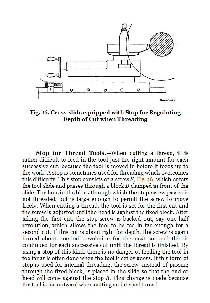

                              While reading a book on turning, copyright 1910, I came across, under the chapter on screw cutting, where a stop was fitted on the cross-slide to limit the depth that the tool cuts on each pass. I would think that a similar system could be fabricated to fit on the 'y' axis of a mill.
                              As the copyright is long expired I have included the relevant section below;-
                              Cross-slide stop
                              Hope this helps
                              Martin

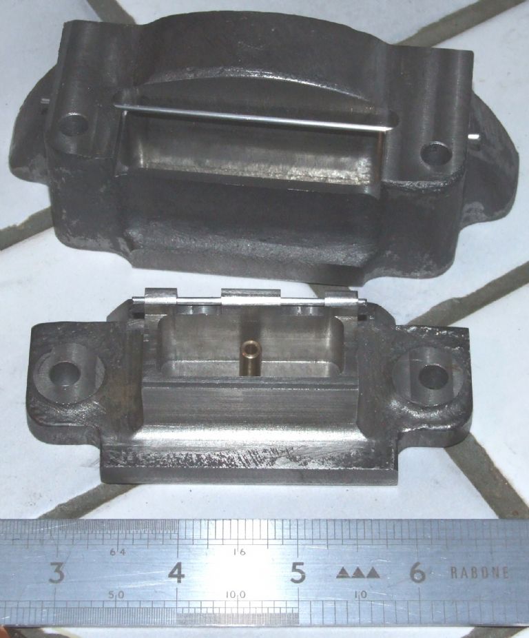

                                                I agree Jon, Table stops are very useful on repeat parts and I include in this repeat processes on a single part. Typically, if milling a closed end stop, say 6mm wide in 12mm thick, it would need multiple passes. Setting the end stops would simplify this especially for us oldies. With memory not being what it once was I could of course write down the DRO reading, say 0.879". However, when traversing the table and observing the DRO it would not be unusual to jumble the numbers and machine to 0.897" only to find when then looking at the part that I had gone too far.
                                                Mechanical end stops virtually eliminate such a situation.
                                                Having recently used my mill and rotary table to cross out some clock wheels, I set both ends of the X and Y axis stops and this enabled me to mill the spokes and the inner and outer curves at the one setting. Again, errors were almost impossible.
                                                Any viewer who would like to see details of this setup view here
