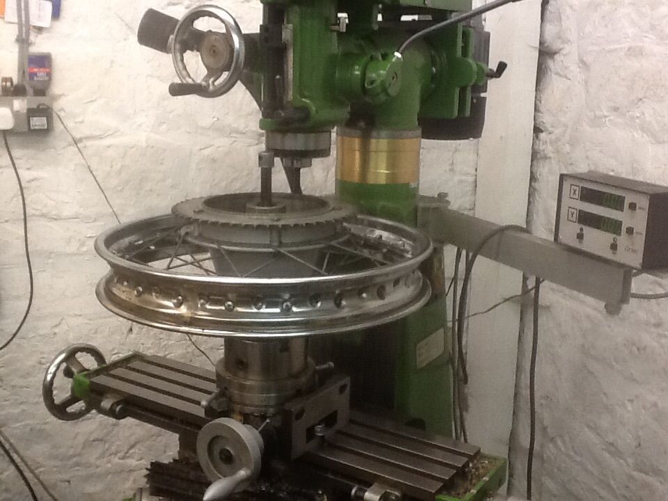

                    I have had a Warco VMC for almost twenty years now. Mine is a Taiwanese made version that was made in 1997, the new price way back then was £2400.
                    The current Chinese made versions are slightly heavier built with thicker castings, and I think the quality is certainly good enough for the price tag. £1800 for a new knee type turret mill of this size with a swivelling quill feed head is still a bit of a bargain.
                    This is my latest adventure with my VMC, skimming the rear wheel brake drum of my recently aquired 1971 500cc BSA B50. The 18 inch wheel was too big for my lathe, but just fitted in the trusty VMC. Thankfully the riser block I made and fitted a few years ago made the job a little easier.
