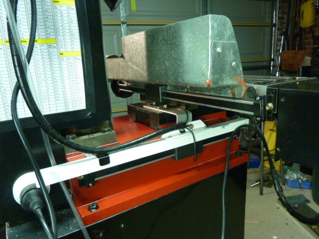

                I have been looking at the SX2.7 mill tonight with the thought "where would the bits for a 3 axis DRO fit". Has anybody done this yet?
                There appears to be plenty of space to fit scales and sensors the only scary position being the back of the table where you might want to fit the X axis sensor which would probably entail removing the table hence being scary !
                Y axis looks like scale and sensor would fit nicely on the right hand side with scale fixed to base of machine and Z axis on left or right. This is all dependant on scale and sensor sizes of course.
                Another question is do we use magnetic or optical scales/sensors ? Got some more investigation to do smiley

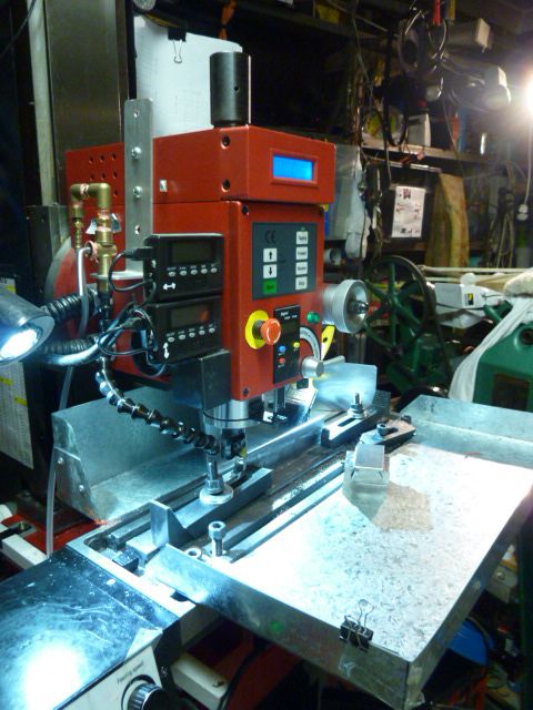

                      Paul Lousick
                        @paullousick59116
                        Nige,
                        I used to have an SX3 and removing the table is easy. (assume similar for SX2.7). Remove screws securing the thrust bearings at end of table and unscrew the leadscrew, loosen gibs and slide out the table. Table is heavy but can be lifted by hand. My SX3 already had a Z-axis DRO fitted and I added scales for X & Y. Note: These cheap DRO's started to give problems and I replaced them with Easson glass scales and readout.

                        David George 1
                          @davidgeorge1
                          I fitted the X axis scale to the front of the table as if it had been fitted to the back it would have restricted the movement and possibly traped swarf. I had to remove the stops and pointer on tape scale riveted to the table, but when you have a DRO you don't use it.

                          Paul Lousick
                            @paullousick59116
                            The X axis scale on my old SX3 and new RF-45 have the scale at the rear and can still achieve full travel. The SX3 was fitted with a splash guard at the rear to keep swarf and coolant from flying everywhere. The Easson glass scale which I now have come with a cover to protect them from swarf. Even though I have the DRO, I still use the travel stops at the front when doing multiple passes to a set position.

                              Peter, the two thread one of which is this one can be found as stickies at the top of this section of the forum
                              The SX2.7 table goes back a long way beyond the spindle so room enough to fit the scale as you won't often be machining work hanging that far off the front of the table.
                              Also there are two M4 tapped holes already provided that can be used to take the read head bracket for the X-axis scale, these are what Sieg use on their own brand scales. So just two holes in the back edge of the table to drill and tap which are easily accessed with a cordless.

                                Jason: Thanks, I had spotted 2 holes behind the table but hadn't investigated any further.
                                I would appreciate thoughts about whether to fit a 2 or 3 axis kit to the mill. 2 axis is cheaper and I'm trying to think why or when the position in the Z axis is useful for anything other than drilling holes to a known depth which is already quite easy by hand with the digital vernier already fitted. Or am I missing something fundamental?

                                Paul Lousick
                                  @paullousick59116
                                  Nige, An option is to buy a 3-axis display and 2 scales. Then you will be able to add the extra if required later..
                                  The better quality DRO readouts have extra functions. PCD positions for holes, inclined positioning, ability to machine a curved surface. + more. Some of these features can be used in the Z direction with a 3-axis readout. (Easson DRO's have a good explanation on the web) https://www.youtube.com/watch?v=jeCYSLuwktU

                                    I did what paul says and originally bought a 3 axis display but just X&Y scales. Added the Z about a year later, I don't have the fine feed or digital Z on my X3 so more likely to need a 3 axis than you.
                                    Times when it may be needed, when you are working on a large part with several different height machined surfaces and the quill scale won't cover that range, curved work using the functions of the DRO and easier to read, no battery issues and more reliable than what is essentially a cheapish calliper scale fitted to the machine already.
                                    "Pimp your SX2.7 tip" Part 2.- Make sure that when the nuts that hold the end of the supplied scale to the forked quill bracket are tightened they don't pull the scale off line as this can make the quill action tight. Best to undo nuts and fit a small washer either side of the forked slot so nuts tighten onto that.

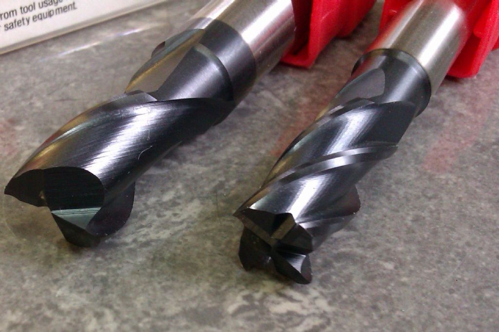

                                              I started a thread and asked peoples advice on using my bench drill for lightweight mill work, a lot of the guys came back and said DONT. General opinion was to get a mill slide for the minilathe or better still get a mill. I have decided to save until I can afford a small mill.
                                              I have some basic understanding on operating the lathe but none when it comes to a mill. A few years back a friend gave me a small selection of cutting tools for a mill and I was looking at them yesterday evening and it sparked a question.
                                              What is the difference between a slot drill and an end mill and which does what when milling. I,ve read a few bits and pieces but not much. Would I be correct in thinking that a slot drill will plunge cut as well as cutting on its sides, whilst an end mill will not plunge cut but its cutting edges are on the sides only. Sorry for the poor description but I dont know the correct technical terms yet.

                                              not done it yet
                                                @notdoneityet
                                                Both will do the same basic job apart from the end mill does not have cutting edges which cut to the centre on the end. That means that if you try to plunge cut there is a central area left uncut, preventing any plunge. Basically as simple as that.

                                                  Thanks, Now I,m probably being stupid here but what is the point of an end mill, why not use a slot drill for everything..?

                                                    Sorry I can't agree with that old way of thinking, many "end mills" produced now have centre cutting edges and would now be better named "4-flute milling cutters" as they can plunge cut. Ok this is a rougher but same applies you can plunge, ramp and side cut with 4-flutes
                                                    2-flute cutter also tend to cut a lot closer to their nominal size where as a 4-flute can cut over width if it deflects in a heavy cut.
                                                    Have a read of part 4 of my series for a bit more info
                                                    Not the best photo but the 4-flute on the right will plunge cut

                                                      Posted by Ron Laden on 01/07/2018 13:17:13:
                                                      – If you were to slice a 4-flute cutter across the flutes the cross sectional area would be more than that of a similar diameter 2-flute one so they are more rigid handy for long deep cuts or when using a lot of the cutters side.
                                                      – for the same optimum speed and tooth loading you will be able to remove twice as much material with a 4-flute than a 2-flute so job takes half the time.
                                                      – For the same cut a 4-flute will remove twice the metal of a 2-flute before the cutting edges are worn to the same extent so cost and time savings
