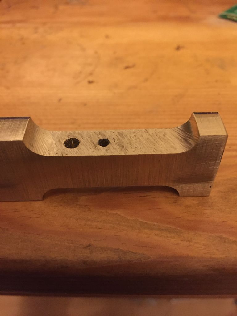

        I don't like milling, perhaps because I have only a small bench machine (Warco WM14 – about 65kg, roughly equivalent to the Seig SX2) and normally take tiny bites (say ten thou) so things take ages. But in a fit of reckless enthusiasm tonight I did this in one swipe:
        The material is CZ121 brass, I pushed in a 10mm 4-flute HSS endmill in sideways to make a 5mm radius, then 'conventionally' milled to the other end.
        It worked, nothing broke, but the finish is pretty awful. I'm wondering if that's because I'm working this little machine too hard or I got speed/feed wrong. I was going at about 1200rpm and feeding (at a guesstimate) about 0.7mm per second.
        Do I need to buy a bigger mill to do this sort of thing? Please say yes!
        Robin

              Classic chatter problem. The feedrate is way too slow; 0.7mm/s is 42mm/min you need to be nearer 150mm/min or more. I'd advocate a finish pass too; climb milling for best finish but that may not be advisable on a small mill. Another issue for the finish pass is that in the corners you're going from a low tool engagement angle to the corner wrapping around a large arc of the tool. That's a classic cause of chatter. On a CNC mill you get around it by using a smaller diameter cutter. Not much one can do about it on a manual mill other than make sure the tool is sharp and everything is as rigid as it can be – short overhangs and unused axes locked etc.

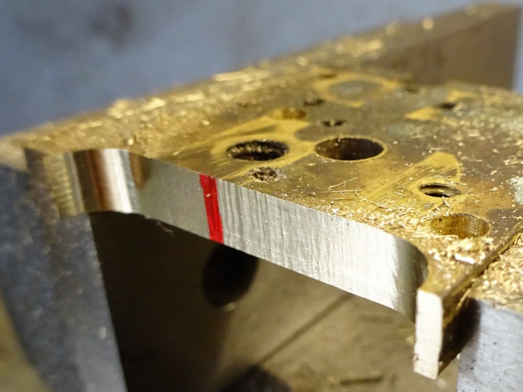

                              I think the milling for beginners one may be a bit shallow and slow for brass so popped down to the workshop and had a play.
                              1/4" brass which looks about what Robin is using and similar speed. A couple of different 10mm cutters did not perform that well maybe because 1/2 diameter of a 4-flute cutter is not an ideal combination so popped in a used 3 flute FC-3 type cutter uncoated HSS.
                              The infeed is where the cutter is working hardest as the cut is widest so took it easier there and even dropped the speed down towards the end, then back up for the actual pass, probably feeding at 2.5-3.0mm per sec. Still a bit much for these light machines so would probably do it in two passes then a clean up.
                              Photo shows 0.2mm cleanup pass to the red line.

                                  Wow, thanks for replies and especially to JasonB for taking the time to pop down to the workshop for a play and showing results. This has been really useful for me – I've not been using the machine to anywhere near its potential. It's actually happier with a a faster feed and higher spindle speed, less vibration and so better finish. Not sure I understand why, but it works.

                                      Yes, I totally get the thing about what's best for the cutter NDIY. The trouble for me as rank amateur is that I read stuff about optimal feeds/speeds for both lathe and mill work, but there always seems to be an underlying assumption that the rigidity of the machine isn't a problem. For example, I think that there is a rule of thumb that we can take off a cubic inch per minute per horsepower or something in steel. In my dreams! Another example is the calculator here: **LINK**
                                      You don't get asked about the machine, just about power, DOC &c. so I assume the rigidity of the machine is a given – we don't have to worry about that.
                                      What mystified me about upping speed and feed on my little mill was that the machine seemed happier – I didn't seem to have to wind so hard although I was taking metal off faster. Maybe subjective though.
