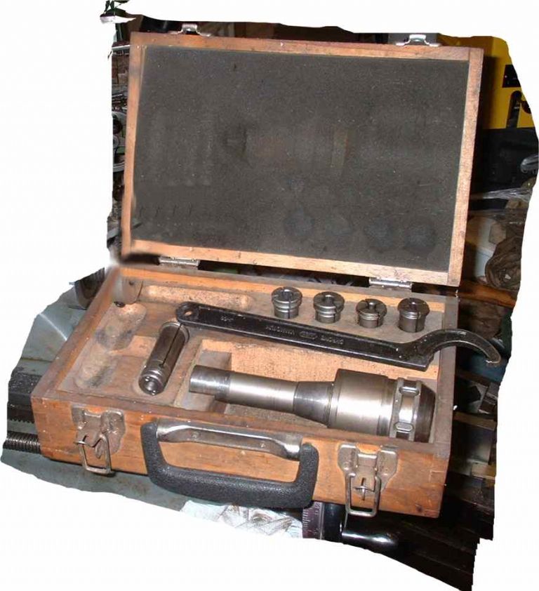

G'day all.
Can anyone identify the taper on the shank in the photo, please? All I KNOW is that it is not MT2!! Shank length approx 4", diam at inner end approx 1" and the taper is about 1" min to max,
TIA
Rgds
Bill
Hi Bill,
It looks like R8 to me.
Les.
Looks R8. Is there a keyway on the other side?
R8 dimensions
Hi,
Definitely looks like R8, c an you give some more dimensions,, approximate really is not good enough to properly identify a precision taper!
Thank you, gentlemen.
Jason – will cross-check against your (and JS's) link dimensions. The set appears to be Innexa Suiki (sp?) and will be disposed of shortly.
