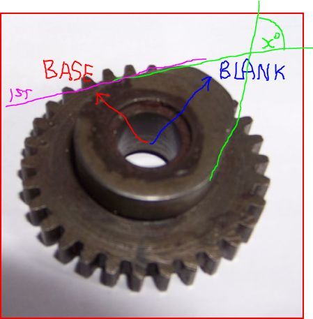

              The engine that I need these cams for is a 1921 single cylinder o.h.v. 142cc.
              My rotary table is a Warco HV4 4" with chuck and 3 dividing plates.

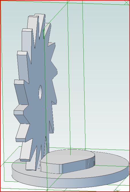

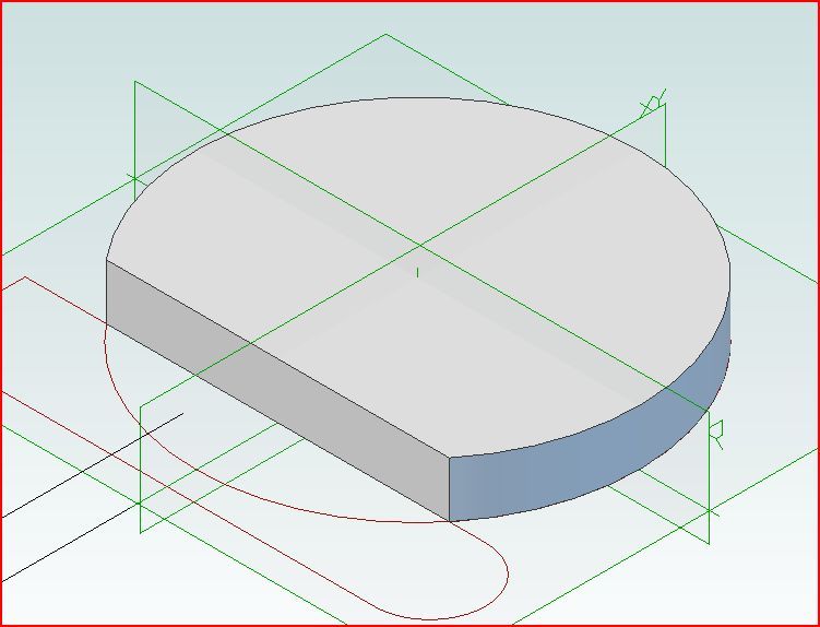

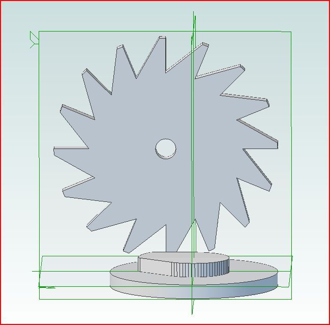

                    #241273

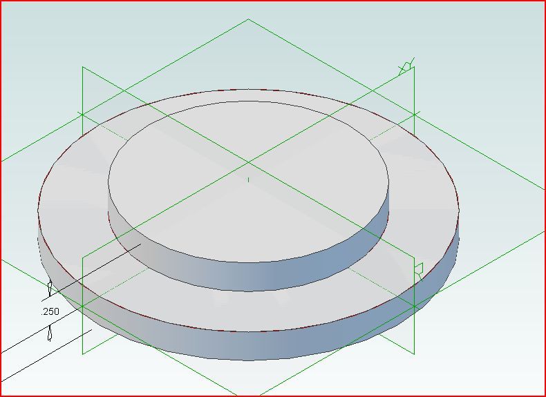

                      First job is to turn your blank disc. The main diameter will be the OD of the gear and the smaller diameter will be twice the blank radius shown in blue. Drill and ream/bore the hole as well (I have not shown the hole and will leave the gear part out of some images)
                      This should give you a bit of metal that looks like this, hold it in the chuck on the rotary table with the cam blank facing up and center the part under the milling spindle. If it is too big for the chuck make a mandrel to fix it to.

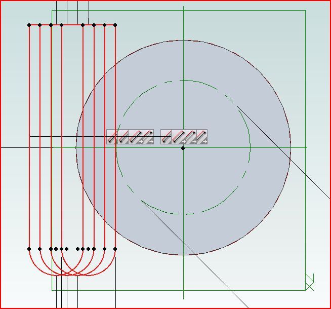

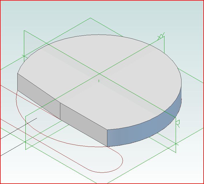

                      Fit a reasonable milling cutter into the machine, say 1/2" or 12mm and with a fag paper between the gear part and the cutter set your height. Now take a series of cuts off the left hand side using the Y-axis until the cutter reaches the base radius, shown in red above, lock the y-axis (gear part of blank not shown from now on) This is your first cut shown in pink

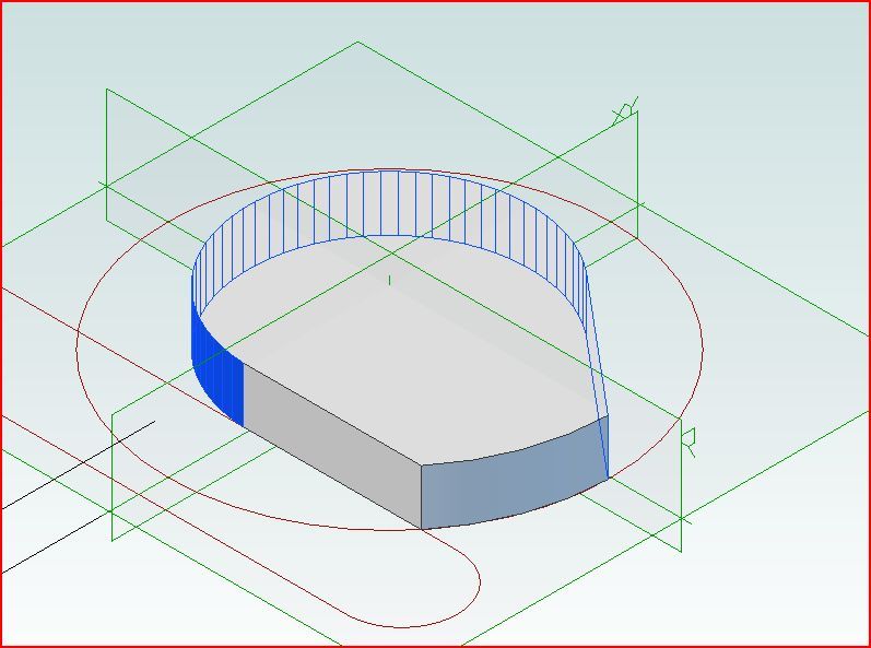

                      This will leave the cam part of the blank looking like this.

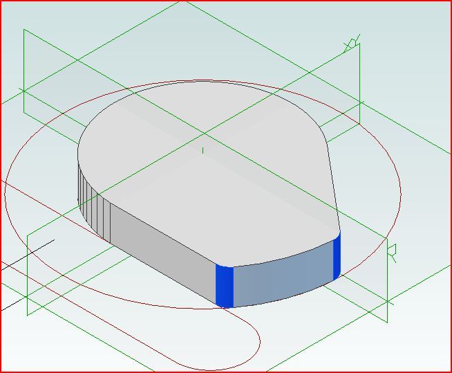

                      You don't need to use the dividing plates for this, the scale on the rotary table will do. I would suggest you make the following cuts in 2degree steps (half a turn) which will give a good surface that will need little cleanup, I have shown 5degree so things show up better. So turn the handle of the table a half turn so the work moves clockwise when viewed from above and take another cut in the y-axis. This will take a small cut off the front half of the blank
                      Keep repeating the half turn, cut, half turn, cut and you will see the shape start to develope

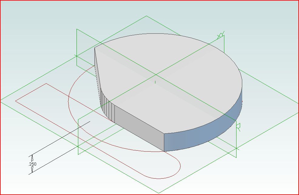

                      Keep on going for the required angel (360 less xdegrees shown in green above)
                      You can then just file the small radius at the two corners of the cam

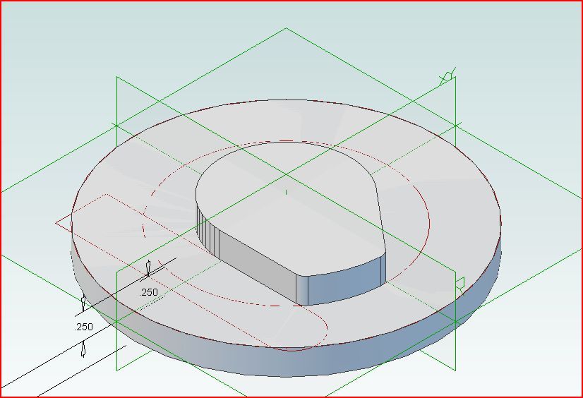

                      Then a bit of emery on a file will blend in all the faccets left by the cuts and you should have a part like this ready to gear cut
