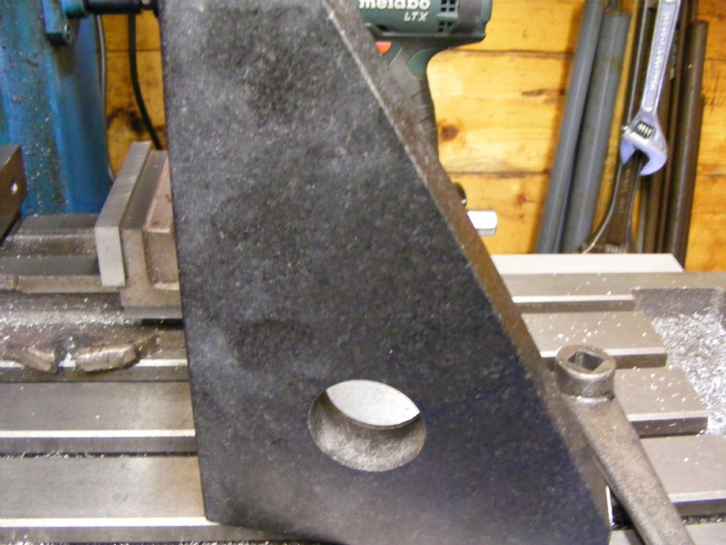

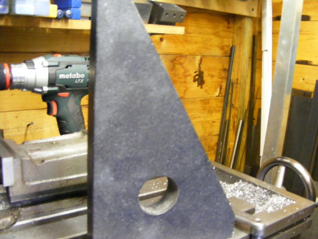

                                    Dan, I have a similar mill to you I have the Chester Lux and had the same problems as you are having. I had the devils own job but got there in the end. I started by getting the column square to the x and y axis when the head is moved up and down. Then I did the head it's self to get the spindle square when moving it in and out. Took ages but was worth it. Used Devcon steel filled epoxy to bed everything down on to once I was happy. I make a point of never tilting the head left or right to do angles, it is "fixed " Managed to get the column in the x and y to less than 0.02mm over the 350mm length of the square., and the Quill to more or less the same. So it can be done, just takes care and quite a few hours. Is really worth it though.
                                    Here is a pic of the Granite Square used, It was made By Crown Windley and is accurate to 0.002mm over the 350mm length and the same over the short length. It is about 50mm thick and being granite is very stable. Not sure if Crown still make the Granite ones. but there will be others that are more affordable out there. crown windley.jpgcrown windley 2.jpg

                                            Reading this thread yesterday prompted me to satisfy me curiosity, so went out with the square and got these readings,
                                            Head up / down the column X axis 16 µ. Y axis 13 µ. [ over 350 mm ] Quill in / out X axis 14 µ Y axis 11 µ. [ over the travel of the quill approx 125 mm ] Tram over the width of the table has not moved as I still get the faint cross hatching when fly cutting. All this setting up / epoxy was done quite a few years ago, and to all intents and purposes has not moved.
                                            I don't suppose you will have access to a Hilti injector, but maybe you could use a syringe , It wont have anything like the pressure of the Hilti but you could inject the resin at various points.
                                            All in took about a good working day in total , fiddly yes, patience testing most certainly yes, but well worth it.

                                                Dan, Setting up the Granite square with the long 350mm edge on the x axis [ set up so there is no deviation along the x ] the reading along the y axis is 14 µ over approx 190mm . Might be a good idea to remove the tapered Gibs and clean and oil everything then stick them back in and adjust them for best fit, then take the readings again and see what you have. I actually stoned then cleaned and oiled my gibs when I first got the mill just to make sure there was no dirt ect and then adjusted them to give a nice fit. The mill is 10 years old now. and still accurate.
                                                0.04mm does seem a bit "off " especially when it's only over a length of 145mm or so. The machine is certainly capable of far better than that. Certainly you should check the gibs before deciding what your next move is .
