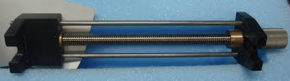

                  #78592
                  ady
                    @ady
                    around your spring. If there is plenty of room you could try placing thick washers
                    in the coils to lengthen the spring until it slips onto the post
                    If there is sufficient room a ball joint breaker would extend your spring
                    The general design might give you some ideas too
                    The bottom bit is a fork, so with a fork on the top and bottom…etc
                    #78593
                    ady
                      @ady
                      There ya go.
                      A spring extender
