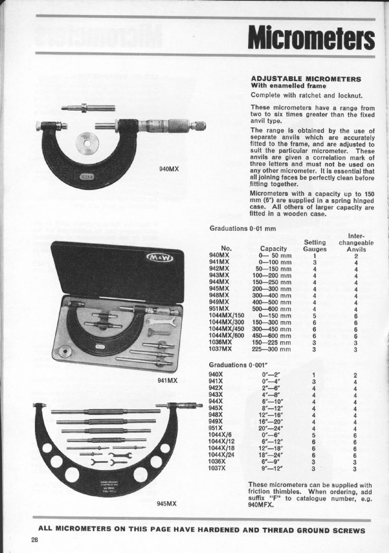

                #211905
                ega
                  @ega
                  Paul Davies 8:
                  My M&W cat lists the 940MX with locknut, rather than clamp, and alternative anvil to give greater range. Is this your type?
                  #211923
                  Paul Relf-Davies
                    @paulrelf-davies37806
                    As far as I can see, this one on ebay is the same as mine.
                    cheers
                    Paul

                          #211947
                          ega
                            @ega
                            Paul Davies:
                            Yes, that looks like the catalogue item:
                            Edited By ega on 13/11/2015 15:16:42

                              Well,
                              Having got home and done a little more digging, I can confirm that the mic. is indeed a model 940, from the engraving on it and that the problem is a combination of the clamp wheel being tightly done up as well as the innards being all gummed up.
                              I've given it a generous dose of penetrating oil and have been able to slacken the clamp off and the thimble now turns freely out to .920", where it stops & is well & truly stuck. The ratchet also refuses to move.
                              I'll leave it to soak in over night, and see how it is in the morning.
                              BTW, I unscrewed the clamp completely and discovered, where the vernier section screws into the cast 'C' that there seems to be a lot of rust.
                              I suspect that despite the clean exterior, this mic may have been for a bath at some time in the past…
