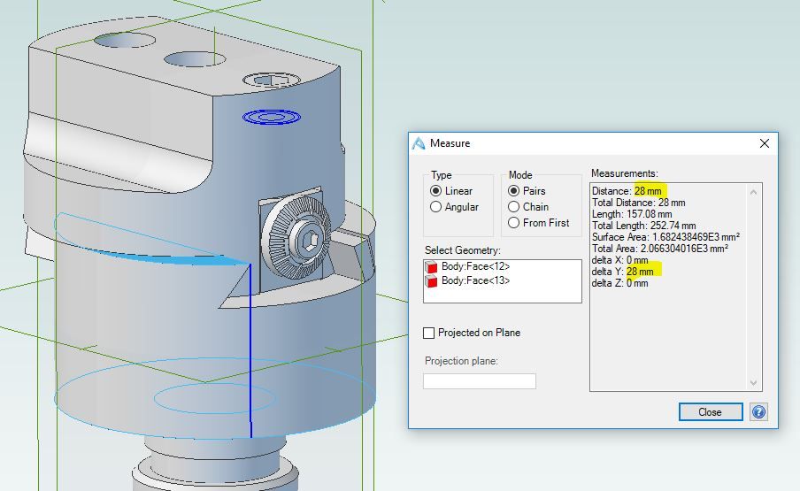

                        Hi
                        I downloaded these plans with a view to building one. First thing I did was priced up the materials and tools I'd need to buy, eg the 2" steel round bar, and a set of boring tools. Turns out it will cost in the region of £45 if buying cheap Chinese or possibly Indian carbide tipped boring tools. I compared this with what it would cost me to buy a boring head already made, and in a plastic case, including the boring tool set, around £60. So now I'm just debating on whether to build or to buy!
                        Another thing I noticed was that on the drawings, for both the body(figure 3) and the slide (figure 7), the height of those parts is not given. On the body, there is a 16mm dimension for the depth of the hole the arbor screws into, and the height of the dovetails is given as 7mm, but there is an undimensioned section between those 2 points, that looks about 5 or 6 mm. Again, on the slide, there is a dimension showing the depth of the holes for the boring tools(15mm), and a dimension from the opposite end to the threaded cross holes for the boring tool fixing screws at 24.5mm, but no overall height – I'm guessing it to be about 32mm or so.
                        I only noticed because I was trying to work out how much 2" bar I'd need to buy, but it didn't matter in the end as I'd just buy a 6" length of it quite cheaply.

                              #405467
                                If you make the body 28mm overall you should not go far wrong.
                                Edited By JasonB on 17/04/2019 13:17:34
                                #405480
                                  Posted by Ricky Walker on 17/04/2019 03:24:22:
                                  Hi
                                  I bought a cheap bar end from a steel stockholder.
                                  Well done of spotting the missing dimensions!
                                  The lower block is 28mm overall (it's actually marked on my original drawing!) so Jason is spot on.
                                  The upper block is drawn at 27.5mm, but not marked on the original drawing… neither is critical.
                                  #405482
                                    Posted by Neil Wyatt on 17/04/2019 15:52:22:
                                    is that right Neil?
                                    Atom one has it at 25.7mm from end to base of dovetail and 32.5mm overall thickness

                                      #405823
                                        Posted by JasonB on 17/04/2019 16:03:59:
                                        is that right Neil?
                                        Strange, just checked, 27.5mm.
                                        But TurboCAD also gives me ~20mm for a 25mm dimension?
                                        AH! I was looking at a paper layout which is scaled smaller to fit an A4 sheet.
                                        Go to the original model and its 32mm overall, the Atom person must have worked it by eye..
