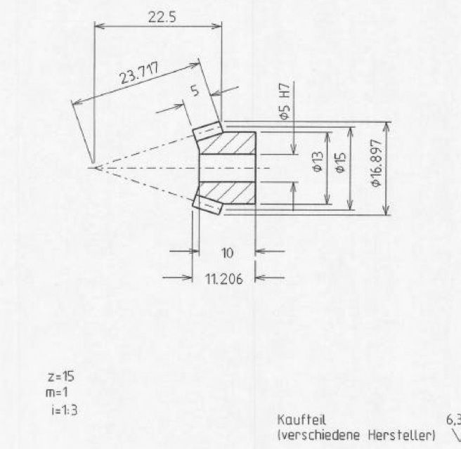

                              while I have my question head on would some kind person give me some help with this part of the project. its the drive gear (bevel gear) the annotation to the left i am presuming is the number of teeth? the module type and the ratio with its mate of 3 to 1.screen shot 2014-10-22 at 23.23.36 copy.jpg

                                Is that drawing meant to make sense?
                                First we have 16.897
                                Then 15?
                                Then 13?
                                followed by 5 H7
                                No wonder they lost the bloody war

                                Bill Pudney
                                  @billpudney37759
                                  My reading of that would be
                                  16.897 = in mm the theoretical max. diameter (actual diameter if the number of teeth was even)
                                  15 = in mm the PCD
                                  13 = in mm the diameter of the boss
                                  5H7 = in mm, the basic diameter of the bore is 5.0mm, the H7 is the tolerance +0.012/0.00mm
                                  Hope this helps clear your confusion, it's really simple actually
                                  cheers
                                  Bill
                                  Edited By Bill Pudney on 23/10/2014 01:46:54
                                  #167446
                                    Bottom left
                                    Z = Number of teeth
                                    M = MOD1 (size of gear form)
                                    i = ratio 1:3 so mating gear likely to have z = 45 on it or 45 teeth
                                    Edited By JasonB on 23/10/2014 07:33:53

                                      Thanks Bill and Jason I looked at the mating gear and that drawing has the same annotation but with the numbers 45 so problem is sol-ved.
                                      I am now reaching for the S H Muffet catalog to see if they have such items or bracing myself for the horrors of making them!

                                        It also states that it is a "kaufteil" from "verschiedene Hersteller", so you should be able to buy it from several suppliers, such as http://www.maedler.nl/Article/36057600. Niko.

                                          HPC have them but make sure you are sitting down before clicking here
                                          #167489
                                          Keith Long
                                            @keithlong89920
                                            Martin – as well as the EN8 steel bevels that Jason has linked to above, HPC also do the bevels that you are after in Delrin link at much better prices £20 + vat for the pair. EN8 is somewhat overkill in your application, the drawing suggests brass (CuZn) in the materials spec with mild steel as an alternative. Given the application and likely speed that you'd be using I'd think that the Delrin gears would be adequate. If they broke down eventually then they have the advantage of being standard parts that could be replaced or up graded quite easily.
                                            Brass bevel sets in 3:1 ratio used to be very common as they were used in the final drive for slot cars, but I don't know what module or dp they were. They were also fairly cheap from memory, they might still be around, a bit of "Googling" could bring them to light. Could also be worth asking at your local model shop to see if any of the RC helicopters, cars or trucks use a suitable gear set. If so they are very probably available as fairly cost efective spare parts.
                                            Just found moulded delrin bevels for your application at Motionco price even better – cheap enough to buy on an experimental basis
