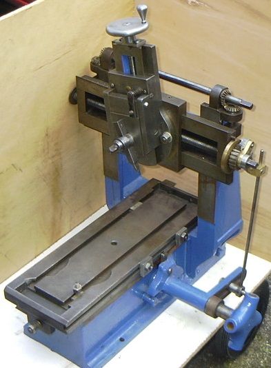

      This is an overview of a small metal planer.
      The bed is 17 in by 6 in with a bit over 7 in between the stanchions to allow a little extra width. Travel is 12in though something seems to be jamming at 10in at the moment. The tool slide has about 3 inches of unusable range without an excessively long bit but can be used practically over a 4 in range while the cross travel easily covers the maximum 7 in of a workpiece.

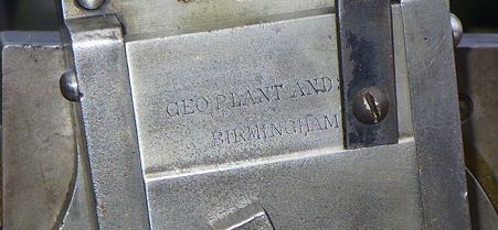

      The tool slide is precisely engraved "Geo Plant & Son Birmingham". This name gets nothing on an internet search so does anyone have any information on this company or its products? There are no other identity markings on the castings.

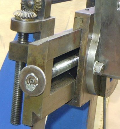

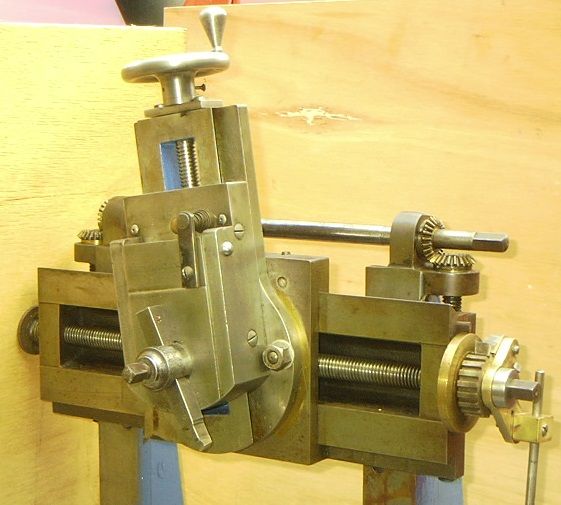

          The gantry cross slide is a10 tpi V thread though all other threads are square so this might have been a modification. The dial is marked on the face with 100 divisions labelled every 10 but the periphery is divided into 64 which might suit an eight tpi screw better (ie 4 divisions = 128th) for someone used to working in fractions.
          Note the beautifully inlaid brass scale for setting tool slide angle.

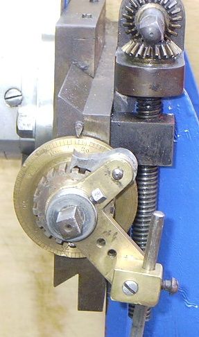

          The ratchet mechanism has 20 teeth to give a 5thou advance which is probably reasonable. The pawl flips over for rewind with the arms as shown but could be better set up for flipping for alternate direction. The vertical bar clamp is possibly not original.

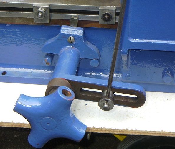

            The operating handle is for 4 spokes rather than an adjustable flat bar as seen on other small machines. The holes are not threaded or provided with grub screws so only practical for a single bar. Perhaps it was envisaged that the owner would fix the handles post delivery. Each stanchion is held by two bolts and a dowel and note the hole in the base casting flange for fixing to bench. There are no holes underneath for the stubby feet many bench planers have.

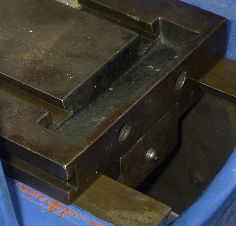

            The rear of the slide has two tapped holes for an end plate for aligning work. The thrust of course is in the opposite direction where perhaps some provision could also have been made at the other end.

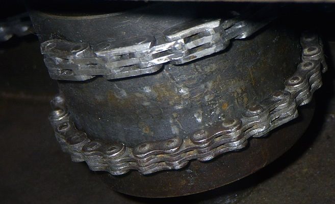

            The middle of the bed has a threaded hole probably for oiling the unusual chain drive mechanism. The front end of the chain has a rather worn adjusting screw to take up slack which also has a top hat washer indicating perhaps a missing spring.

              You will have noticed the breaks in the table T-slots in the first photo. The other bodge that needs repair is the end of the cross traverse screw that has a washer that has been soldered in place.

                  Very nice looking machine, Bazyle … and I think I know why.
                  Put "George Plant & Son" [including the quote marks] into a Google search.
                  … Several very encouraging hits.

                      Ah, thanks. I should have known that. His factory in Nelson street has been well flattened.
                      It will be interesting to see if there are any similarities in workmanship in other Plant products.

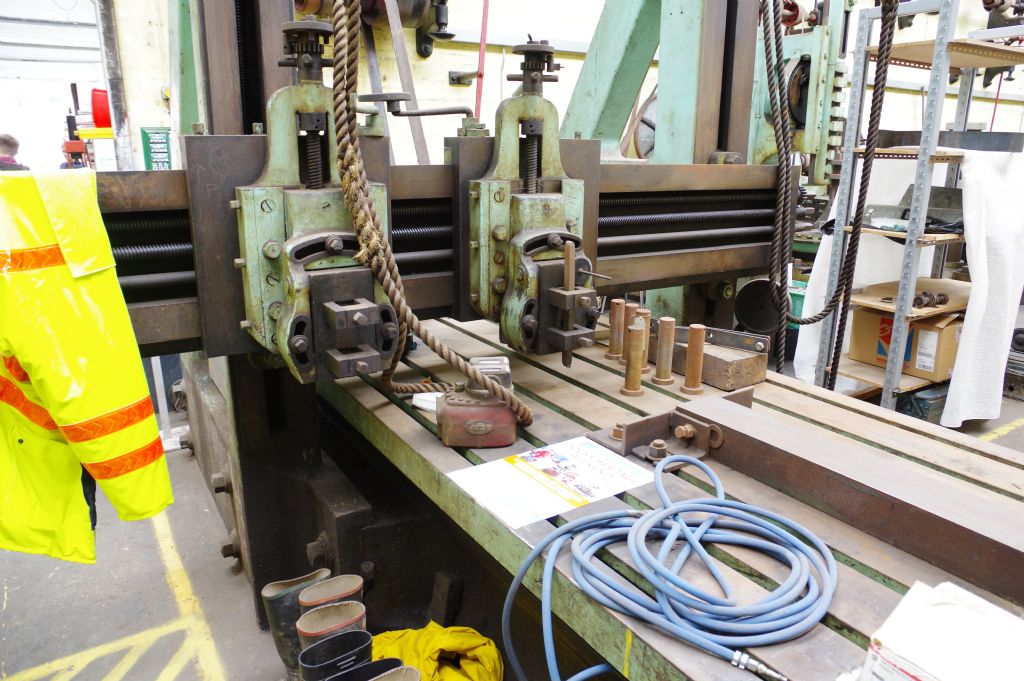

                          Its a shame about the broken tee slots, I wonder if there is any way of turning the table round?
                          There is a bigger one at the Underfall Yard at Bristol.

                            James, the table is 6 in wide by 17 in long. However the stroke is only 11 in. Apart from the 2 in lost at each end by the slot design the table only goes forward until the back is level with the back of the gantry. Thus the slides put the tool further forward than expected. A cranked tool doesn't help as the stroke is limited by the fixings of the chain drive underneath. A rack drive could be made to give a longer stroke.
