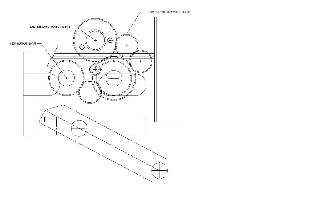

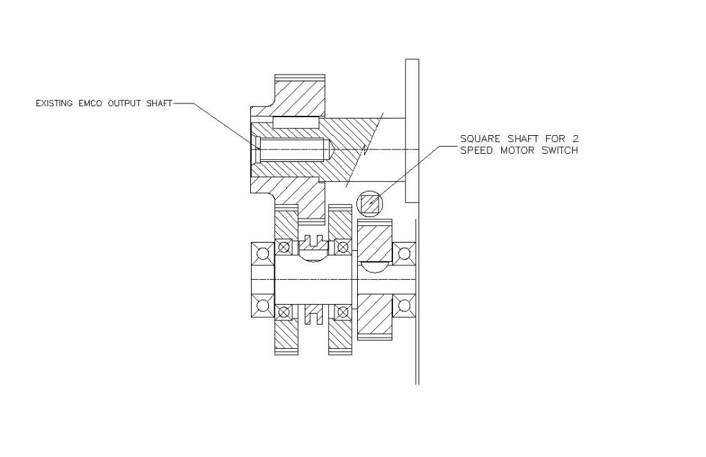

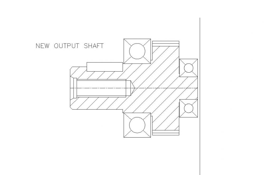

              Having had another look at the Maximat Super 11 dog clutch again, I have come up with the following schematic that I am 90% certain will work.
              The main stumbling block has always been the square operating rod for the two speed motor switch. The rod is right where the clutch should ought to go. However in a moment of inspiration I tried fitting the dog-clutch outboard of the rod and hey presto it worked.
              While this is just the schematic drawing, certain changes will probably be needed to be made, but nothing significant, (I hope).
              Regards
              Gray,

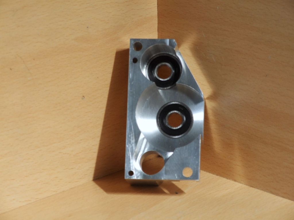

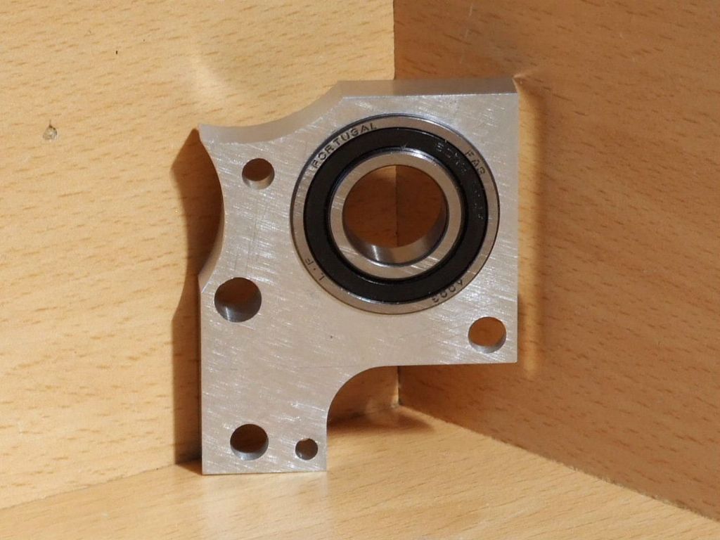

                  #405902
                  Graham Meek
                    @grahammeek88282

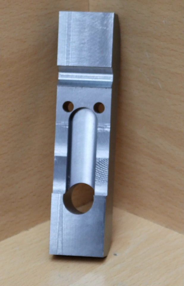

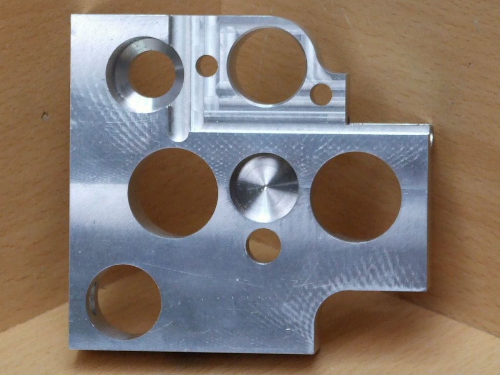

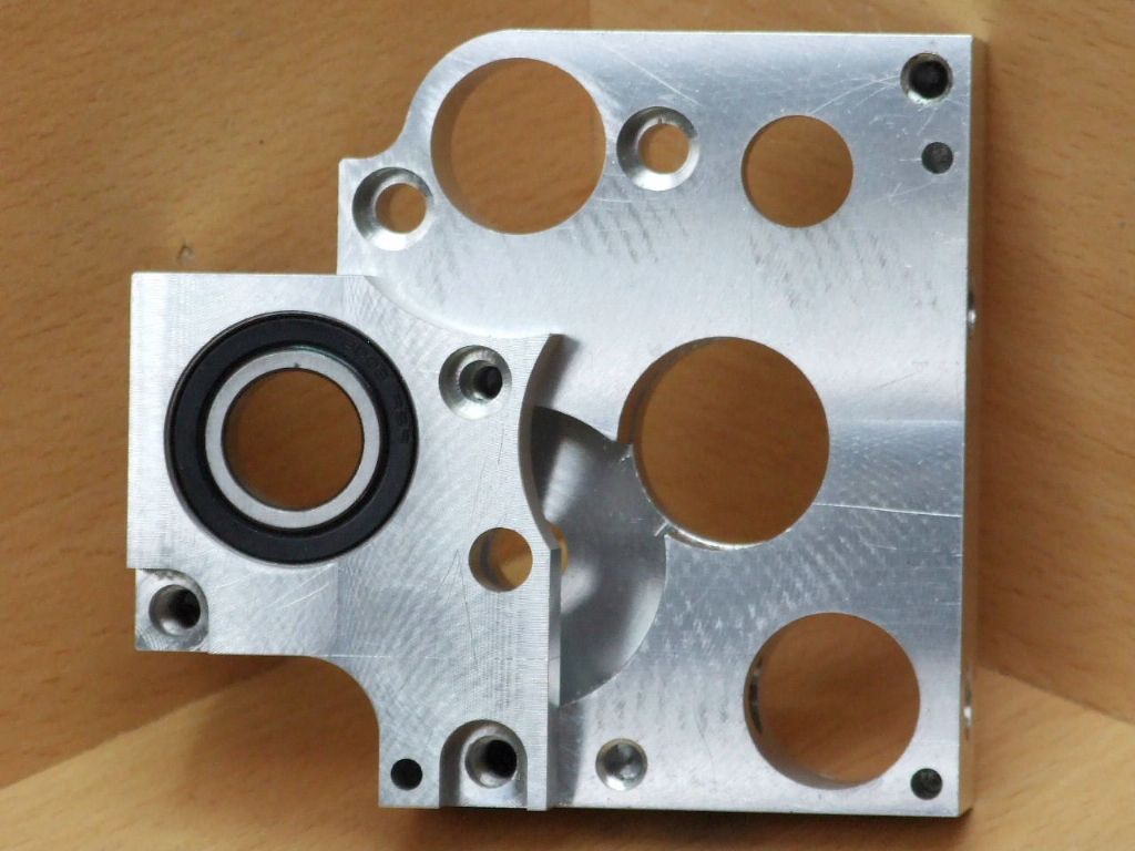

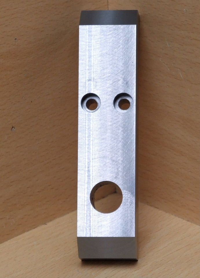

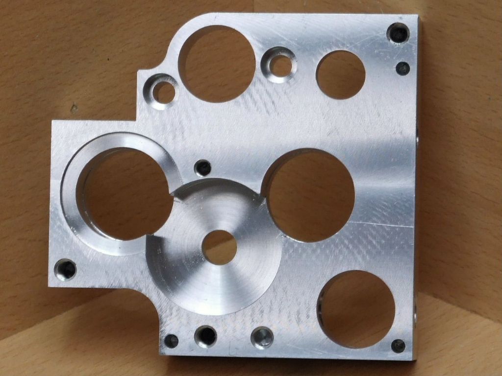

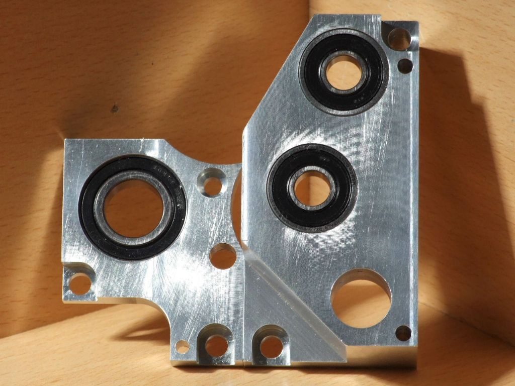

                    For those following this post I have started work on the parts for this screwcutting clutch. The above photograph shows how the Gearbox Cover plates would fit to the Main body. The output shaft will be on the left Overall length of the unit is 103 mm by 96.5 mm high .Hopefully this week I shall make a start on the main body.
                    Regards
                    Gray,

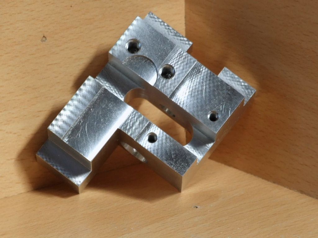

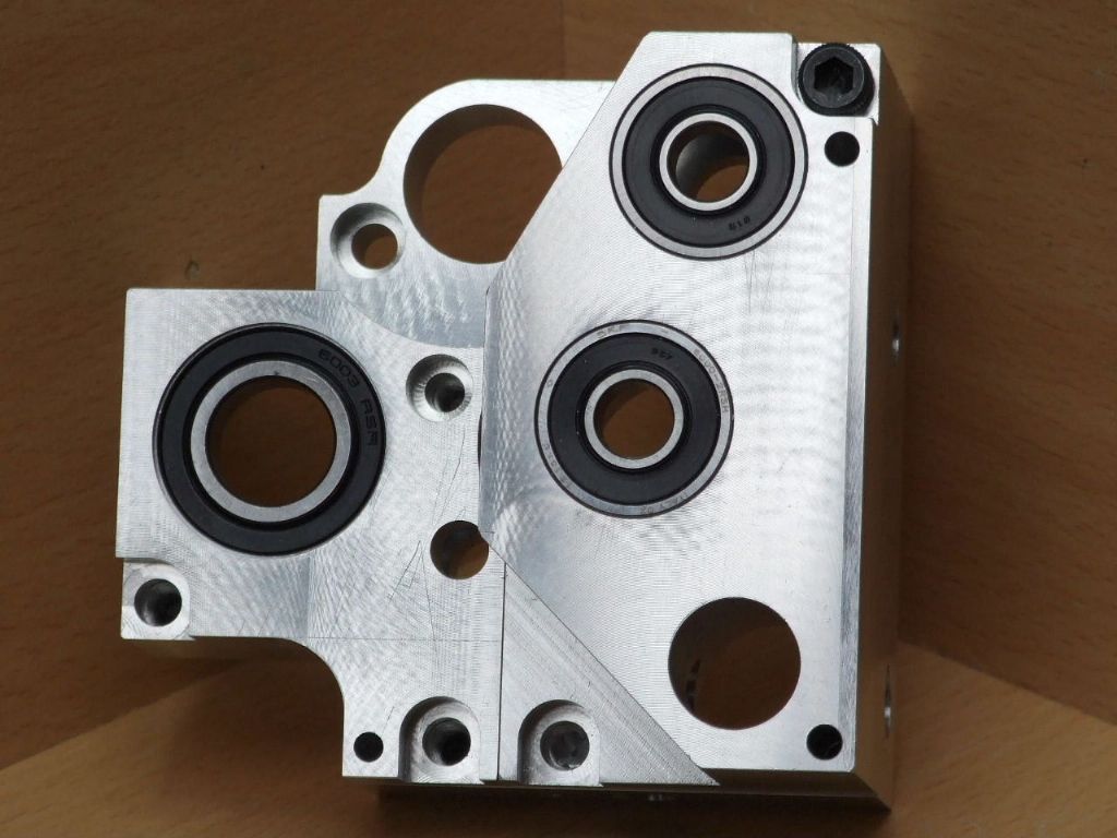

                    #407836
                    Graham Meek
                      @grahammeek88282

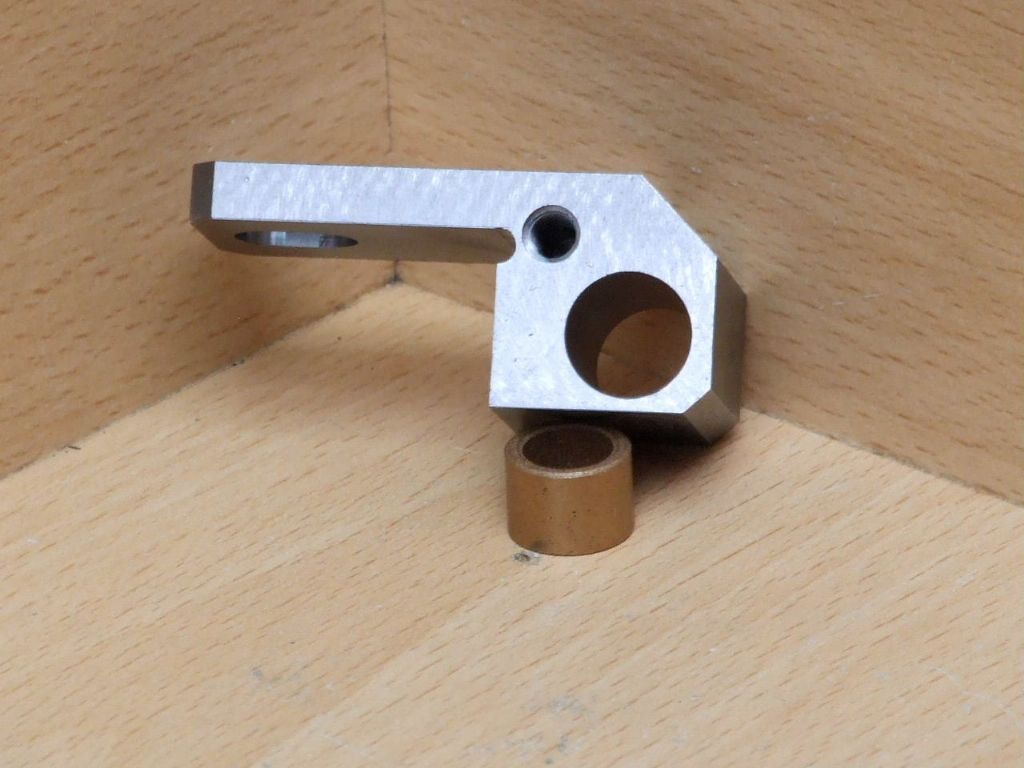

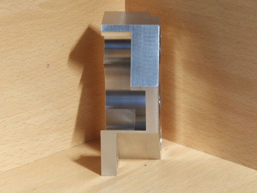

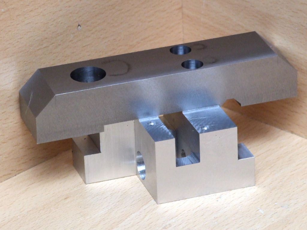

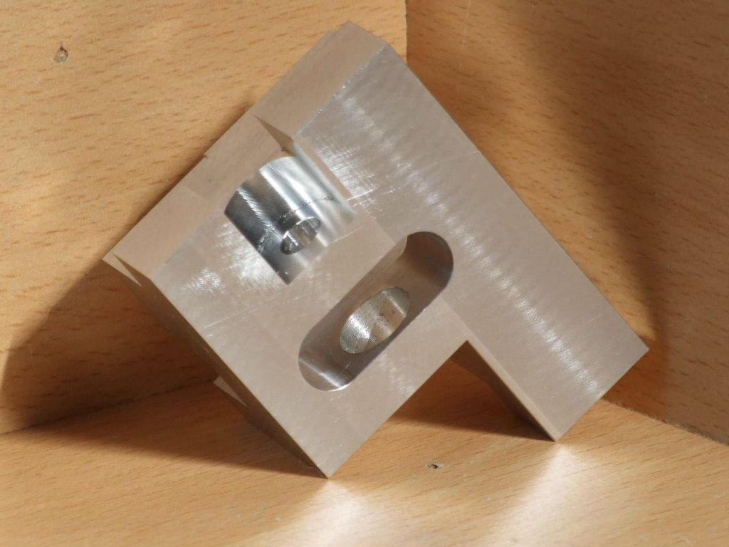

                      I had hoped to make a post last weekend, but things conspired against me. The Main Body shown below is the second attempt. The first was originally made in cast iron tooling plate, but two operations from the end I noticed a crack in the plate like the strata running through a rock face. Thus it was time to start again.
                      Here are some more photographs of the project so far.
                      Regards
                      Edited By Graham Meek on 05/05/2019 13:04:52

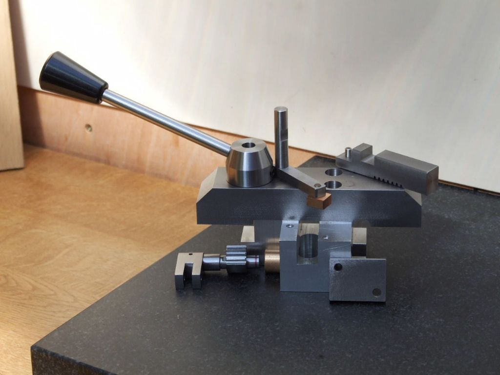

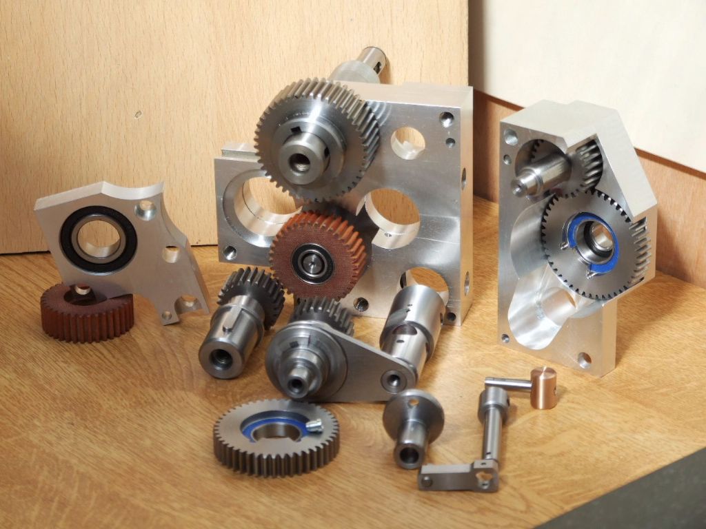

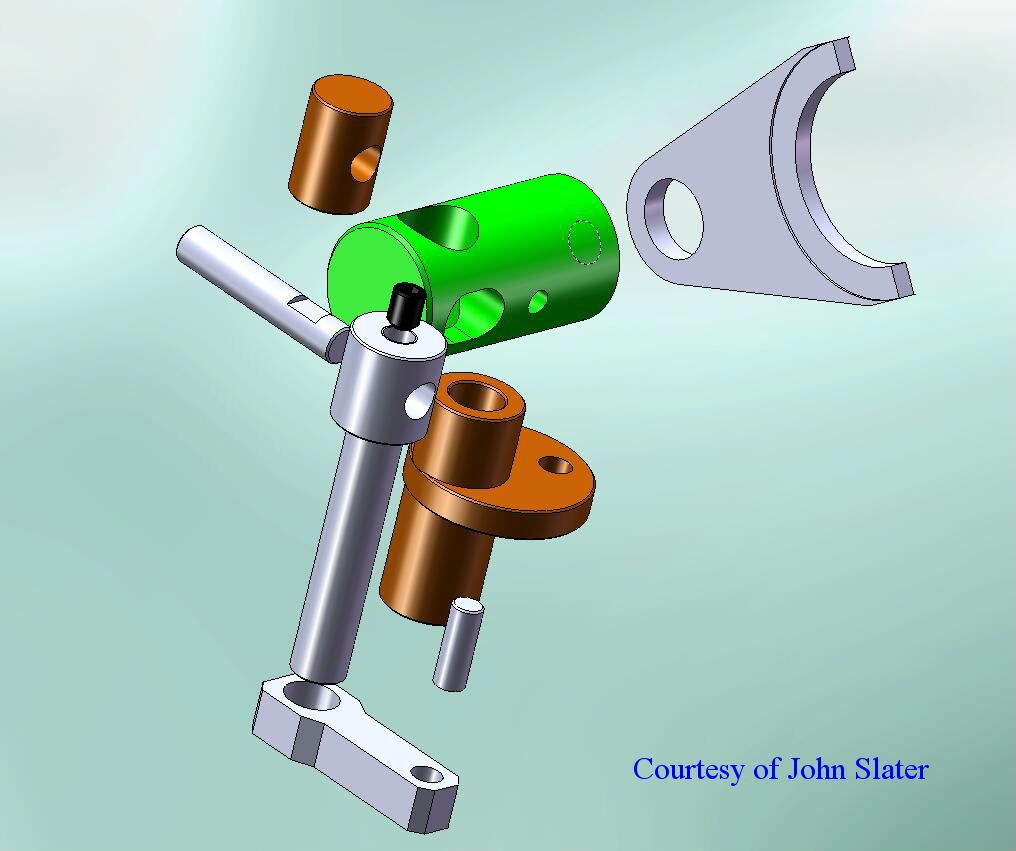

                              I had hoped to give a more blow by blow account of this project, unfortunately a bout of Shingles had other ideas. For those who have been following this post I have made significant progress despite my infirmity.
                              John (Slater) has been busy with the 3D views and his help has been most welcome, especially visualising where the parts go.

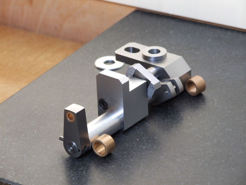

                              Hopefully tomorrow will see these parts assembled. There are still the trip rod and stops to make, but this should not take too long.
                              Regards
                              Gray.

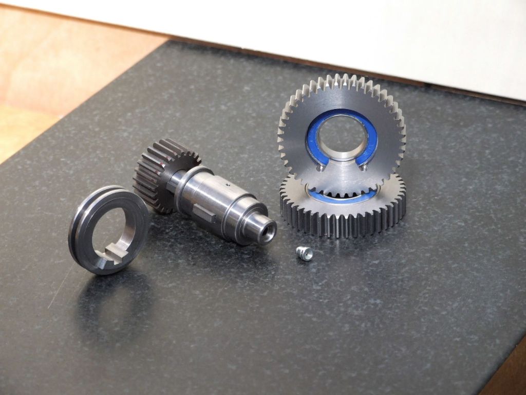

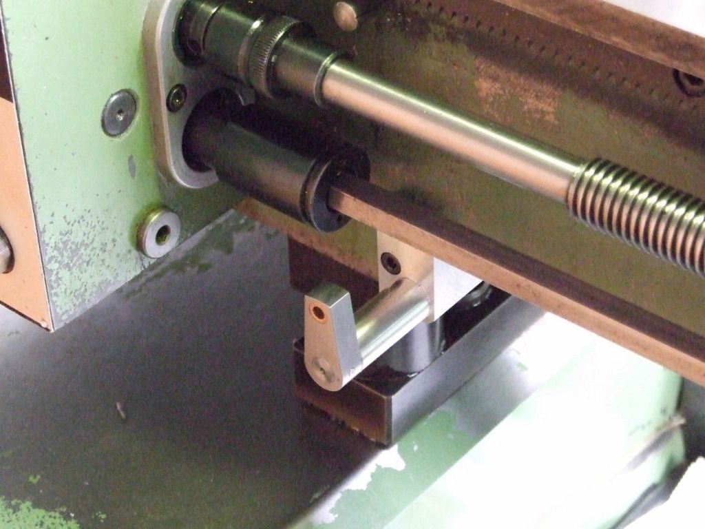

                                I forgot to add one photograph the other day showing the Dog Clutch shape.

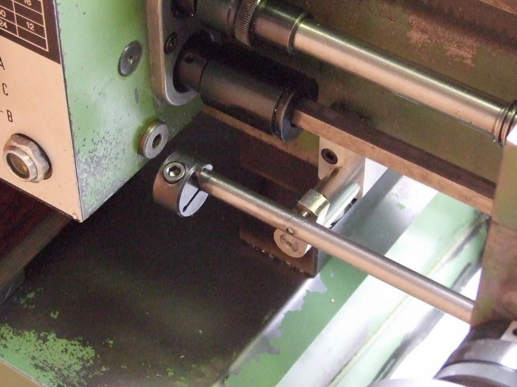

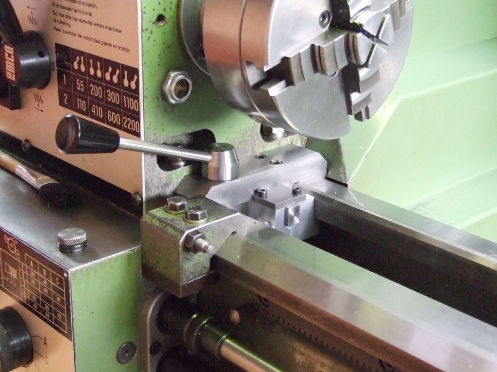

                                Over the weekend I have had a chance to fit the unit to the lathe. The Trip Rod and Trips are still to me made hopefully this week will see this project finished.
                                The unit is very quiet in operation, which did come as a surprise. I thought at the design stage that by enclosing the extra gear train in its own gearbox this might quieten things down but I was pleasantly surprised by how much. The noise is not dis-similar to that made by the Hardinge, even down to the clunk as the dog clutch engages.
                                The lower bearing was I thought going to give me a lot of trouble as regards alignment. The main bearing block sits on an unmachined portion of the bed casting. The bearing block is held in place by the headstock end hold down bolt. To overcome the roughness of the cast surface I used a 1.5 mm thick Aluminium spacer, which seems to have done the trick.

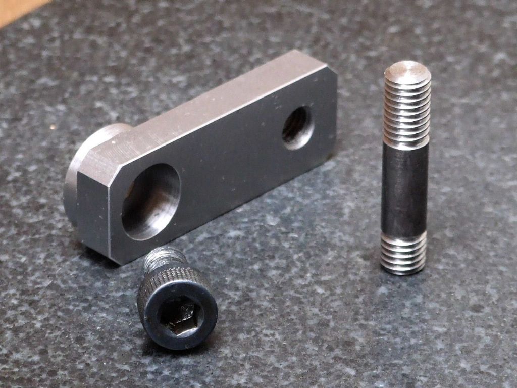

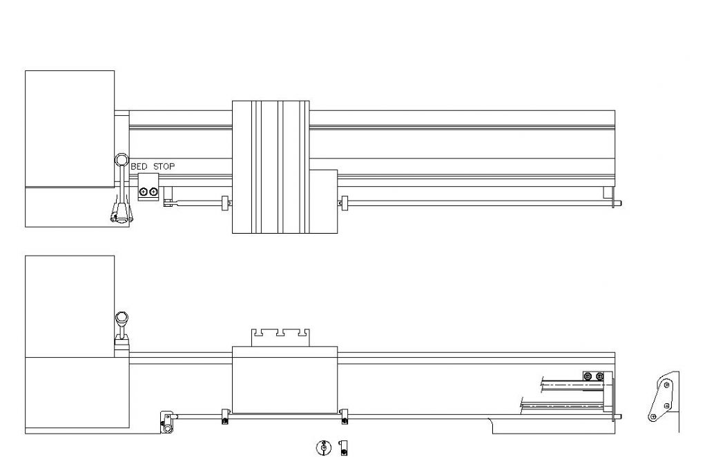

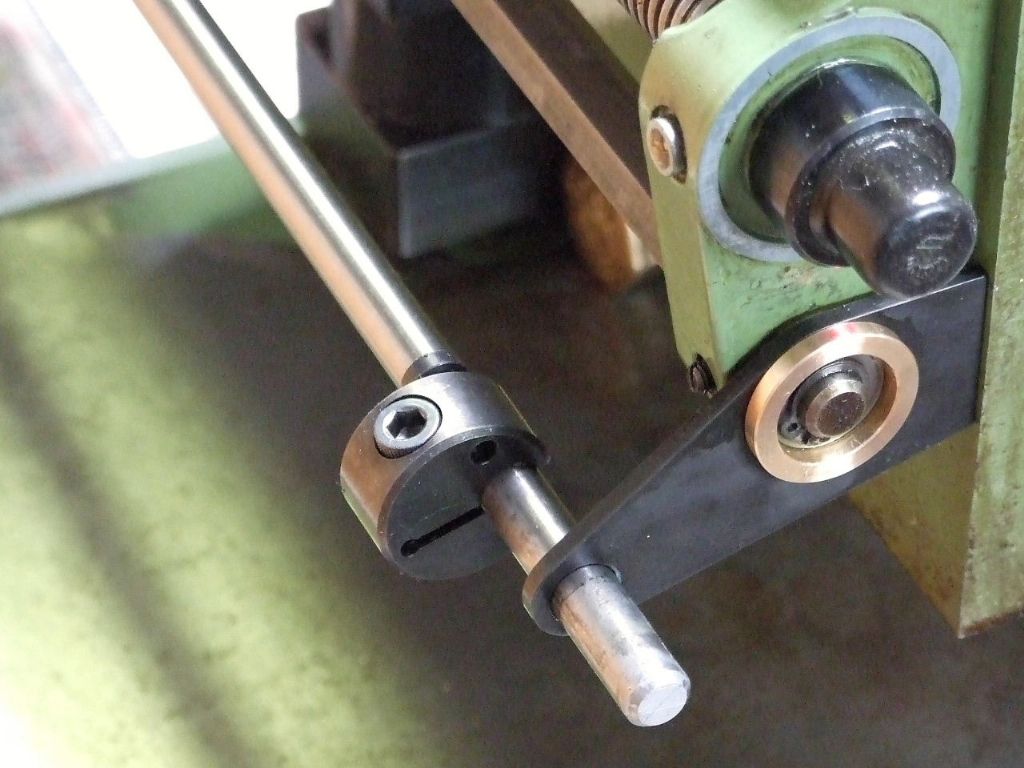

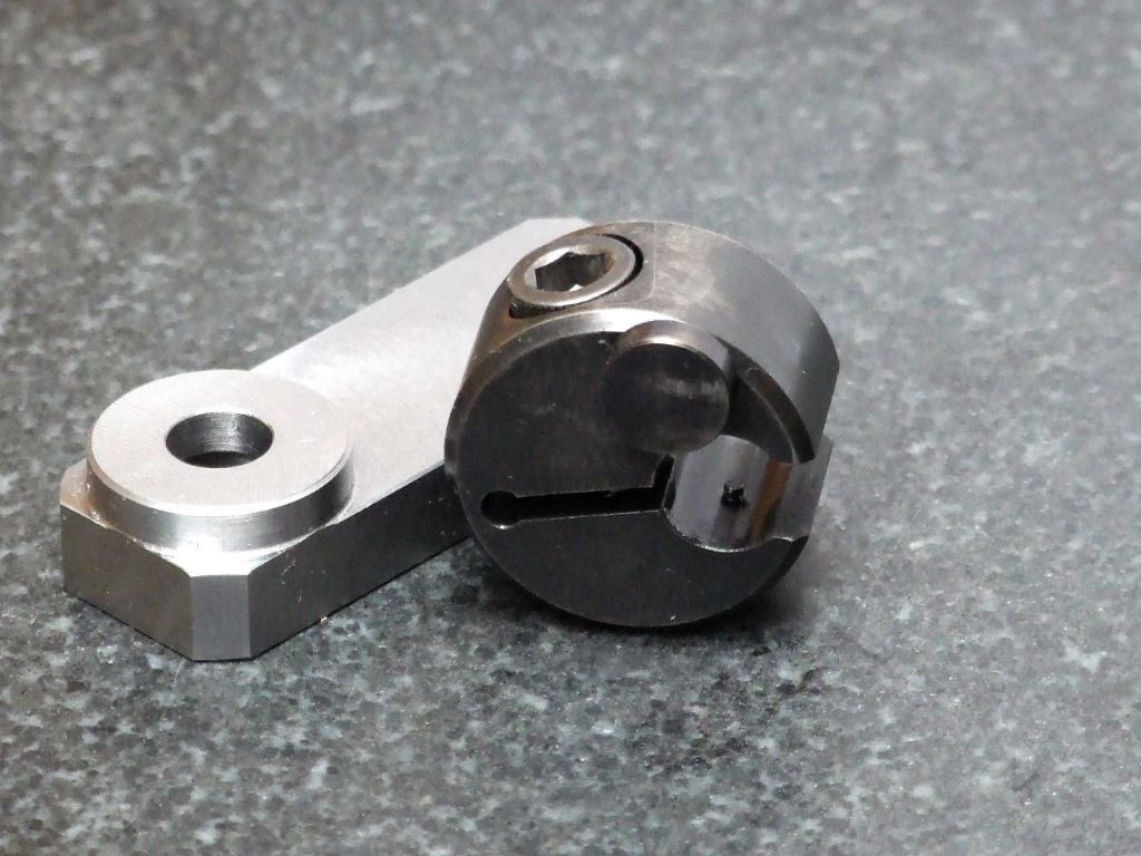

                                  This week has seen all the required parts made and fitted. The Stops may come in for a slight design change before I put pen to paper.
                                  What cannot be seen in the above photographs is the keyway running on the underside of the Trip Rod to orientate the Stop. There is nothing worse than trying to set a stop which has a mind of its own due to the eccentric nature of the design.

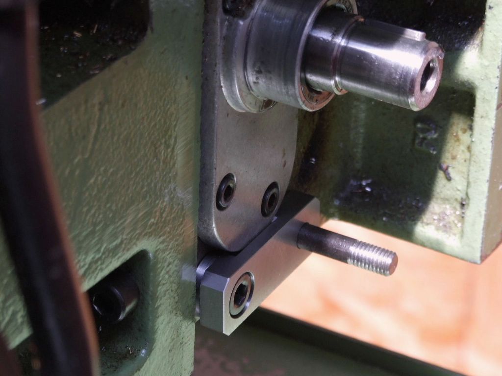

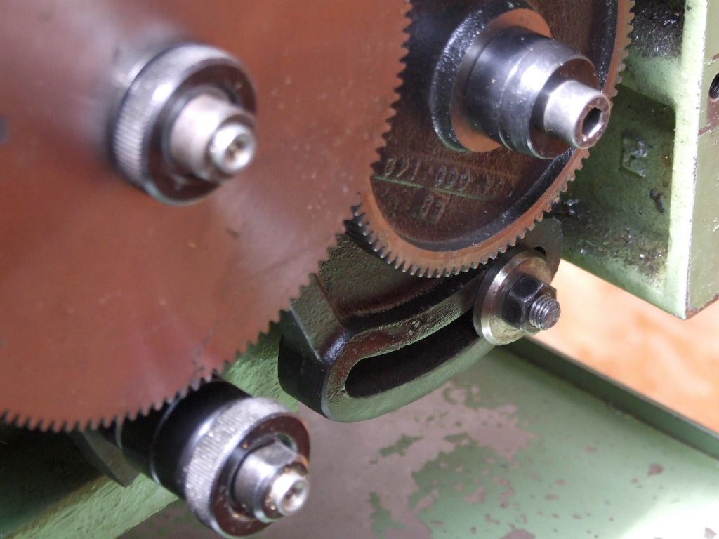

                                  The clutch was pressed into service to make a new M8 stud for the extension piece. This is required to allow the same range of adjustment as Emco originally intended.
                                  The parts in-situ,
                                  This is the original position of the stud before the extension was fitted.

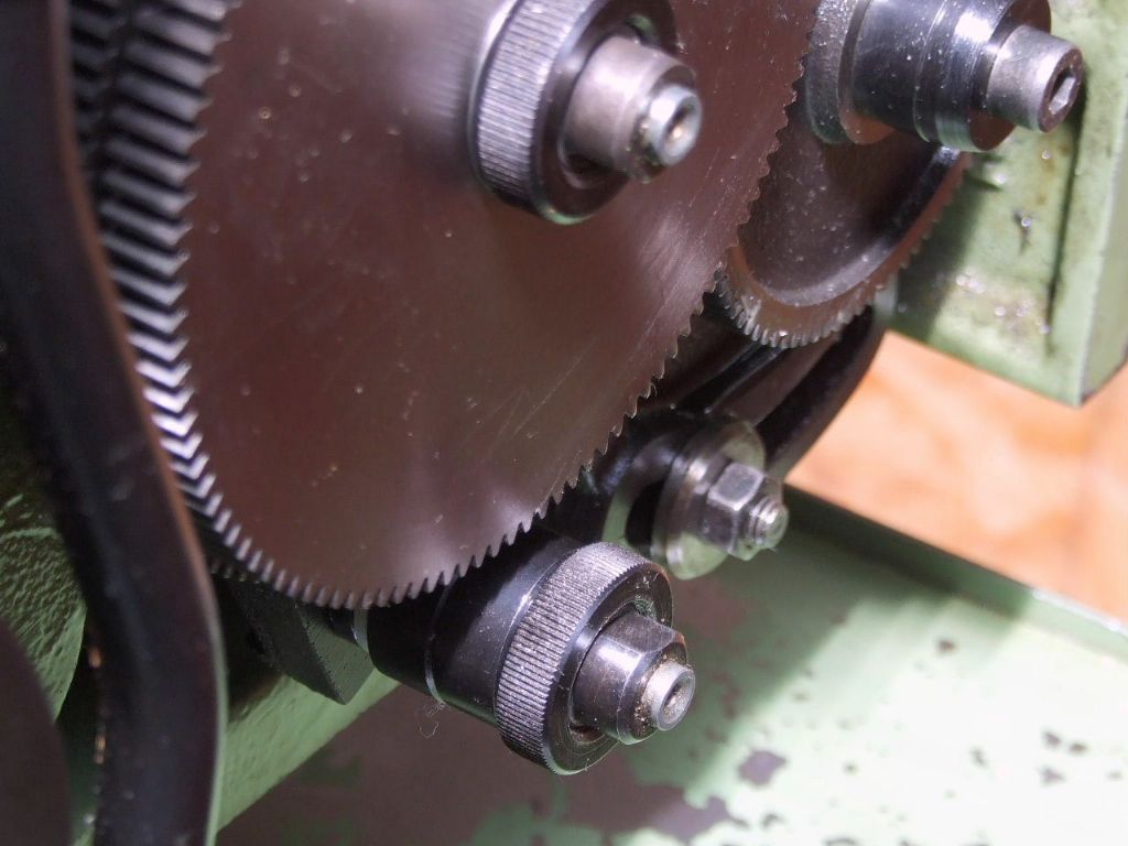

                                  And after,
                                  I hope you have liked my project on the Emco?
