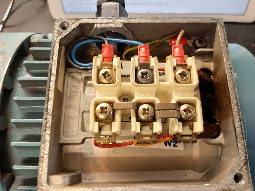

      The VFD works fine when the motor is not connected. As soon as i connect it and power on the VFD it immediately trips the fuse.
      i have checked to motor winding etc and all is fine, plus the motor was working fine before i /bought it, connected to 3 phase supply.
      looking at the wiring under the motor over, where the supply enters, it looks like its setup in a star config.
      any thoughts?

              I have aditied the first post and added Not

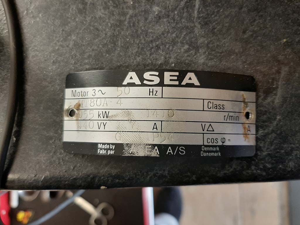

                              Well done, sorted.  Now wired in Delta config and working thanks

                                Although all cable ID's are shrouded I agree looks like connected for 400v working, remove links and fit top to bottom as pictured.

                                  To be honest a bit confused by Star vs Delta

                                    Is that motor dual voltage ? Cannot see lower voltage on the plate. Correct me if I am wrong.

                                      Just 410

                                        Oh. Check your speeds as it will only probably run at 2/3 speed on 230v and will probably stall if any load is applied.
                                        Extract from Inverter drive website. The motor must now be considered as a 230V x 29Hz motor as far as data entry into the Inverter Drive is concerned. The Full Load Current will be that stated on the nameplate for 400V.
                                        If the maximum speed is set to 50Hz or more, the Motor may possibly reach these speeds, but it will become progressively "Under-Fluxed" (Torque will reduce). However, this will only be evident if the Motor is fully loaded. If it is, the Motor will look for more current to meet the load. A correctly set Inverter will provide protection against over-Current by reducing the speed automatically to bring the load current under the maximum set.
                                        It is important to note that when the Inverter output voltage does not match the Motor rated voltage, the drive should match or exceed the Motor full load current (not kW).
                                        The link to your inverter is blocked by my malware software so could not check it out. You will need to really study your VFD settings to get much use out of that motor.

                                              Star or delta connection should not have a bearing on the fault you were getting, but I see evidence of burning to the right of the connector block. I don't think that you can safely assume that this fault is fixed.

                                                Andrew. I believe this motor is connected in Delta so lower Star currents do not apply.
                                                I just went into the workshop and connected a 400v Delta wired motor to a VFD, setup the speed, cycles etc and the results were not ideal ie :- low torque at higher speeds, high current draw & speed reduced as current increased.
                                                I personally would not want to run it like that for many minutes.

                                                  Agree with AJ. My mill is running on star connection from a 220V inverter. I had a choice of splitting the star point, if possible, and running it delta, but did not need the full power from the motor. No problems at all.
                                                  That means I also agree with PR. You have likely papered over the real fault and it may come back and bite you. It certainly appears to have been hot in the motor at some point.

                                                      I had another look under the cover and noticed the area that looked burnst was in fact oil from my oily hand, that plus the white balance was wrong
                                                      He is another photo
