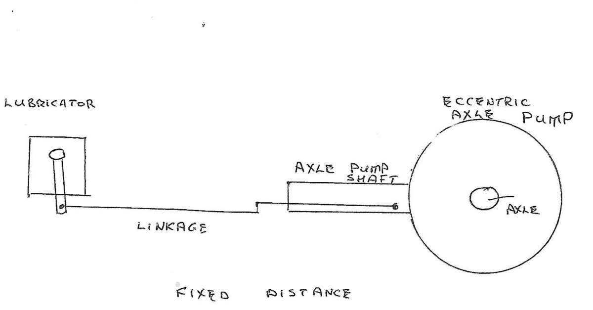

I have just replaced my ratchet driven mechanical lubricator with a lubricator with mechanical cam that rocks on the oil plunger giving the same amount of oil delivery with every rock/arc of your lubricator drive.
The length of travel of the arm on lubricator is currently insufficient

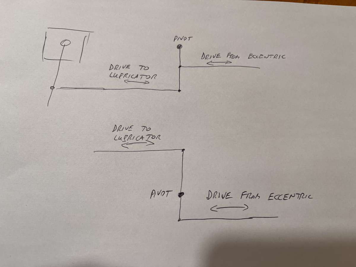

Is there a way to modify the linkage to increase the travel
The linkage is a wire rod being driven by the movement of the axle pump shaft to the lubricator arm
