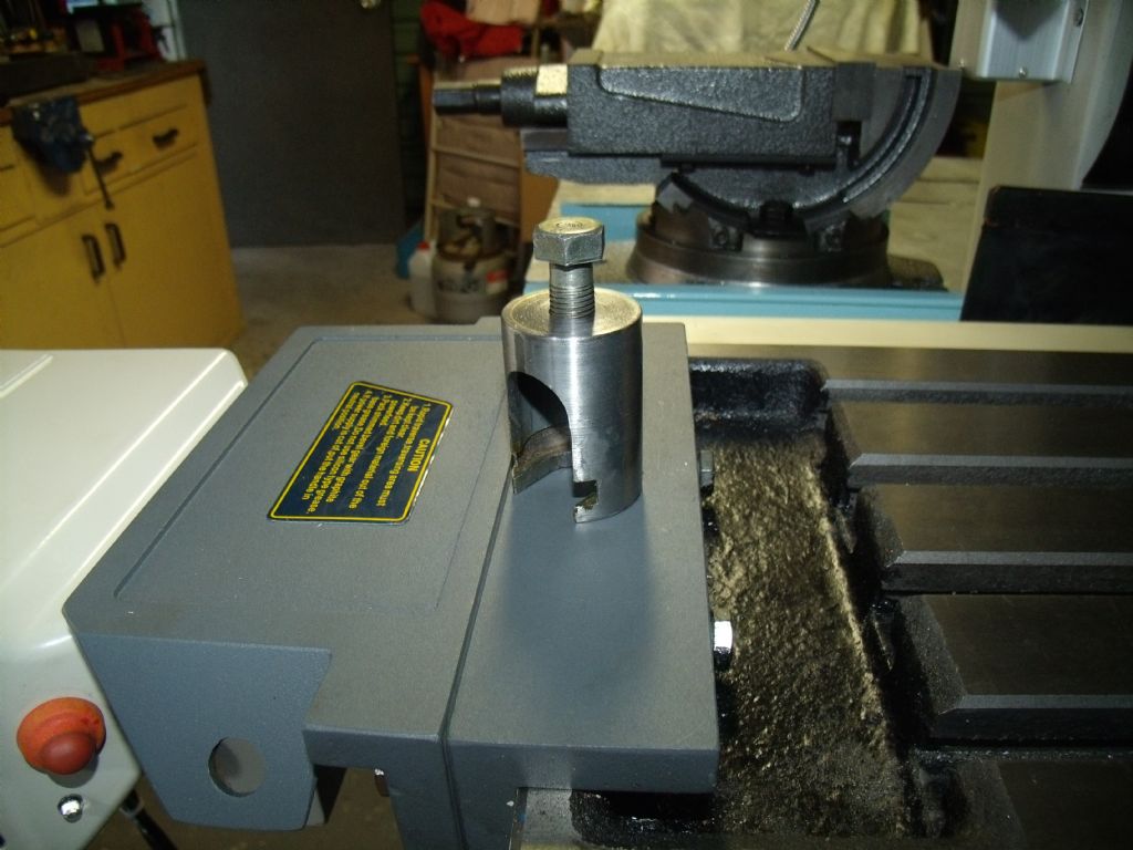

      Geoff Theasby reported on the Auckland Model & Experimental Engineers. Of interest to me, because I have one, and I loathe hitting the draw bar to release whatever is in the quill, can Geoff or Graham Quayle or someone else expand on the topic "Simple Screw Pusher to Release the Drawbar" as I would be pleased to stop my brutality.

                Here is a response from Graeme:
                Hi John,
                I am not into this forum but you may wish to respond.
                The pusher referred to is as shown in the attached photos. To use it one backs off the draw bar a couple of turns, attach the pusher to the top of the splined spindle and screw down the bolt. The bolt needs to be a large diameter fine thread one. The bolt I used was a 7/16" UNF but in reality it would be better with a finer thread. The splined spindle was taken out of the mill/drill and grooved as shown, that's the only modification to the machine. One failing of users of these morse taper mill/drills is they tighten the draw bar as though it needs to be absolutely as tight as possible. It only needs to be just a little more than finger tight so that the chuck or what ever does not spin in the taper.
                Cheers,
                Graeme.
