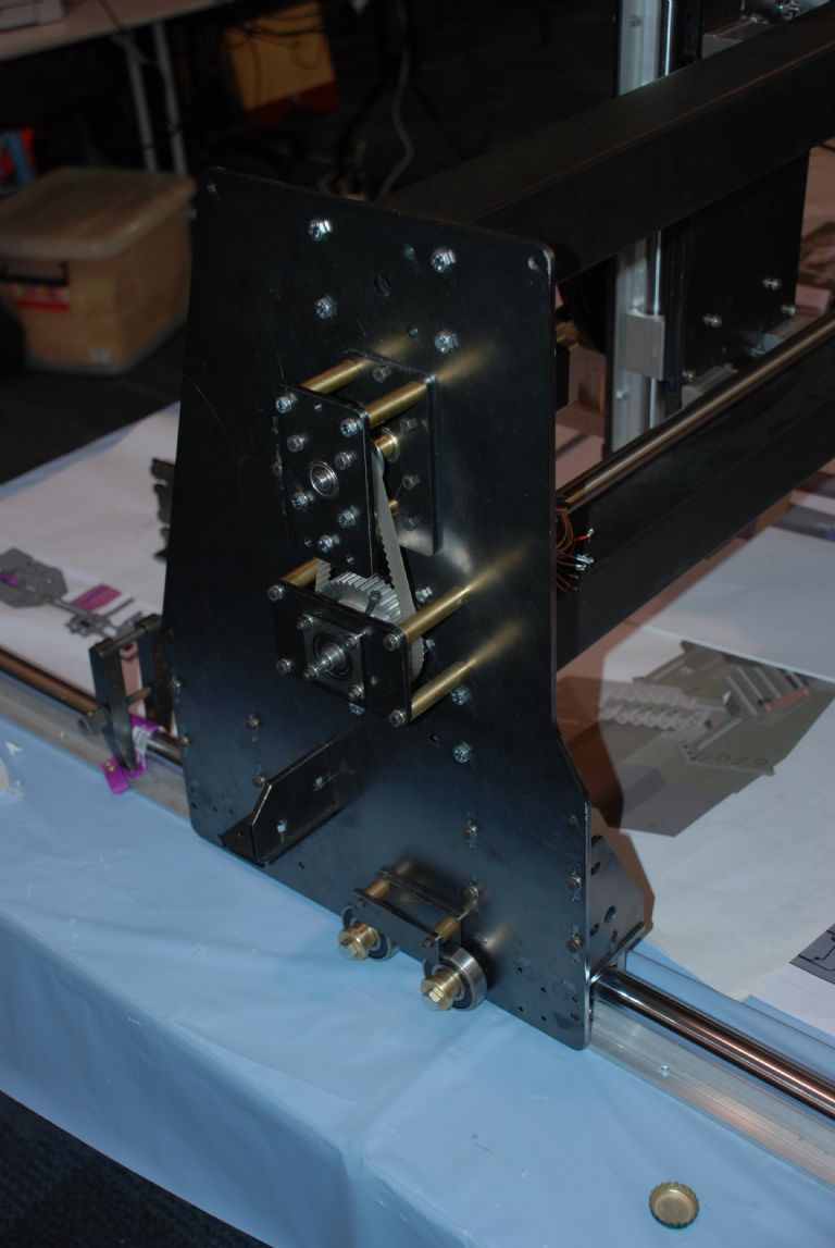

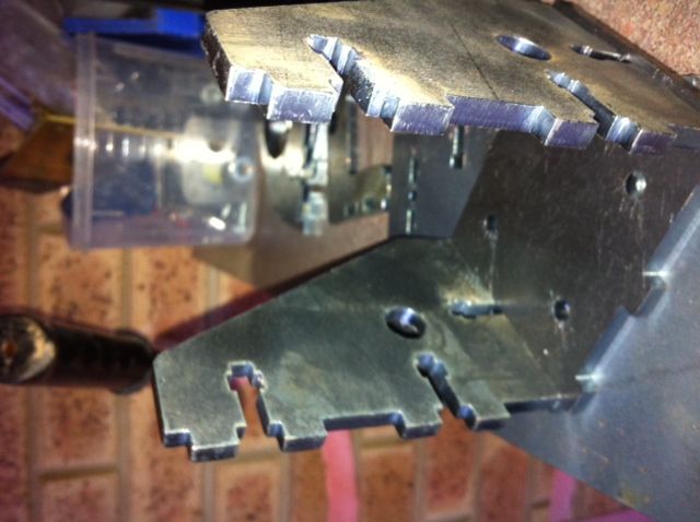

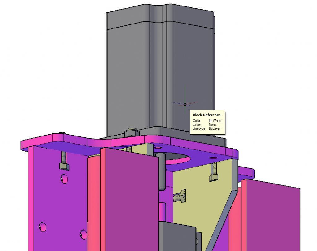

                #99548
                John McNamara
                  @johnmcnamara74883
                  Hi All
                  I would like to see other joint designs or photos of the one I am using. I have seen the mortise and tenon used with laser cut work many times for alignment as well as strength, usually as a precursor to welding. I have not seen embedded fasteners used in this way.
                  And maybe there are other joining methods that have application to our work. Any joint that removes the need to weld with the subsequent distortion it causes.
                  Cheers
                  I have added another album. images from it below
                  Actual part (Bearing support foot) from the router, In this case the nut is embedded in the plate.
                  Also two CAD views showing fastenings in place with the bolt embedded in the plate.
                  Edited By John McNamara on 27/09/2012 23:09:44

                        John – like others, congratulations on your work. First time I saw the bolt-in-t-slot construction, I thought it really interesting and a great idea.
                        I also like what I have seen of your design, so as they say "great minds think alike".
                        The "diylilcnc.org" has this type of joint (unless I'm mistaken) on their designs. I'll try and give a link to one of their pictures here. Please correct me if I am mistaken about the design.
                        Another JohnS.
                        #99560
                        John McNamara
                          @johnmcnamara74883
                          Hi John.
                          Yes and no……
                          The design does show the t slot however the two tenons are the key to my design. They offer huge lateral support removing all sheer from the threaded fastening, at the same time providing .01mm from the laser cutter (plus tolerance) location. a threaded fastener alone cannot do this.
                          Cheers
                          Edited By John McNamara on 28/09/2012 04:23:28

                                                One other quick point.
                                                On the designs I have seen the fastener design is reversed to Johns.
                                                He has a hex head set screw fitted in the slot and a nut on the top. The ones I have seen have a deeper slot and the nut is held in the slot close to the bottom of the slot and a screw fitted from the top.
                                                This makes more sense to me as it gives a choice of screws to be used, pan, posi, allen etc and neater at the top.
                                                Plus hex headed set screws are not as easy to source as say allen or pan head and plain nuts.
                                                Does the same job and if you want a locking design you can always use nyloc nuts in the slot.
                                                John S.

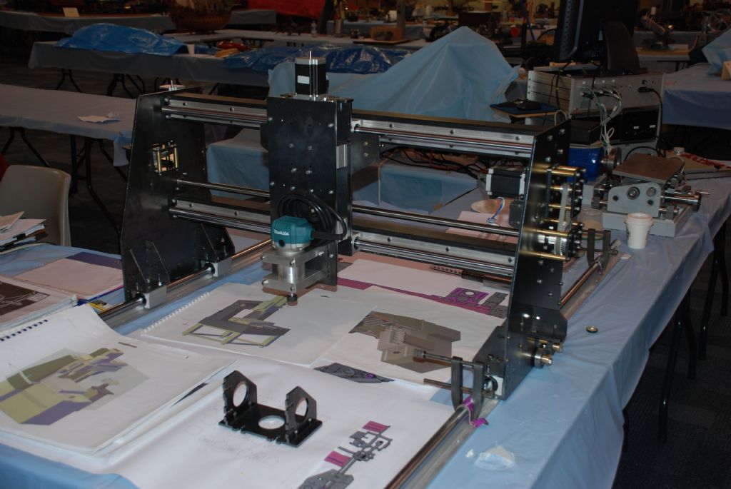

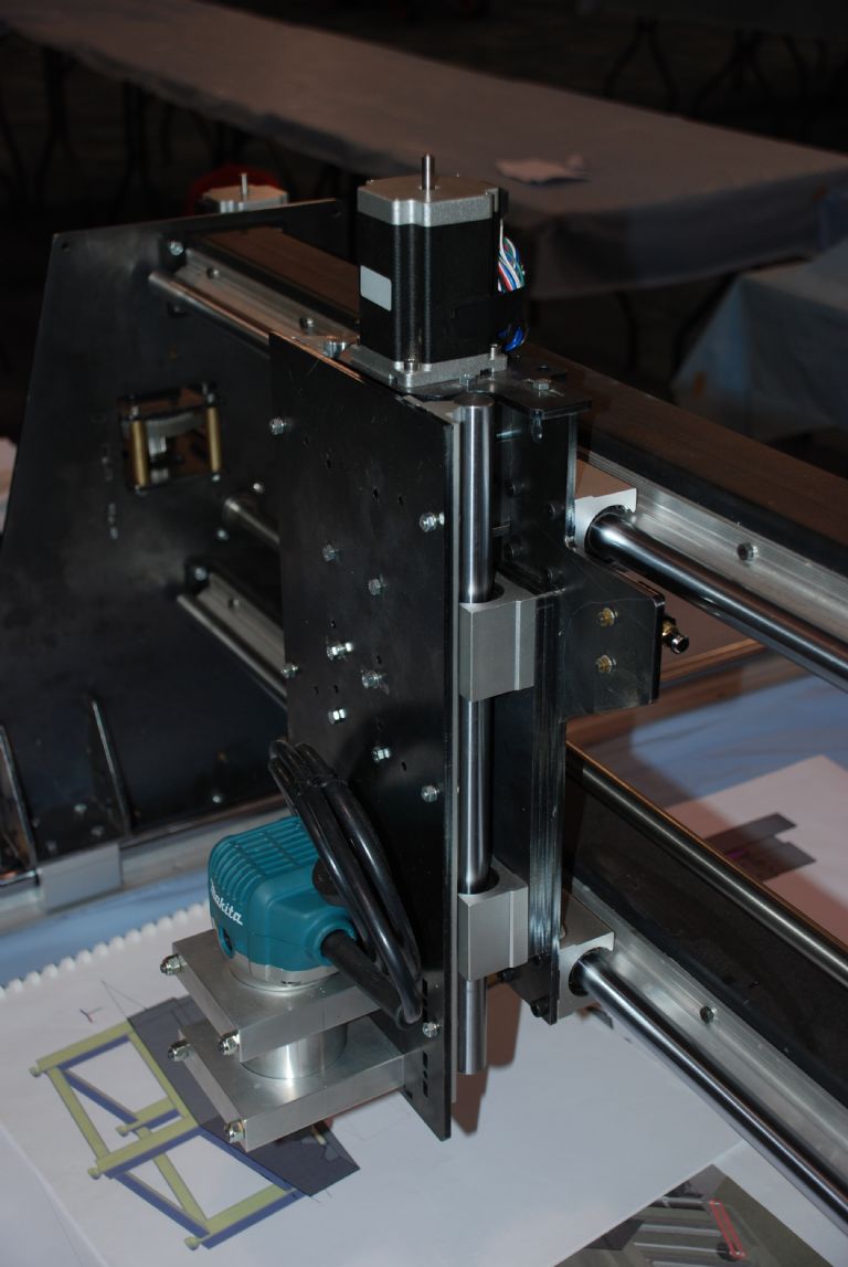

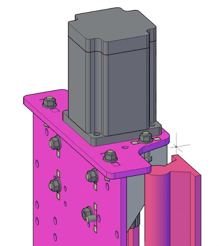

                                                John McNamara
                                                  @johnmcnamara74883
                                                  Hi ALL…. Hi John S
                                                  A pretty good day at the exhibition, the doors opened at 9:AM and it was very busy by 9:15 By 5:PM I was all talked out having had no break apart from a coffee and a sanga on the go.
                                                  Material costs?
                                                  The machine is made from 5mm steel plate. Depending on the source that costs about $160 for a 2400×1200 sheet Plus Vat (GST in Australia). Plus minimum delivery charges…..horrendous for one sheet
                                                  I have attached an image of the cutline and a rough nesting as drawn the area is about 1.5 x 1.1metres. There is also a small number of 2.5mm steel sheet parts about a quarter of a square metre. The laser cutter may re-nest the parts for a better yield. and no we did not ask for the off cuts.
                                                  I avoid providing material to laser cutters unless it is special alloy, if there is any trouble with warping it is the laser cutters responsibility if they use their sheet. (Subject to their terms, conditions and tolerances sheet). Anyway it was an excellent job well within spec.
                                                  The actual price paid was $450 Australian dollars for materials and labour. Hence my rough stab at some sort of back of the envelope pricing model. Material Plus material x 2 = labour. For light steel…. Because this thread is read from many countries, I guess actual pricing comparison is rather error prone. Hence my avoidance of actual pricing in the first instance.
                                                  Laser cutters charge in several ways… a setup charge nominally around 50 dollars if you give them a perfect file that does not need reworking, (we did provide a good file). Otherwise there is a hefty hourly rate for redrawing. On top of this is the cutting length, and in particular the number of holes pierced; the machine has to run slower. (on this job rather a lot). Yes they make a profit on the materials, they need it to pay for large increases in power and gas expenses and machines that cost more than the median house.
                                                  For more specialised work there are different gases, at somewhat extra cost. Nitrogen for instance if you want a bright edge, without the fine blue scale left by oxygen, Different gasses also can improve the quality of the edge. Worth discussing if you have a critical application. We just asked for "run of the mill".
                                                  The connection.
                                                  Depending on the location you will find you need: bolt head sitting proud on top, countersunk below the surface bolt head on top, so you can place something flat over it. and sometimes nut on top. They all work fine. High tensile bolts and nuts are a must to lessen the creep you get from common no name hardware fastenings. Good quality shake proof washers are always a good Idea and have been used throughout this project. Nylock nuts are fine although not so the cheap import type, many appear to be rather soft poor quality steel. Maybe permanent Loctite is also a good idea.
                                                  Anyway another big day tomorrow……..
                                                  Cheers
                                                  A added a couple of rough photos, Better ones tomorrow.
                                                  Edited By John McNamara on 29/09/2012 16:16:33

                                                    Well done John, it looks good
                                                    [and, nice to see someone found a Beer]
                                                    You mention permanent Loctite; so let me offer one suggestion … something we used very effectively on vibration test fixtures:
                                                    Use 638 or similar Loctite on the Mortice & Tenon joints, [don't waste it on the nuts & bolts] and you should achieve a "permanent" structure without needing to tighten the nuts & bolts too aggressively.
                                                    Although it's not stricly an adhesive; the joints you are using would respond very well, because the Loctite would be working in compression & shear … which is, of course, exactly what it's designed for.
                                                    P.S.
                                                    Obviously you would only make some areas "permanent" … but I'm sure I don't need to tell you that.
