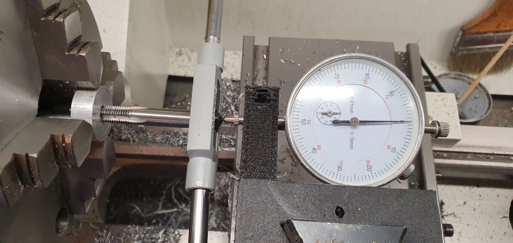

                        You panicked me there Pete, so I cut a thread using the taper tap from my RDG set (bought in April 2017) and set up the plug tap as shown in this photo. 10 turns came to 10.01mm, (+/- perhaps 0.02mm, I don't think my judgement that the wrench was level was more than 5 degrees out). It looks like you got a bad batch, but the worry is, what is in their stock now?
                        Brian

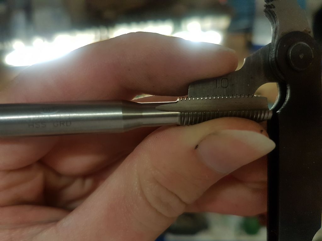

                            I bought the tap September 2018, I lost interest in sending it back but it was bizarre because all 3 taps in the set were wrong according to my pitch gauge.
                            I would be interested to look into ball screws, but the unimat is absolutely tiny, I don't think anything more than the m8 leadscrew would fit in the cross slide area
                            #429644
                            Roderick Jenkins
                              @roderickjenkins93242
                              Looks like they could actually be 5/16 x 24 (UNF).
                              Rod

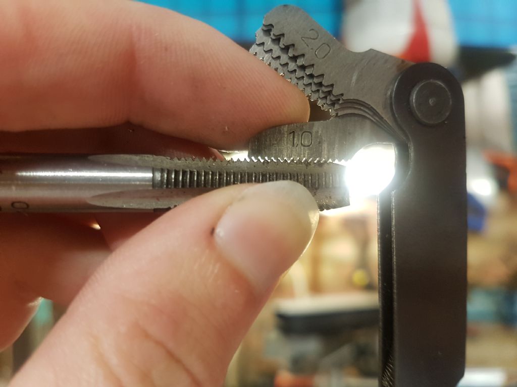

                                  Below is the one I have just received from RotaGrip.
                                  And here is the RGD one!
                                  #429658
                                    Good to see my suggestion of Rotagrip worked out, is it a brand name one or just one of their imported ones which I have found fine for threads you are not going to use much, I've a few fine pitch metric ones for them that crop up on gas fittings.
                                    Definately something wrong with that RDG one.
