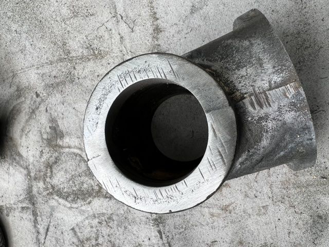

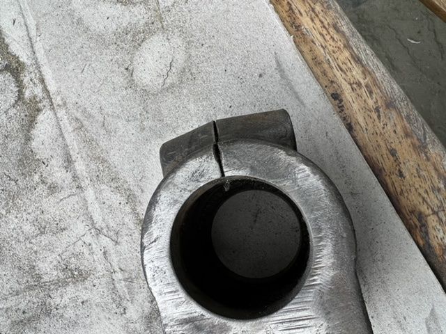

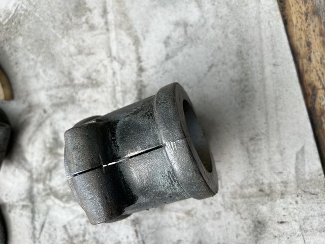

          d8e2d351-861b-4cc3-b3b9-b85b24e9ac73.jpegJust as an aside i have had a few Fobcos with a not fully cut slot on the clamp type of tables
          the slot ends about 15mm from one end i have always cut them fully and this makes them much easier to clamp tight
          though fobco must have had a reason for not fully cutting the7e2c84a5-bd63-48c8-91e9-def758d7d2a3.jpeg slot

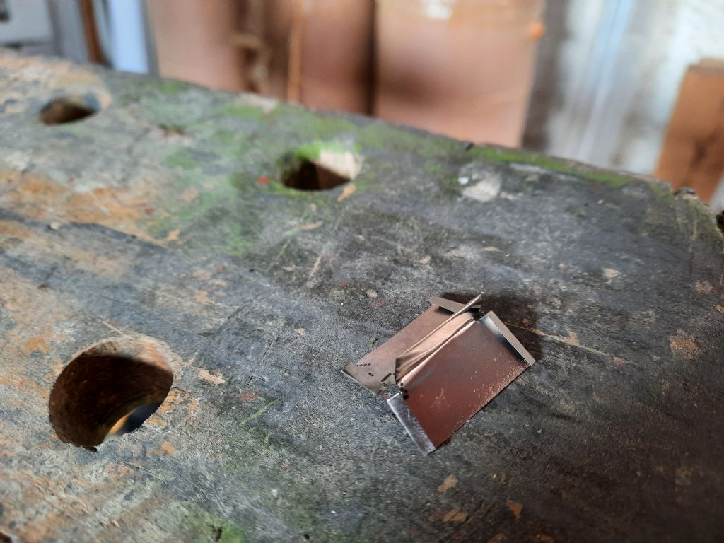

              I thought I'd post an update of where I'm at with the table. I've made a shim to fit around the top portion of the clamp assembly (it doesn't run all through to the bottom hole but just the top hole). It is placed at the rear of the clamp, so a fold in the shim sits within the gap (this prevents it moving under rotation of the table). I've put some JD weld on the shim where the fold is to stiffen it and help to stop any bending when rotating the table (however I don't feel this was necessary). The shim has been bent over at the top and bottom into a "n" shape whereby additional JD weld has been put within the bends to provide additional support (this was found to be essential). I tried simply bending the shim over 90 degrees and it worked to some extent but I found the 90 degree bend would lose its form if the table was moved whilst under slight clamping pressure….The current setup seems to work well.
              I've attached a picture below for reference
              This is a spare shim I made
              Just as a side note, and this probably is a slightly daft question but seen as the shim is stainless steel and the column now pushes against the front of the clamp assembly, is this going to cause additional wear to the front of the clamp over time when slid up and down the column? Or would this be negligible? I'm guessing in its original life the wear would have been even around the whole of the clamping hole but now a stainless shim is at the back I am just concerned this will wear the table clamp out quicker!
              Many thanks
              Luke

                    It will wear faster, most likely where the shim rubs, but I'd expect the wear to be insignificant unless you're into loads of drilling and table movement. Just keep an eye on it, and if the stainless starts to cause damage, try replacing it with a softer metal like Aluminium, or Brass Shim. A spot of oil on the stainless would help keep it sliding rather than scraping or galling.
                    Good fix, far safer than over-stressing the clamp.
