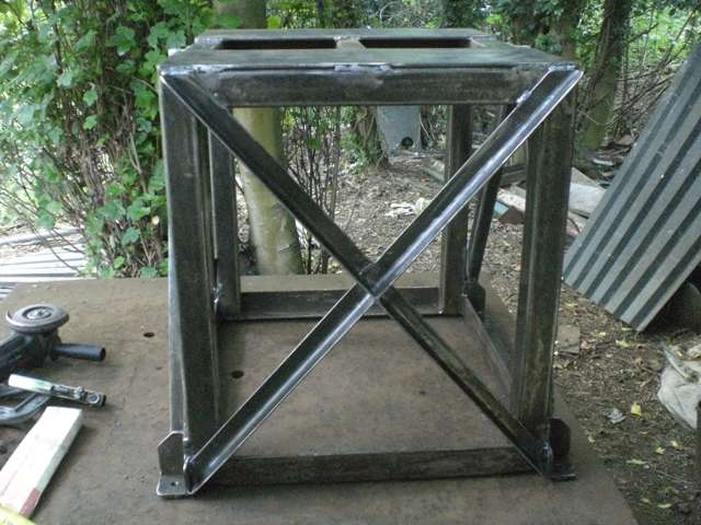

                          Nicholas Farr
                            @nicholasfarr14254
                            Hi, I don’t know of any books, but as far as angle iron flat bar and box sections, taking flat bar first, it will be reasonable easy to bend on the thickness, than on the width, angle iron will bend fairly easy if a load is put on the closed side of the angle, with the open side being restrained at each end, but a little less so the other way round, its strength is by the legs widths, but has less resistance to twisting. Box section has the best resistance from all directions. Providing they all have the same cross section, their strength should be much the same overall, but not always in the same applications. When I first started working, the chap I was under, used to say to me, “If you err at all, err on the strong side” that might be fine, but it can also work against you in some situations. Unless you are building something big and heavy that needs to carry a heavy or impact load, I don’t think you need to worry to much about it, just keep in mind that deeper sections will carry more load. Of course, flat bar, angle iron and box sections and channel iron, can be worked together in the same fabrication. I made mill Major milling machine stand, mostly from scrap material, it’s probably OTT as far as strength goes, but it’s very ridged, and holds the 300kg weight without any problems, and the only calculations I made were the measurements.
